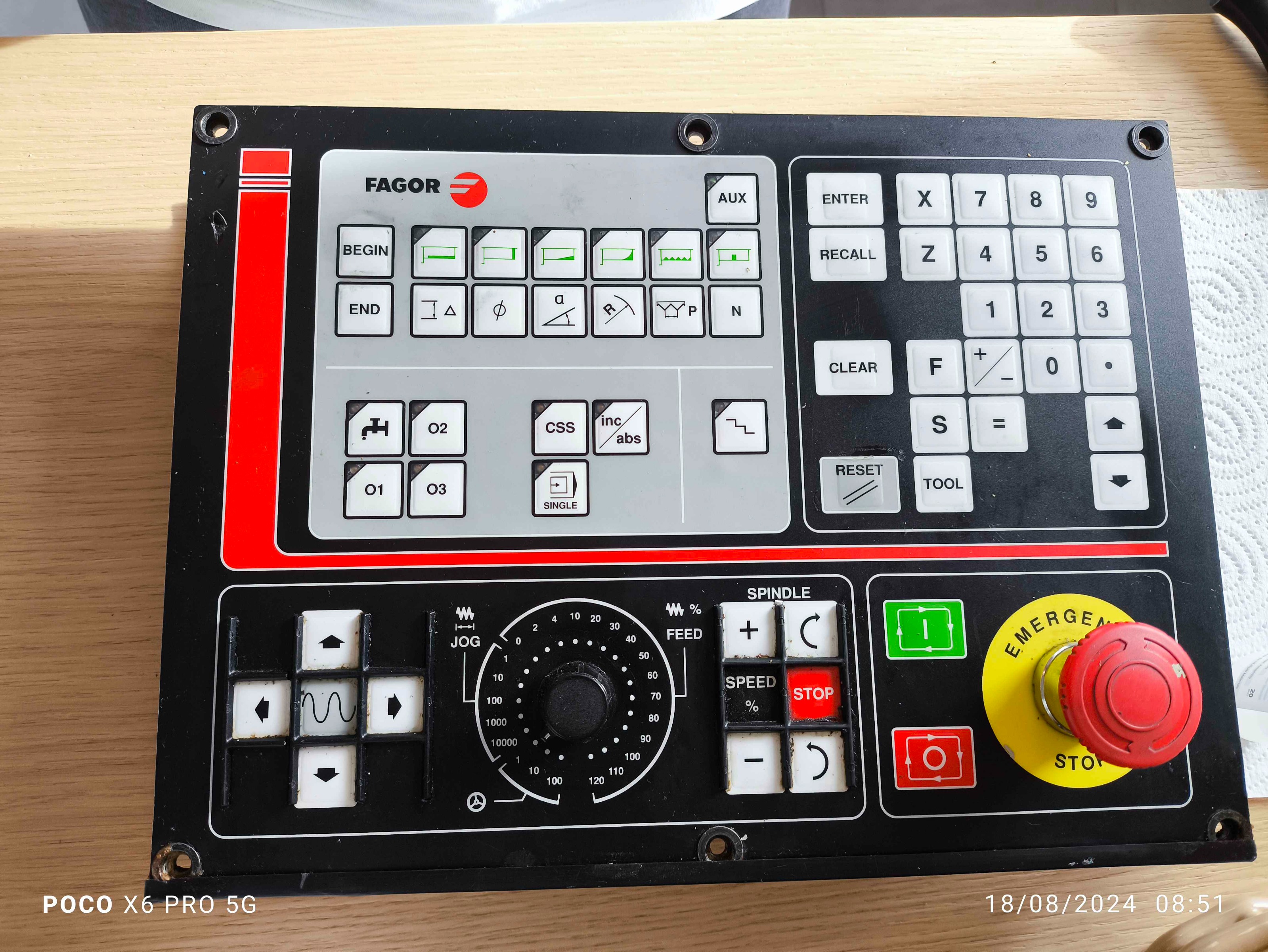

 Hello,
First, thank you for the awesome work :)
I retrofiter a lathe and kept the original panel/keyboard.
This was a conversational lathe so I have keys for lathe operations such as facing etc.
I use the arduino-connector project so I'm able to define the key as an input in hal or as a keystroke or a text.
Do you think it's possible to bound a key with a macro in the cycle tab directly with one of the 3 options above?
https://media.discordapp.net/attachments/970073318810075149/1280467345164468286/IMG_20240818_085127.jpg?ex=66e40d25&is=66e2bba5&hm=6ccd4d7b9c719ef5497b92814fa29b2ab450d865d01bd02bf1aa06a6b54bb721&=&format=webp&width=900&height=676

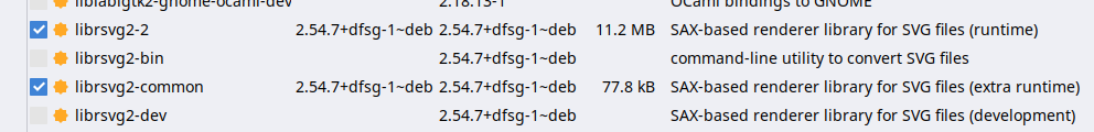

I am just testing this to see how it does but cannot get it to work on 2.10.0
I get this error although Rsvg is installed.
I am on Bookworm
  File "/usr/bin/gladevcp", line 379, in <module>
    main()
  File "/usr/bin/gladevcp", line 259, in main
    handlers, mod, obj = load_handlers(opts.usermod,halcomp,builder,opts.useropts)
  File "/usr/bin/gladevcp", line 126, in load_handlers
    mod = __import__(basename)
  File "/home/plasma/linuxcnc/configs/sim.gmoccapy.lathe_configs/lathehandler.py", line 33, in <module>
    gi.require_version('Rsvg', '2.0')
  File "/usr/lib/python3/dist-packages/gi/__init__.py", line 126, in require_version
    raise ValueError('Namespace %s not available' % namespace)
ValueError: Namespace Rsvg not available

04 Nov 2024 15:26 #313760 by Aciera
Replied by Aciera on topic Lathe Macros
Try
sudo apt-get install gir1.2-rsvg-2.0
The following user(s) said Thank You: mariusl
04 Nov 2024 16:59 #313763 by mariusl
Replied by mariusl on topic Lathe Macros
Thanks that did the trick.
