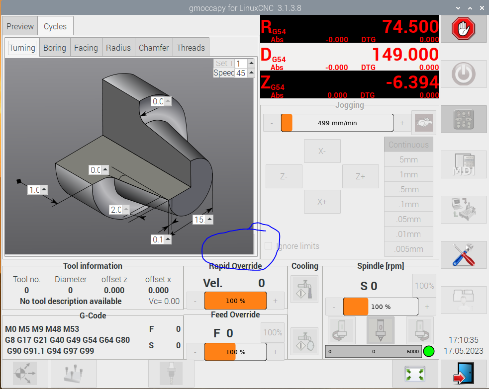

Just to let you know, I'm having exactly the same problem, you are not alone. Button doesn't show.
I'm pretty sure the button is under the image, take a look at this screenshot
I didn't want to dive ni glade and other things, but since i'm at it, I will reread the late pages of this post and try to find why the button is so timid.
LinuxCNC 2.8, raspbery pi 4, whatever debian is in the downlodoable image for LinuxCNC 2.8 for pi.

Second data entry: Replacing lathemacro.ui with the one in the example shows the button. Of course, other things break.
If I'm remembering rigth, I downloaded the last available verision for LinuxCNC 2.8, just copied to the config dir, and everithing minus the play button worked. I can not find now the page or the link I downloaded
Must compare lathemacro.ui from the example and the one downloaded, an see what are the relevant diferences. For starters, they are very diferent sizes.

This version of the interface uses a sparsely-populated transparent table to position the number boxes. The two files contain different numbers of pointlesslines. If you delete all of those the file shrinks to 132k.
However, the Glade editor will tend to put them back in again.

Looking in detail at the XML I think that I can see the difference:
In the working version the button is inside an eventbox, in the non-working version it is not.
NOT WORKING

WORKING

</child>In the working version the button is inside an eventbox, in the non-working version it is not.
18 May 2023 10:49 #271603
Replied by andypugh on topic Lathe Macros
I couldn't resist trying to fix this. Here is a new version of lathemacro.ui that appears to work for me.
The following user(s) said Thank You: tommylight, Clive S, Baldorcete

Done. Results the only thing wrong with example file was not in the file, was the next problem to solve. Just needed to move the .ngc files to the right place.
