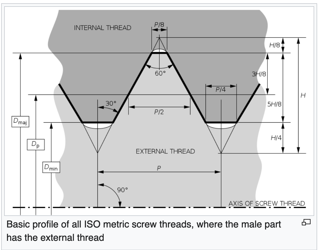

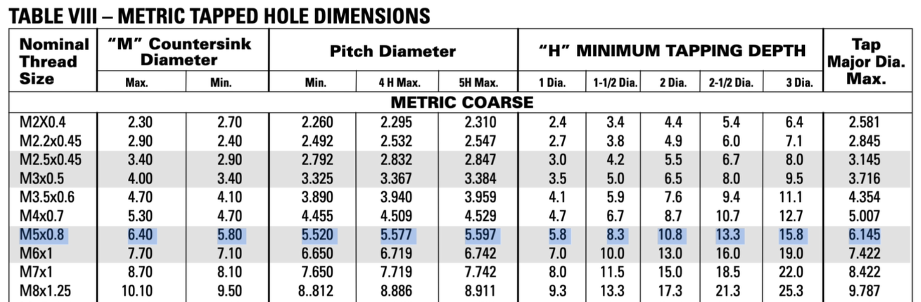

I see that the threading page only has inputs for pitch and OD. Does this mean that it does all the calculations for metric and unified threads automatically? I just cut a test M5x0.8STI (the Helicoil tap for M5), which has these dimensions:
Setting 6.145mm OD in your macro, it first did a turning pass at about 6.05mm, before turning the thread. Does that mean you are expecting the nominal diameter to be given, and are turning off the H/8 thread tip on that pass?
Since the Heilcoil manual gives a dimension for the taps major diameter, rather than a nominal diameter, do you think I should be inputting 6.145 + (6.145-6.05) = 6.24mm into the lathe macro as my nominal diameter, so that macro can remove the H/8 again?
Yes. It's a bit out for Whitworth or BA because of that.
Note that the number entry box will let you type (for example) 11 then tpi-pitch then in-mm to program an 11tpi thread.
Yes, exactly that.

Okay, for 0.8mm pitch, I'll need to add 2x H/8 to the Dmaj, to get the nominal which your macro starts with. So my DMaj of 6.145mm will be Nominal of 6.284mm given a tool with no radius.
