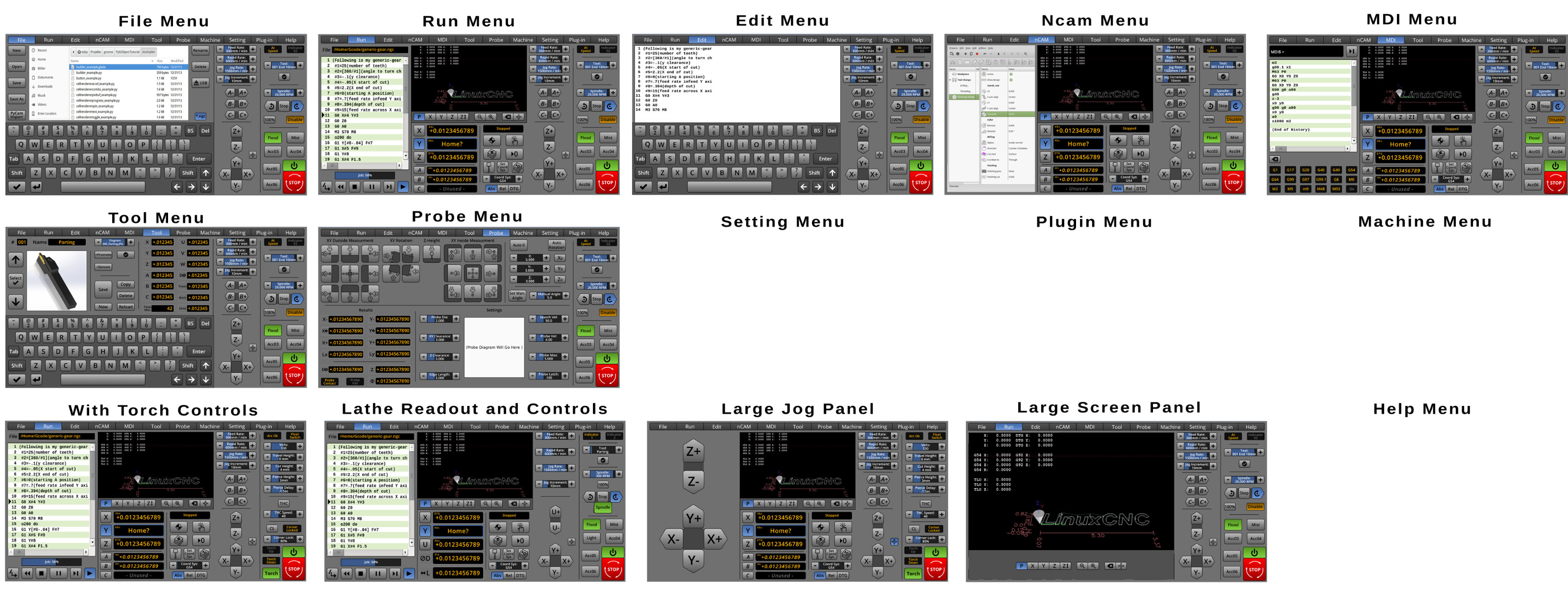

This is a progress report:
Most of the menus are laid out. There are machine controls for Torches and Mills, as well. There are overlay panels for Large Screen, Keyboard, and Large jog.
What's left to design: 2 menus and a few tweaks.
* Setting Menu: Next on the list for most user settings, such as increments, paths, and choosing a plugin. This menu will only be a rough guide as the programmer(s) will be able to include often-used settings here.
* Machine Menu, may have controls for HAL-related things, as Halscope and Halmeter.
* Plug-In, not much to do, this menu will only display whatever the plug-in will do with either 1/3 or 2/3 of the screen, not much to do.
* Help Menu, there not much to do as it will just display a help file.
Some tweaks:
* Remove PyCAM button. Too much will have to be done to Pycam for integration in this version, perhaps the next.
* Add copy/cut and paste buttons, and a few User buttons on MDI. There's room for them, might as well.
* Check Probe and Tool Menu.
Notes:
* For something like NCam, it could either 1/3 or 2/3 or, most of the screen--except the machine-specific controls on the right. The probe menu is also large, and the largest the design supports.
I've read a lot of your feedback, and am trying my best to do the best I can for LinuxCNC. Thank you to Lcvette for making the great looking lathe tool. Thank you for your patience, help, feedback, and support.
(For those with large monitors, the thumbnail image is in 4K. The interface itself was designed for 1920x1080 widescreen, and above.)
