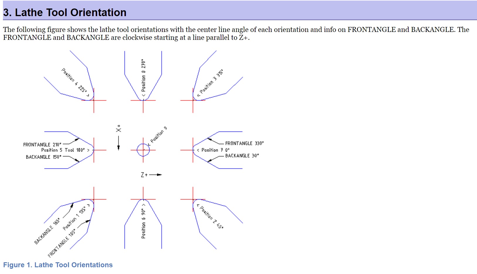

Brenda have you read the manual? or used linuxcnc for a lathe? if you have then please tell me where im going wrong because im interpereting this diagram to mean that tools located in a certain position will have that position designation so that their front and back angle numbers can be used properly and the machine knows the location of the tool in relation to the machine axis lines. it is not a tool changer position. it is the Q value.

There is already a variable for Orientation on the menu, as they was in Axis's tool table. The manual page you posted speaks about orientation of the bit, it further describes possible positions within the context of orientation.
In other words, in your discussion, it appears that you have put the carriage before the horse, the object before the class.
It appears that you wrote of position, when even the manual refers to it as orientation.
Yes, of course there should be some representation of tool Orientation.
I will reiterate that there will not likely be enough programmer to create a new menu for every tool. So, I still think the best option is to have a single picture for each tool type that depicts everything they need to know how to enter it in the tool table--all in one drawing.

the number value is the value regardless of what you call it, and I asked the question of whether it was position 6 or 2 according to the manual. and it of course was a first and incomplete posting of the tool image representation. there are more offset parameters that can be added still for X and Z offset dimensions that i did not add because i wanted clarification on position first. perhaps I should have included the manual image that was my fault but it certainly did not warrant your response and unless you plan on revising your goals I am still done helping you make a router only gui which is the most ridiculous thing Ive heard of in my life.
