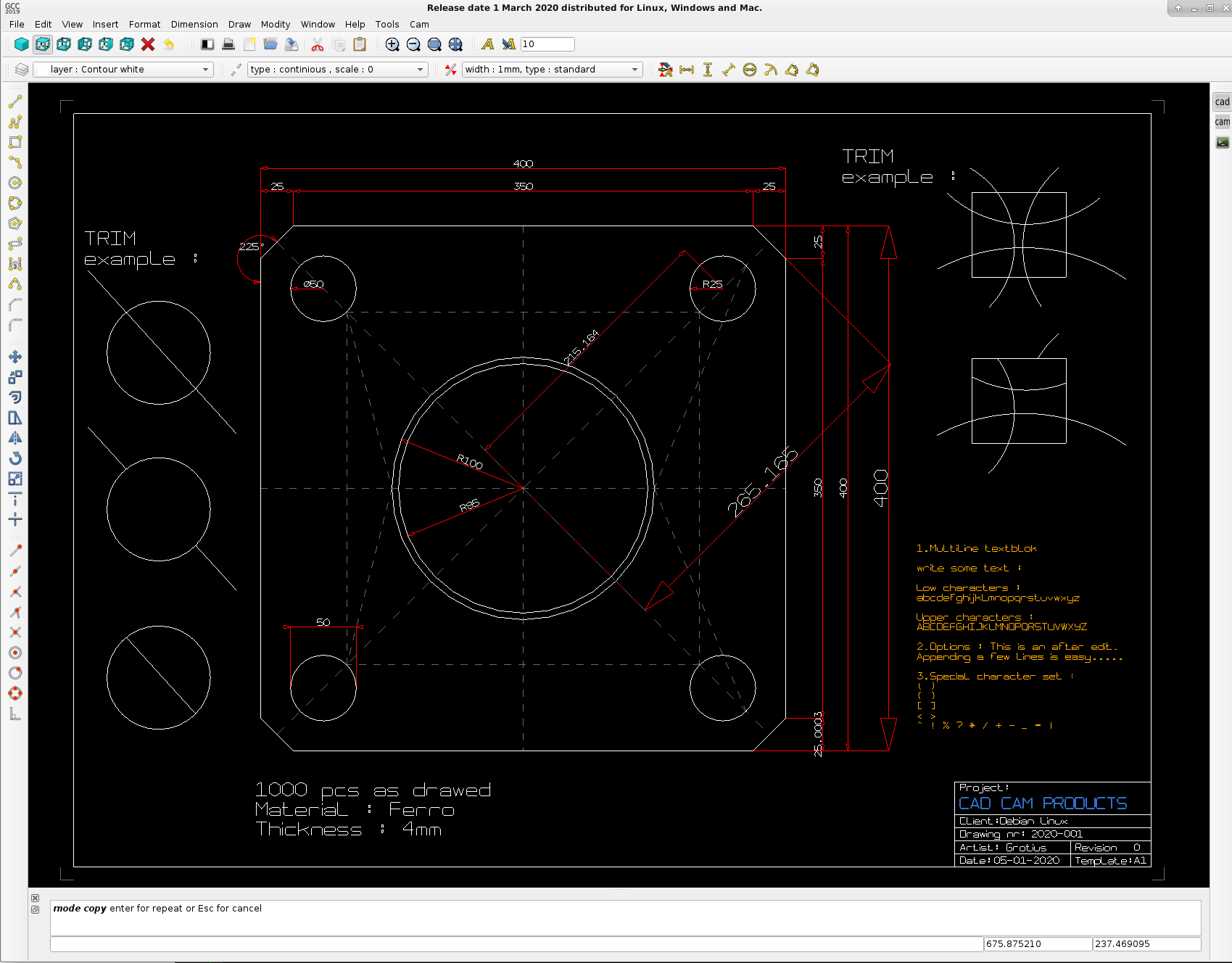

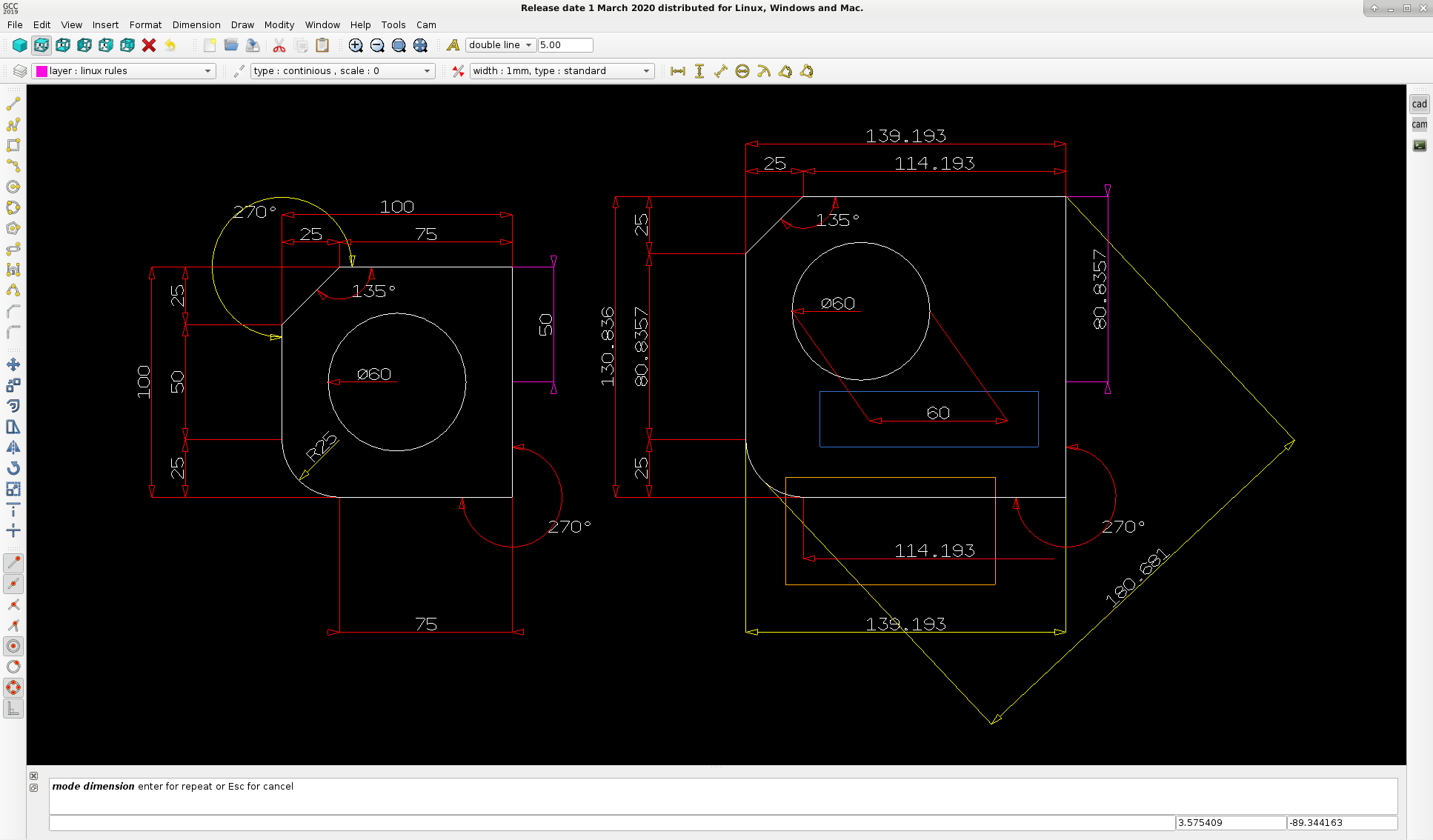

Hi Clive,
Good question..
The dimension line will follow the mouse pointer for final position. When a product is stretched, the dimension value will update.
The right object is a stretched left object. It is copied including dimension lines etc.
Also the dimension line position can be stretched where you want to.
The dimension class is constructed as a non block. For editing the dimension line, therefore it does not have to be exploded.
See the picture of possible senario's with the dimension style class.
For coding the dimension style, you need a little experience. the angled dimension line and the corner angle are quite complex coding techniques. Also i made a text font's to display characters. This also includes the dimension style class.
In the blue area i did something strange, i stretched the dimension line itself. The clicked position's of the dimension line stay on the product x,y position, wich is nice.
In the orange area i removed some of the dimension content. So you can edit the arrow's, lines etc.
Later on, releases after march 2020, we can expand the dimension line class with extra option's. We will see about that.

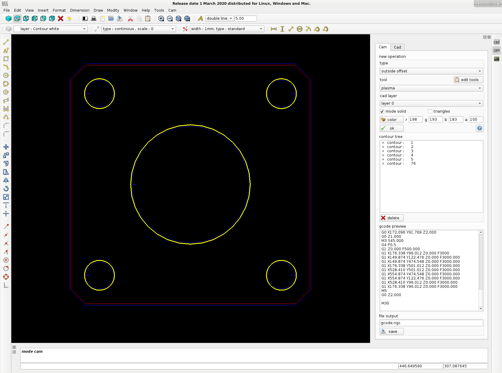

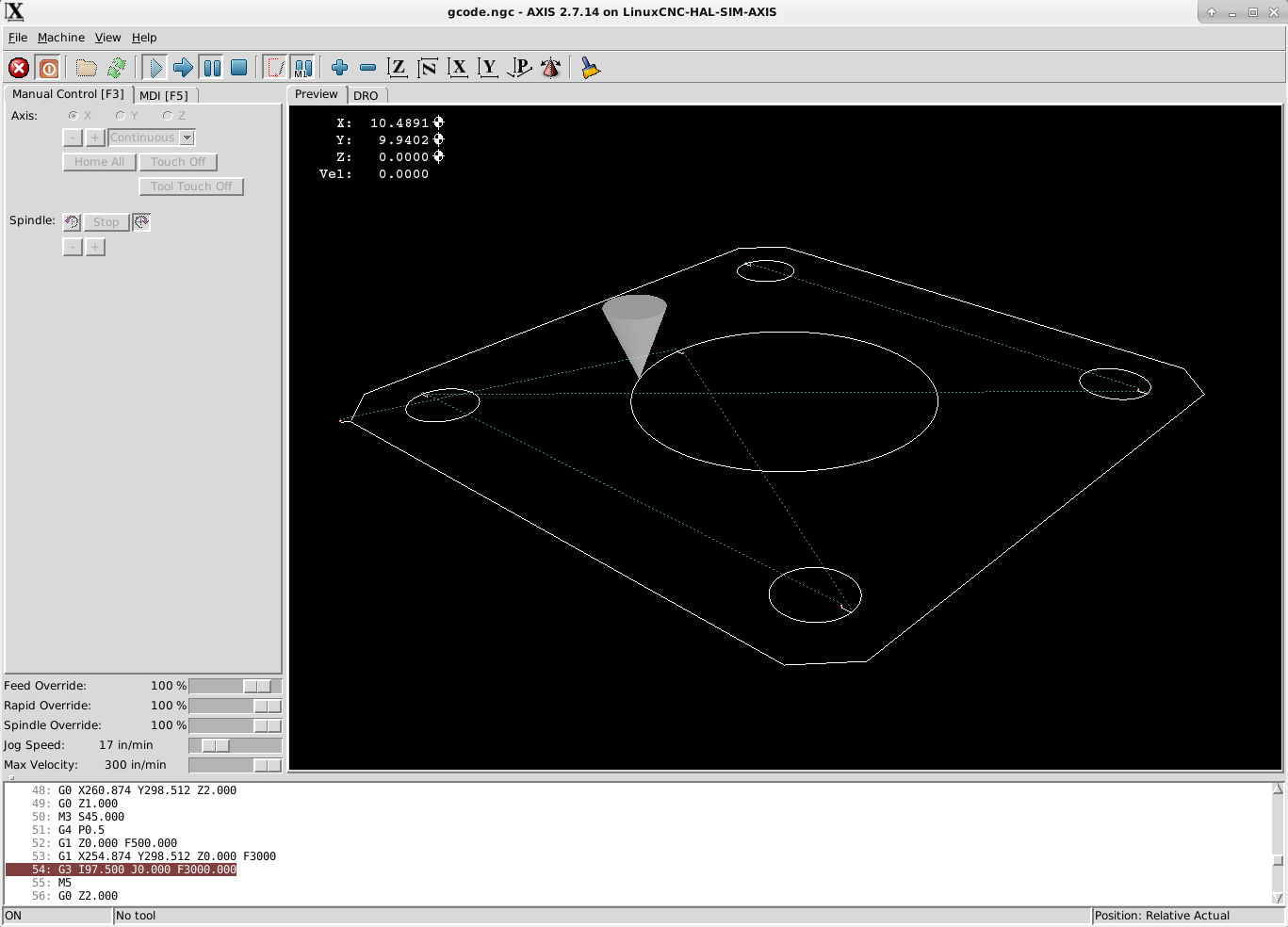

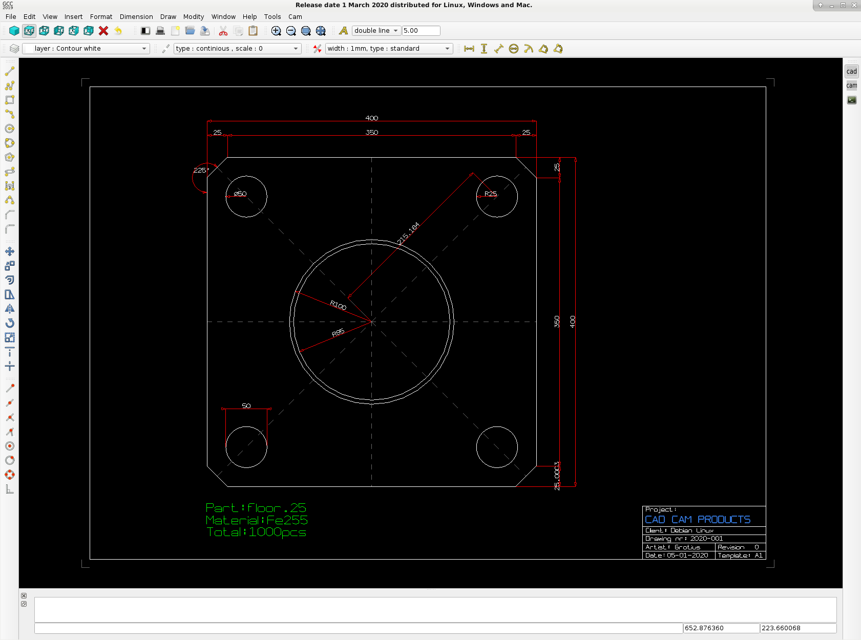

Hi, a little project update.
The text class is almost finished. Have to do the text edit function.
Cad Drawing :
Cam output :
Linuxcnc :
Print as a4 pdf (pixel based, non vector :unsure: )
Have some work to do, calculate drawing extends for exact print output, now it prints the opengl screen...

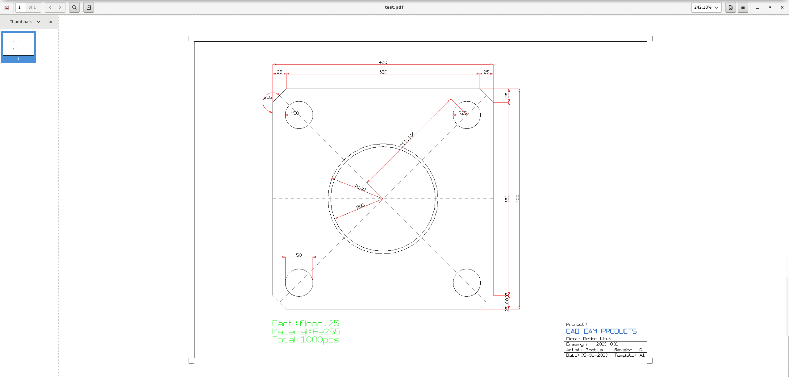

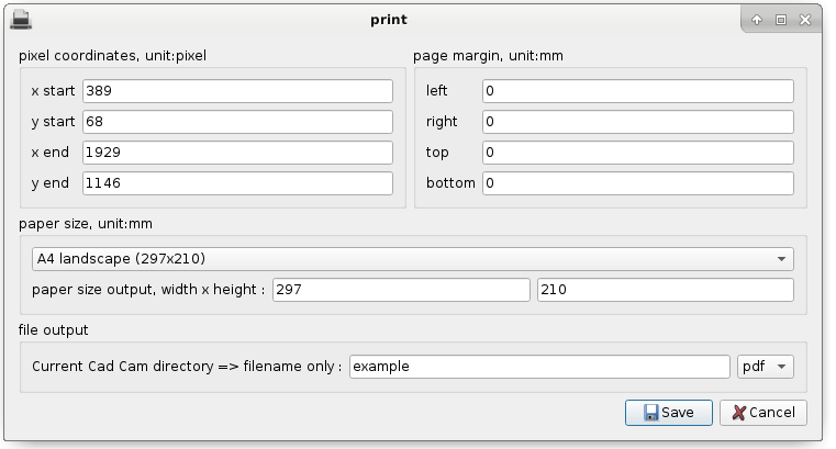

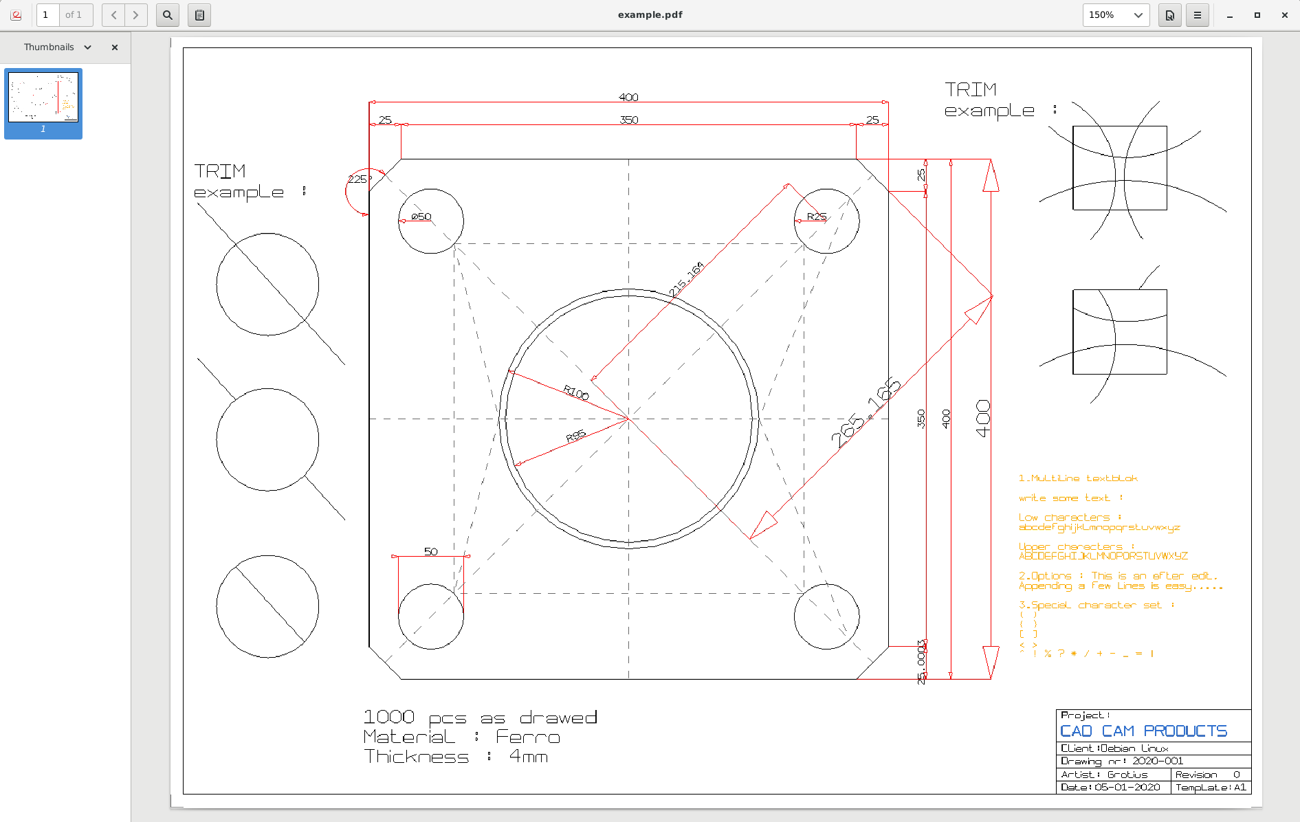

1a => At this stage we can print paper output : A0, A1, A2, A3, A4, A5, A6, landscape and portrait style.
1b => Use margin's if needed
1c => Print in pdf or png format, fitting exact to selected paper dimension.
1d => Printing is simply done by clicking a 2 point selection window. Then it opens the print dialog and pixel value's are displayed.
1e => User can define own paper format, no problem.

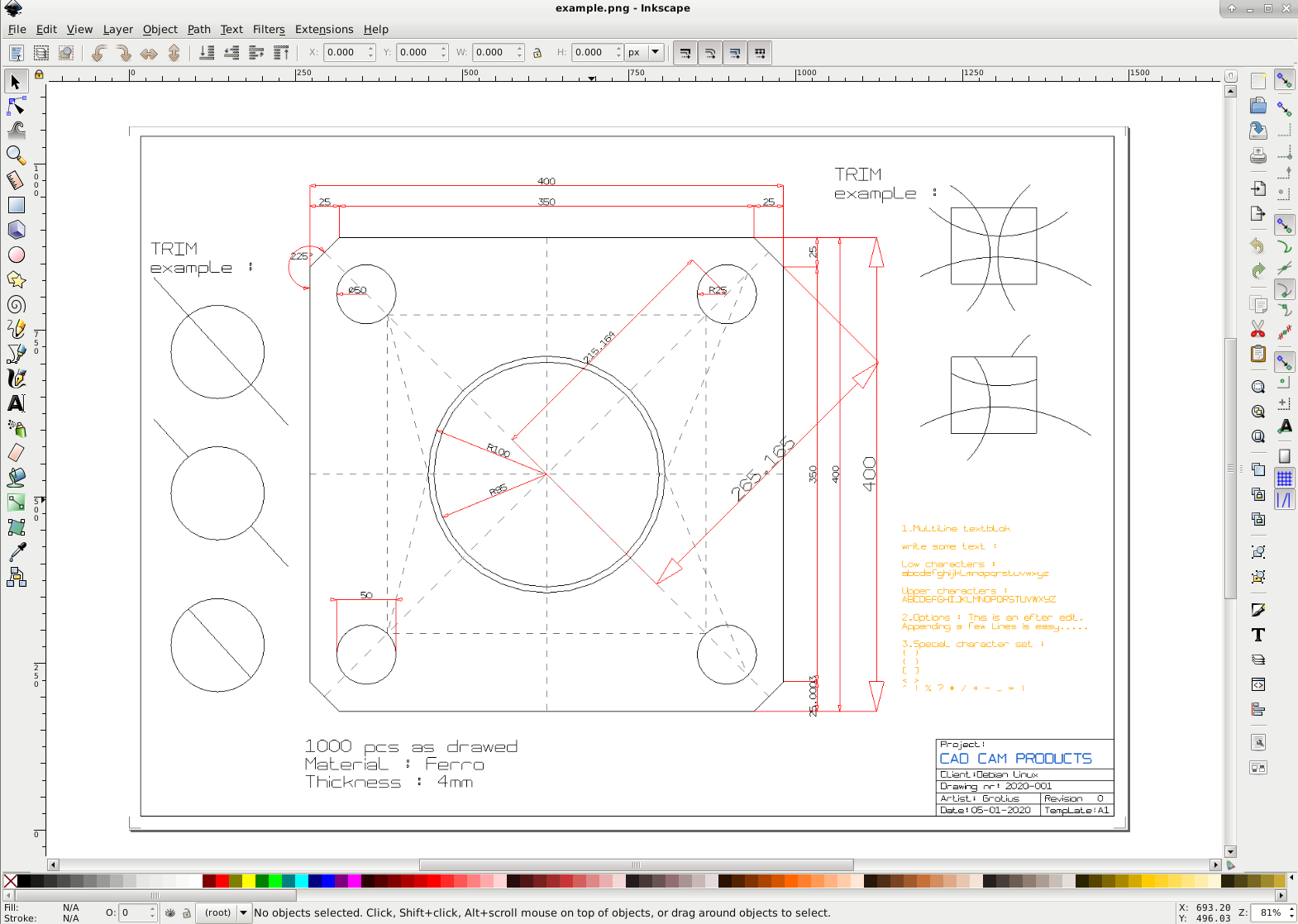

Print dialog :
Png file loaded into inkscape :
Pdf file loaded into a pdf viewer :

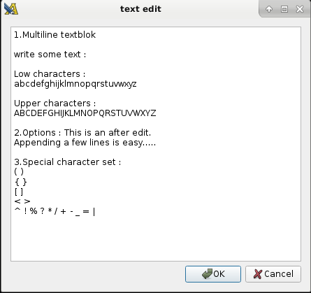

2a => The text edit works nice. Now we can write a single line or multiline text at once, and edit the multiline text later on, very easy.
3a => Expanded some trim functions, had only done the line-line trim so far.
The trim function is expanded with : line-arc trim, arc-arc trim, line-circle trim, see example below.
Have to do the circle-line trim and add extra functions to the extend function later on.

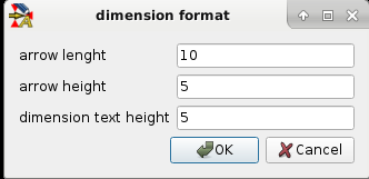

4a => The dimension style class is extended to modify arrow lenght, arrow height, and text height...
Todo later on is to add a precision format, and a dimension text overwrite option..
