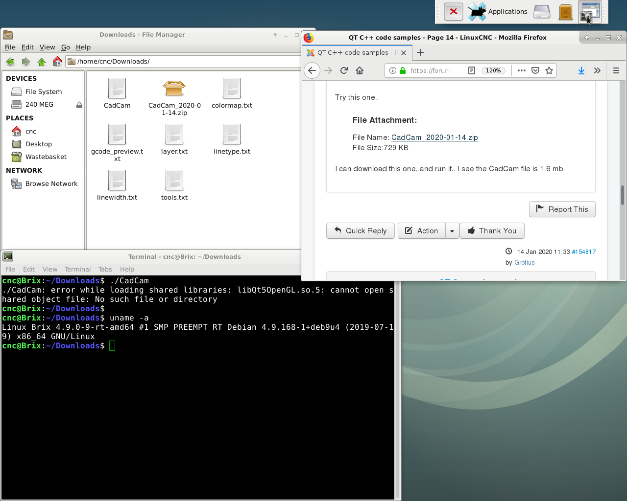

Thanks for all the hard work you are putting into this.
May I ask a dumb question does this run on a windows machine or linuxcnc.
Replied by Clive S on topic QT C++ code samples
Phill,
You don't have to use QT for it. Just run the ./Cad file, its a compiled executable about 29mb.
You can directly run the program. Please try if it works!, thanks.

When I unzip it, Cad is only 1.55Mb and does not open.

I get the following error:
phill@stretch ~/Downloads/CadCam_2020-01-14 $ ./CadCam
./CadCam: /usr/lib/x86_64-linux-gnu/libQt5Core.so.5: version `Qt_5.12' not found (required by ./CadCam)

I have tried this but it won't open.

Getting the same errors on all of them, even the 29MB one, the QT core version is up to date.
Slowly but surely i am beginning to hate QT, everything i have touched with it comes back with a plethora of very cryptic errors. Not good at all.

Hi all, thanks for this test phase so far.
I got a solution !! It's called "deployement" It writes all files, dependencies, libraries etc into one file as an image..
Have tested this on a non qt linux pc and it works now.. The program can be started from usb also..
The procedure is very, very easy :
Download and unpack the zip file, the executable is named : Cad--x86_64.AppImage (p.s. must be marked as executable, but i think it is already)
Download link :
CadCam program
For other QT writers..
I used in terminal :
terminal : export PATH=/home/grotius/Qt/5.12.3/gcc_64/bin/:$PATH
terminal : ./linuxdeployqt-6-x86_64.AppImage Cad -appimage
This video does the trick : h__ps://www.youtube.com/watch?v=2B--nzfoQ9s
Download link :
CadCam program

It looks good but there is a bit of strange behaviour shown in the video linked to below.
This is on a Stretch virtual machine in VMware Fusion on a Mac. I will try later today on a real machine.
Replied by phillc54 on topic QT C++ code samples
Yes, that worked.The procedure is very, very easy :
Download link :
CadCam program
