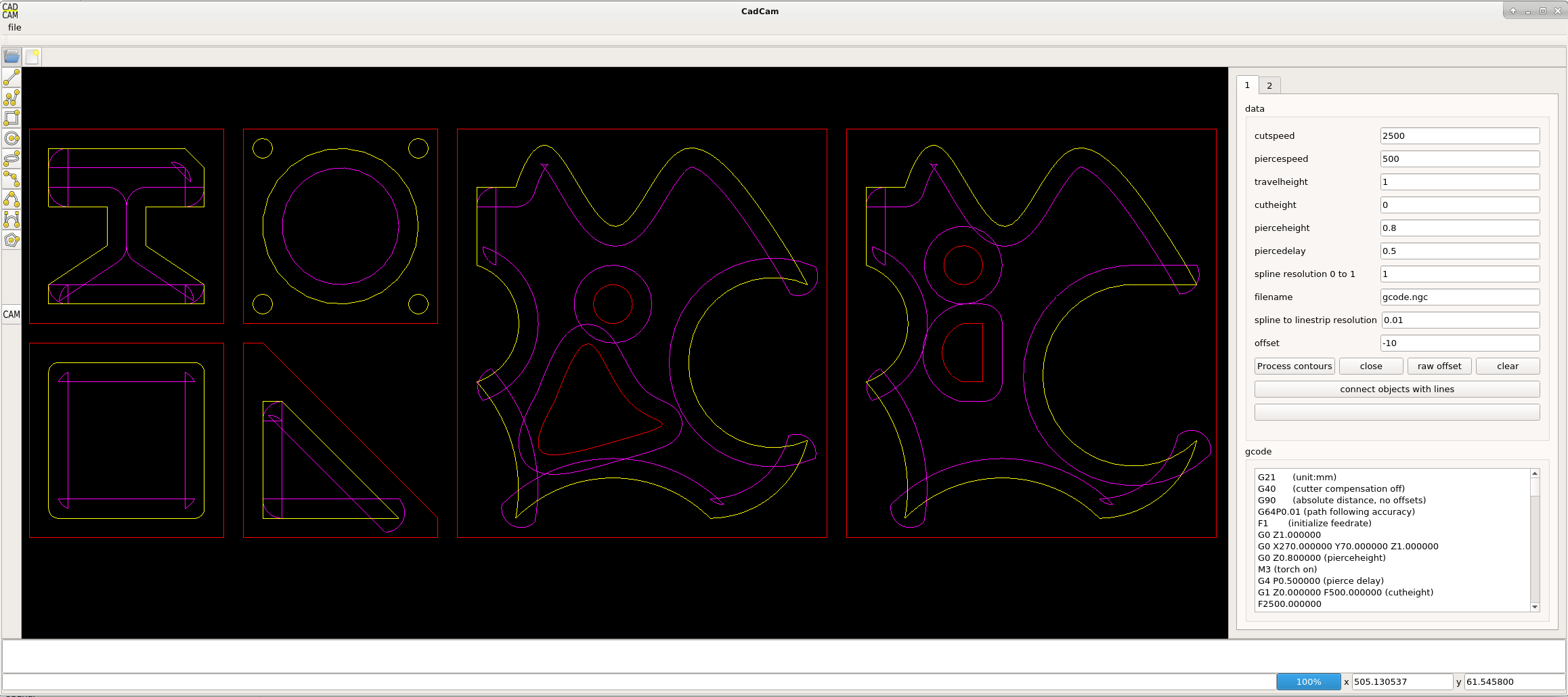

16 May 2020 21:29 #168007
by Grotius
Replied by Grotius on topic QT C++ code samples
A short update of the Qt cadcam program until now.
I am building a new CadCam program from scratch. This is my 3rth attempt.
It will include a Cad section and a Cam section with offset operations for plasma and milling machines and it will include pocket operations for milling machines. It will be 2d.
For 3d i am a fan of Freecad.
My c++ knowledge is after one year at a more usable level. I am sure it will be nice from here.
See attached beginning program code, display.h is interesting.
Object.h is a structure style, used to store all data like lines, splines, circles, arc's etc. This is a powerfull program style with automatic memory allocation. For example, The structure style can morph a line into a spline etc.
The file input_data.h is a file wich is used to add user data.
The file display.h is used to dispay the data.
So far so good !

21 May 2020 21:06 #168533
by Grotius

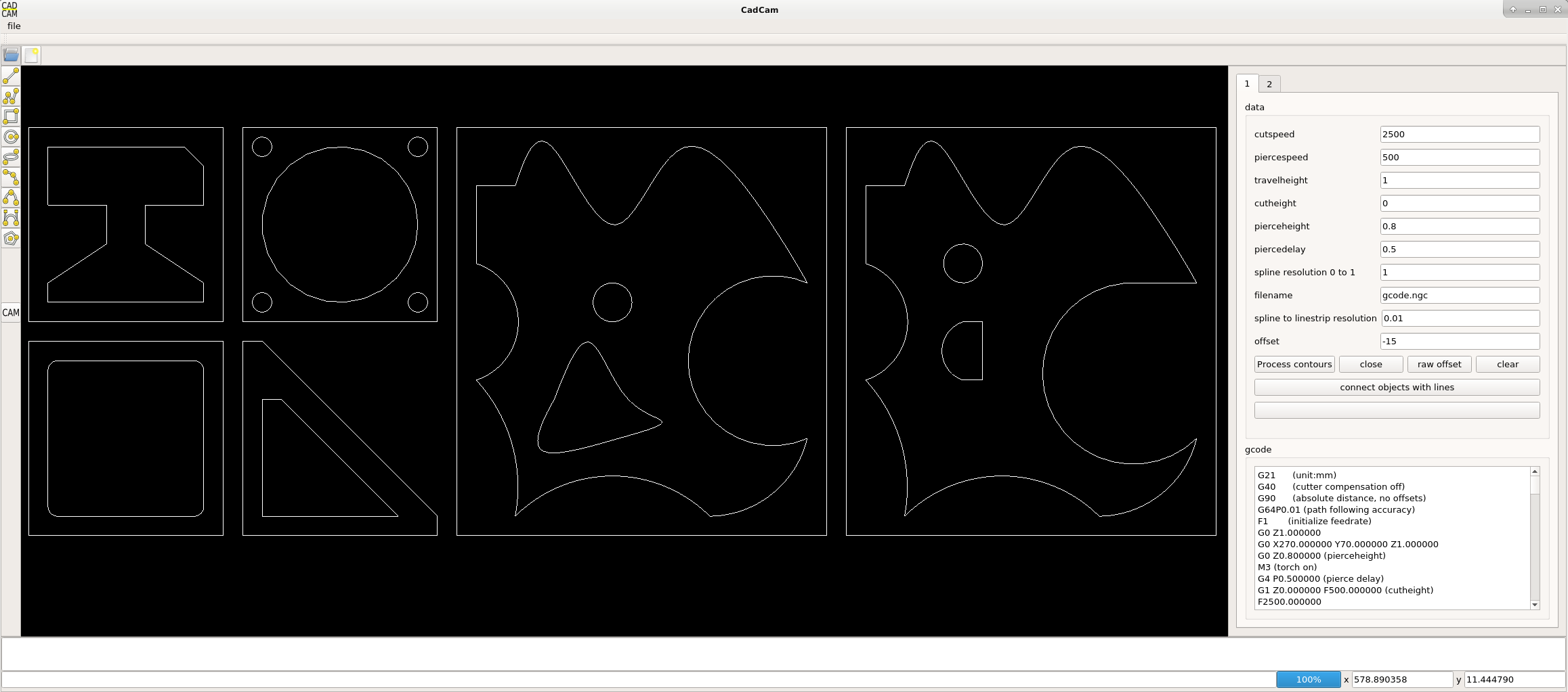

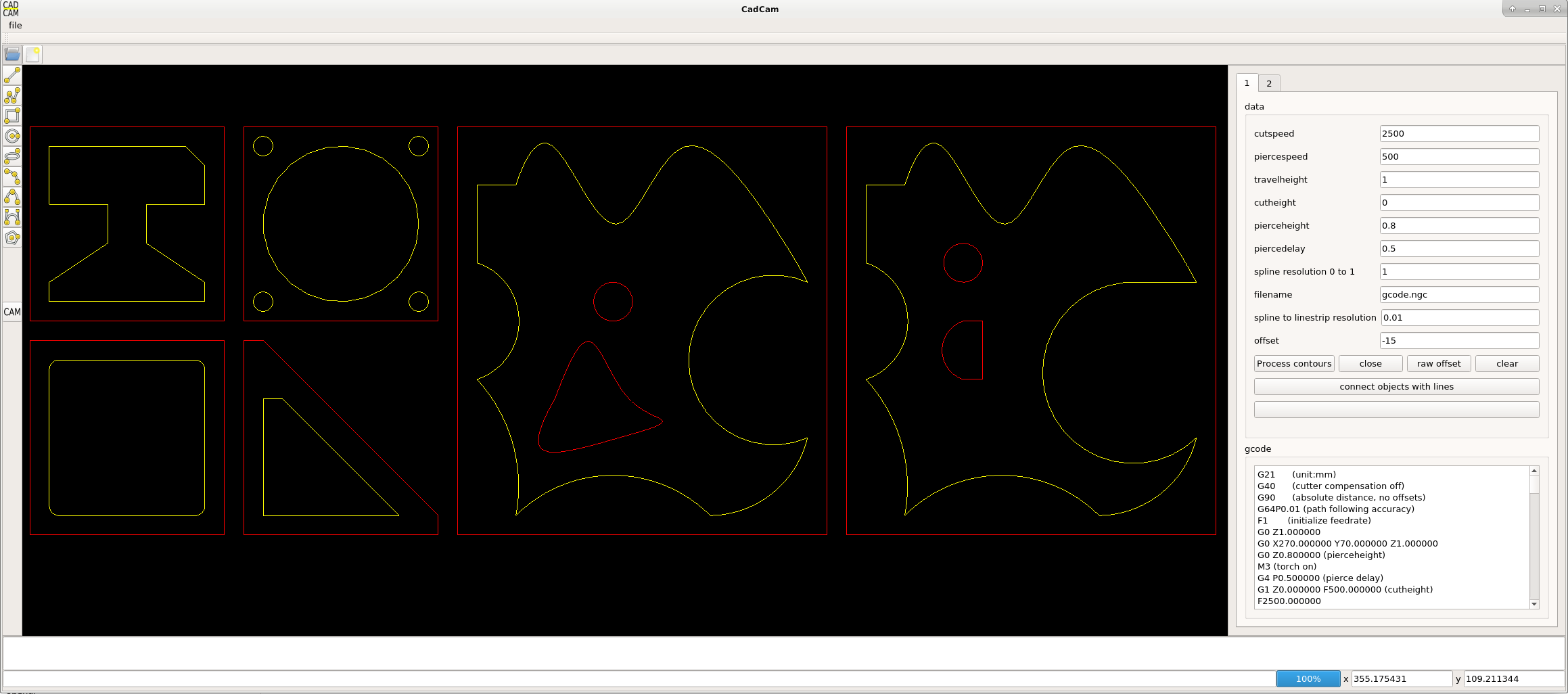

Hi, a short update,
The contour recognize algoritme works quite nice and is almost ready.
Every object start- or endpoint within the user tollerance is calculated to
a close or open contour path with a unspecified direction, cw or ccw direction is calculated later on and before when we look
at contour depth's.
I am happy with the current programming style. See the attached source code.
Next thing to program is a pocket algoritme. I have designed the pocket algoritme on a paper several times, and i am confident it will be a usefull algoritme for linuxcnc.
The good news is, the pocket operation is capable to offset bezier curves, splines, etc. This is quite remarkable.
The spline output for Linuxcnc gcode can be selected as a G5 or as a linestrip output. This is quite easy to do for me now.
Take a look at the object open ends. The blue closed contours are within a example used tollerance. White is open contour.
Have fun with coding your C++ application.

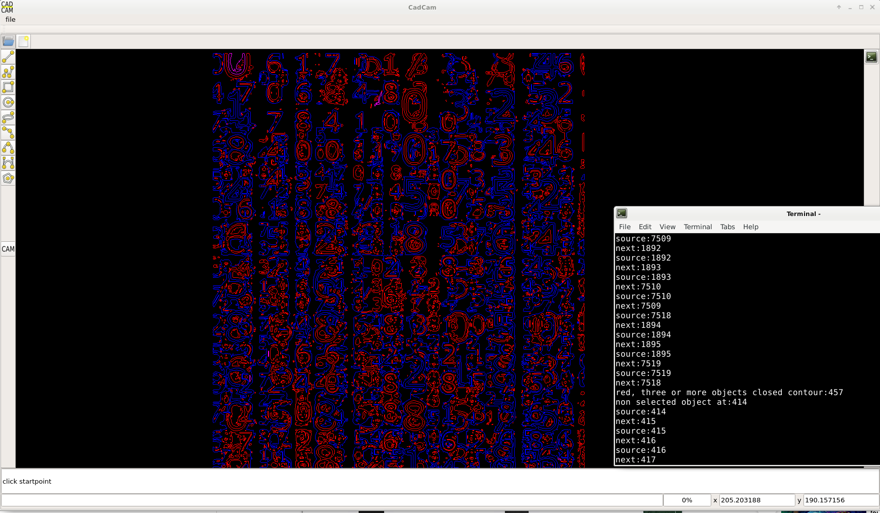

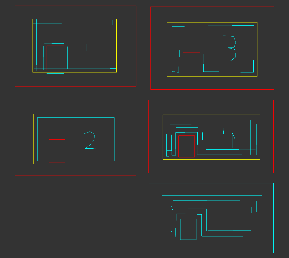

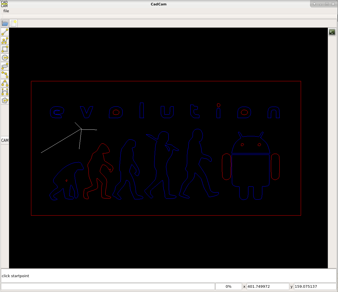

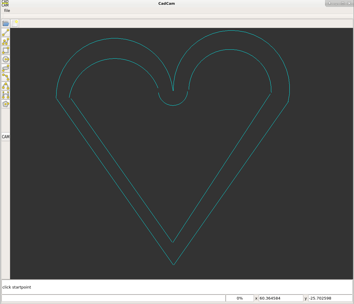

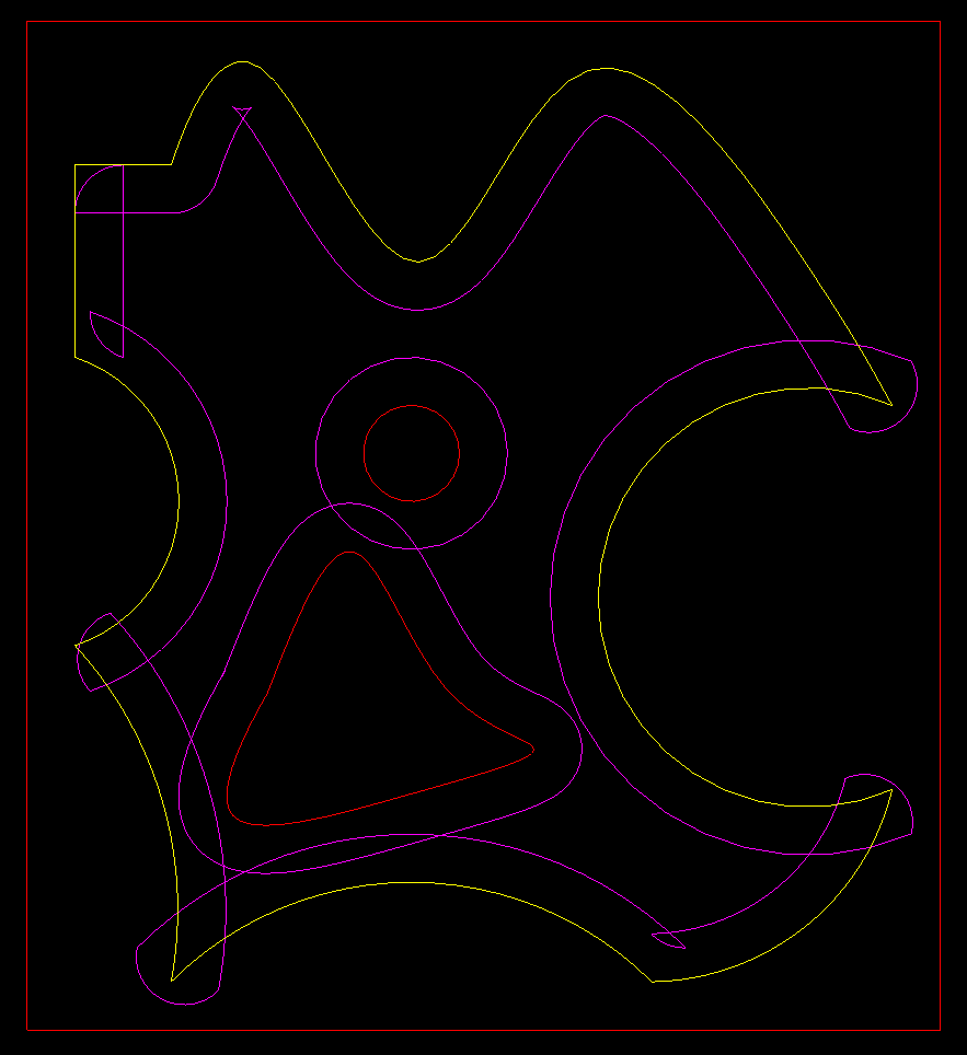

Hi all linux fans, a c++ update today.
Currently writing a more robust contour algoritme. It's written as a header only library.
Output:
Grey : open path's
Red : single object, such as a spline with identical start- & endpoint.
Purple : closed contours that are build up from 2 objects.
Blue : closed contours that are build up from 3 objects or more.
Sequence:
All closed contours and open path's have the contour sequence.
Next step's are programmed, tested etc, but not integrated in this example.
Steps:
Area calculation for cw and ccw (for info: if area is positive we got cw, if area is negative we got ccw)
Add contour depth's (pip=point in polygon algoritme)

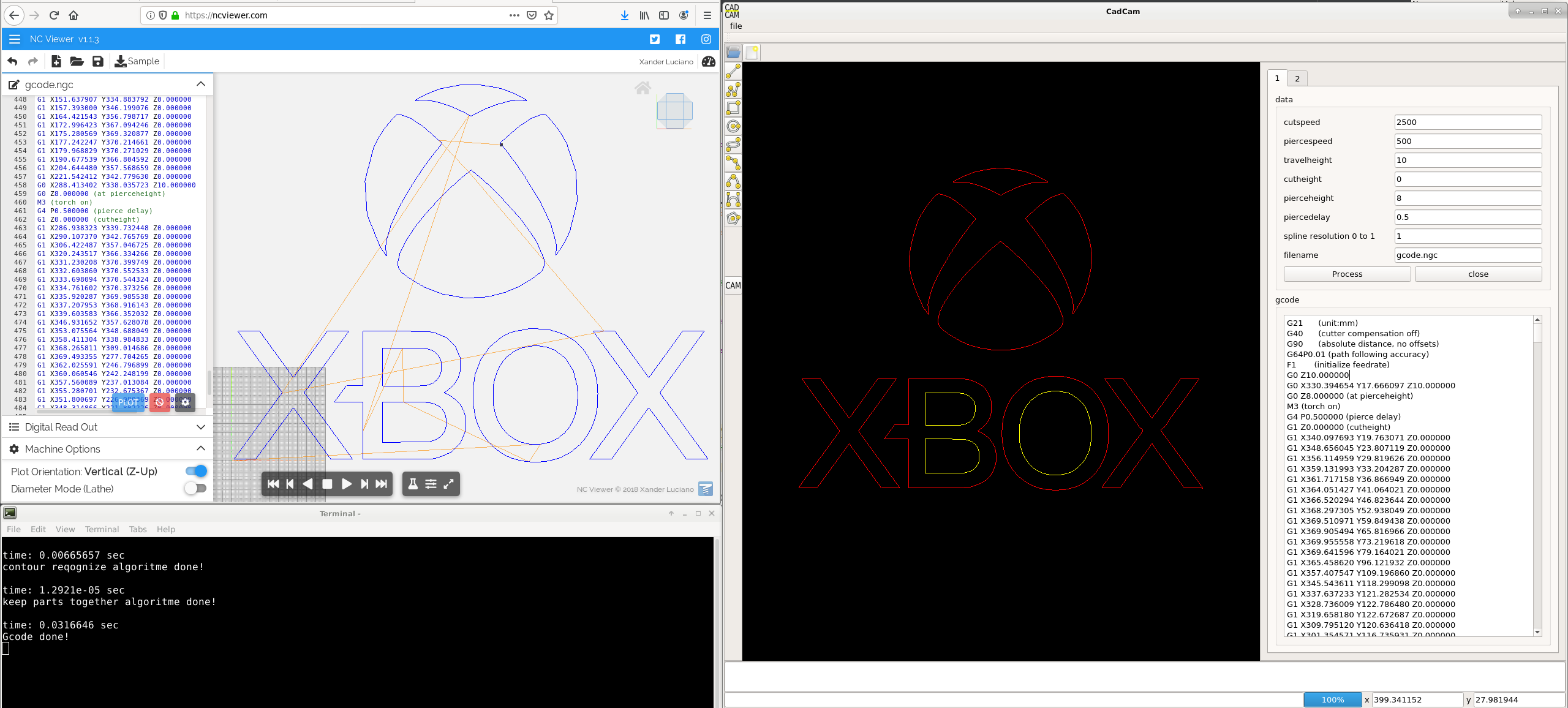

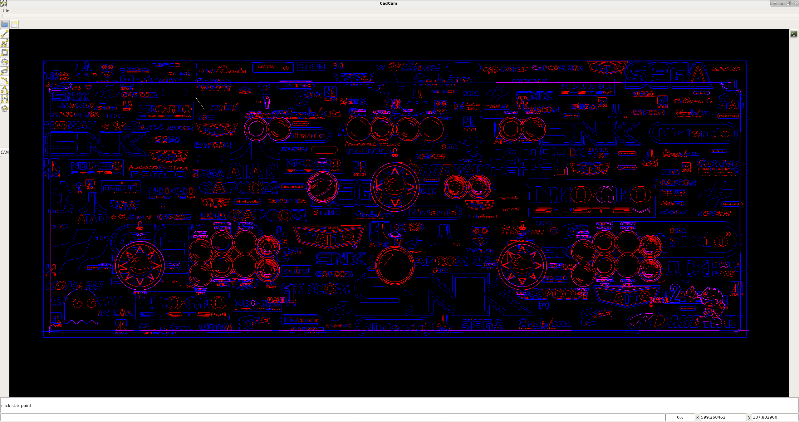

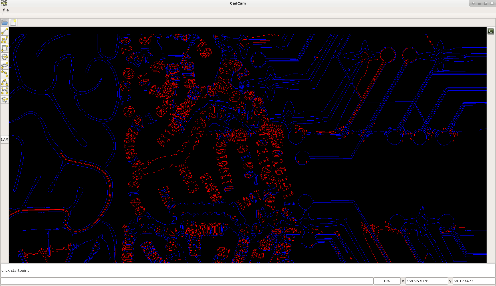

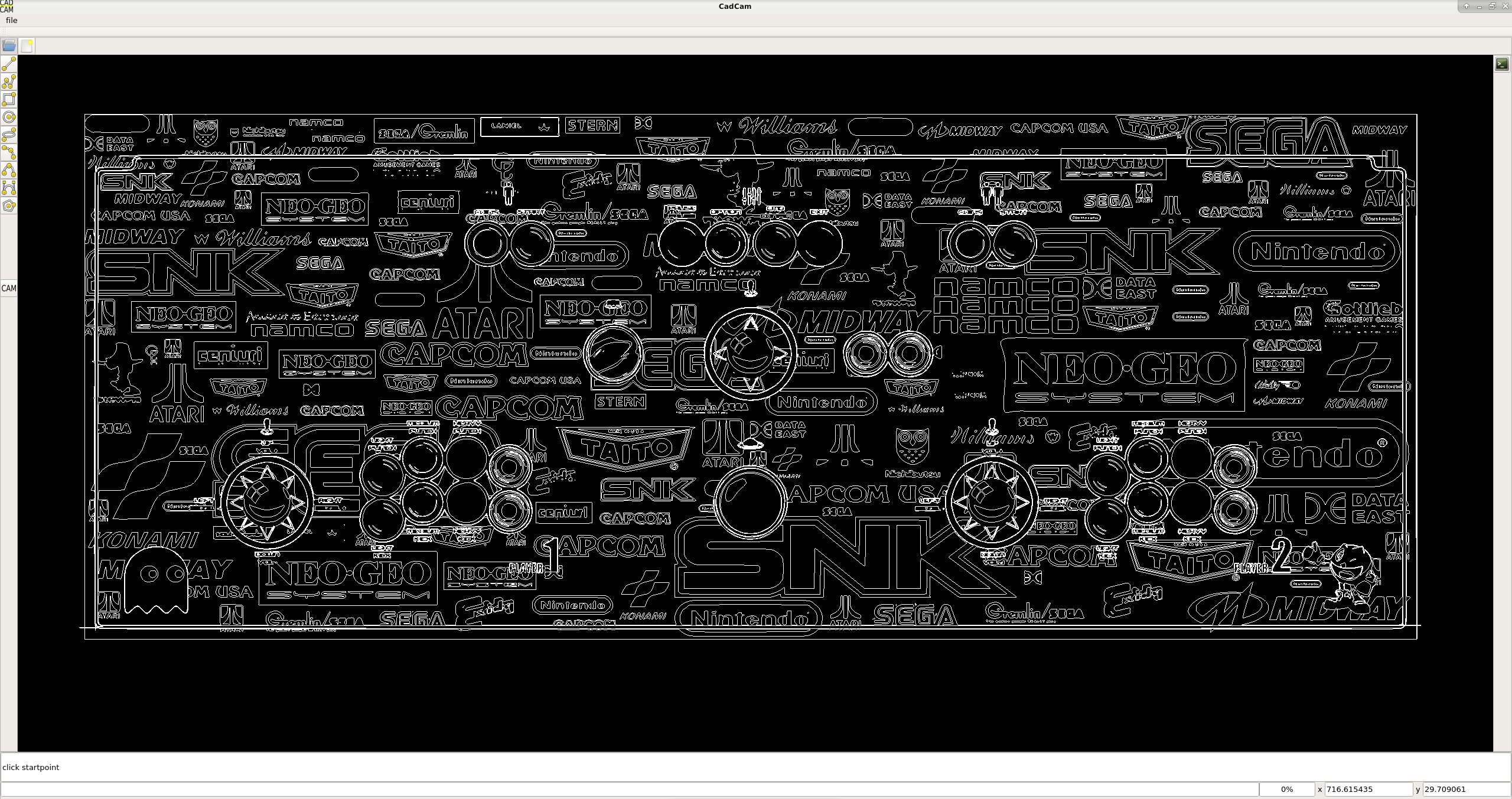

Oke, here are a few hardcore contour test's that are difficult to do with conventional cam program's.
I started with a downloaded picture, followed by the inkscape dxf output:
Then we press the cam button in the CadCam program and wait a few seconds:

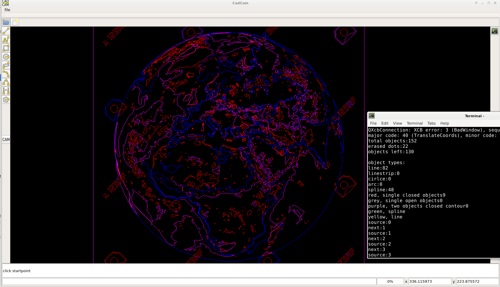

Ok we try another one, earh map:
Another from the matrix:
Evolution:
Ai:
So far so good. Have a nice day !

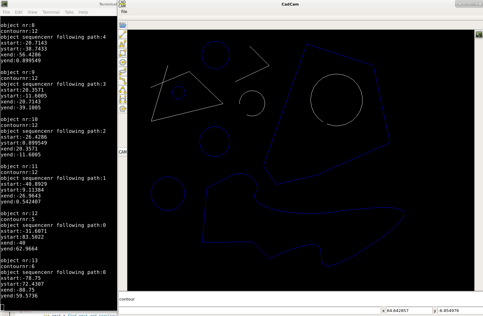

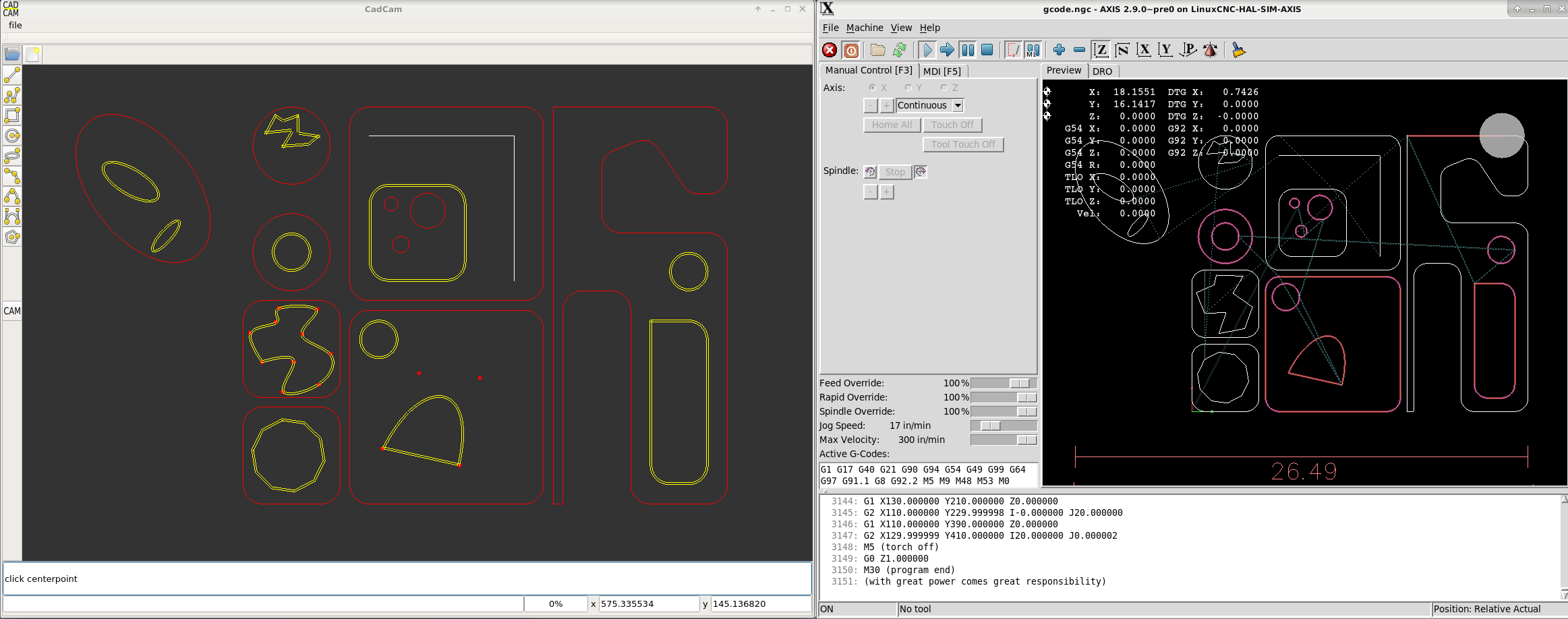

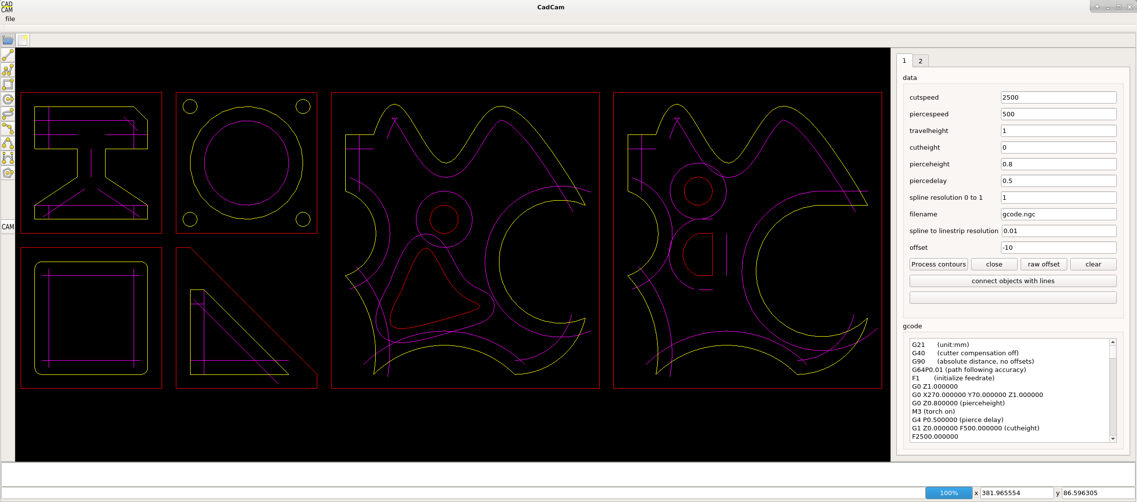

Project update.
Today i added gcode output. The gcode output looks okey. Tested with ncviewer several times.
Splines are morphed into linestrips with a user defined accuracy, set to 1.
Depth cutting sequence okey.
Keep parts together cutting sequence okey.
Cw and ccw cutting sequence okey.
Time to add the G5 for splines. Have to practice with linuxcnc a little bit to find out how to program the G5 output in a correct way.
End of this week i will try to deploy an app image, for current version.
My current linux system is too new to deploy an app image. No problem, i will grab a other hard drive later on.
Project source code attached.

Today we are at a new level. Finally starting with the pocket algoritme.
Have made a offset.h file that can offset all types of curves.
At the moment it can offset : line, linestrip, polygon, arc, circle, ellipse, bezier curve, rectangular.
The pocket algoritme is quite a difficult algoritme to design.
Some of the reason's why a pocket algoritme is quite difficult is because it can form islands :
Another example of pockets with inside contours :
With some contour shapes, you need to place an extra arc, to reattach the contour again :
Before i start writing this procedure in c++, i write the workflow down on paper :
1. To keep it simple, we start at the yellow contours, they are up to date for a pocket operation.
2. We do a contour offset with a value of -2mm for the yellow ones.
3. We do a intersection loop trhough the contour objects.
4. We do a contour offset with a value of +2mm for eventually insides of contour 0.
5. Intersection loop again.
6. Check if offset paths are closed, if not, place arc's to close the contour.
7. Check if offset paths are closed, if yes, go on, if not, message the user to get a cup of coffee, user is trapped in a infinite while loop
6. Now we check if the offset path's are self intersecting and or intersecting with other offset paths. If yes : start at a free line (non intersecting line, arc or watherver) at the intersection point, go to the left at that point, reattach to intersected object, and select objects wich are done. (later on we delete all non selected).
7. We have to look when to stop the pocket offset loop.
This is how it would look like :
I am curious now how difficult it will be to get this right...
Last week i thought about the auto nesting algoritme for some time. I have good hope for that.

Okey lets show a basic imported dxf drawing. It got lines, splines, arc's and circles.
Okey the contours are calculated. This programming work was already done and checked. Later on i will change this
source code with more iterator style.
Okey now we do a raw offset to the contours. The splines are offsetted as linestrips. So the splines are still one object, with multiple
controlpoints. This is important.
Okey now we connect the items with an arc to get a closed contour again.
And now i have thought about a technique to find out what we need, and what we dont need anymore.
For now only for one closed contour.
1. we start somewhere at the cyan line. the direction is still ccw for a yellow offset.
2. if we spot the first intersection point, we remember this point.
3. we loop through the contour until we meet the rembered point again. Okey now the calculation starts.
4. we save the xy intersection point.
5. we follow the path, we save every point that we pass (endpoints of each invidual item) until we meet the intersection point again.
6. now we do a area calculation of the points. If area>0, all objects we have passed are not to be used.
c++ source code attached.
