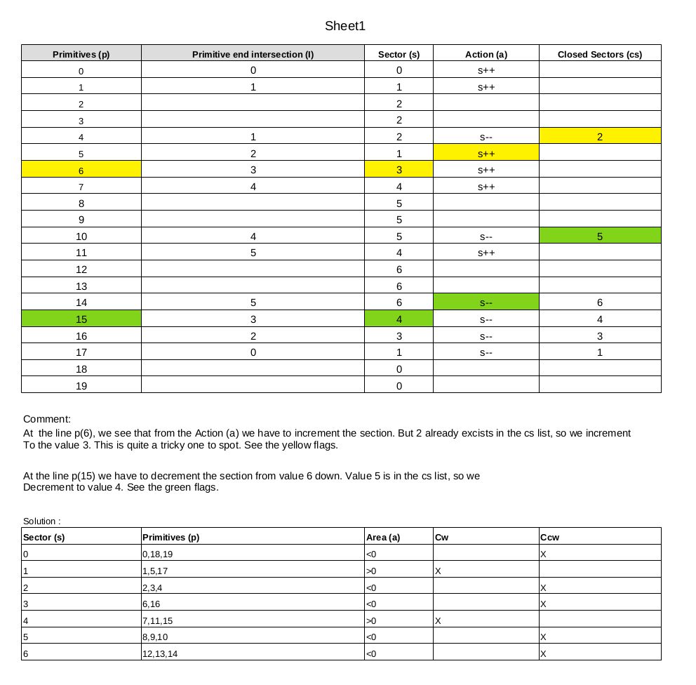

Reading online papers how to do a contour pocket offsets don't really tell how to do it in detail, step by step.
And they don't tell how the algoritme looks like. One solution that passes by is the Voronoi approach.
But it's not satisfying my needs.
So i started from scratch for this. Have made a document how to solve a pocket operation,
have tested the algoritme in several ways. It looks oke to me. And the input data is quite simple.
The calculation an sich takes some experience, this can be done by practice it several times.
I Hope it can help someone in the future to save time.
Later on the C++ header file for this pocket algoritme can be downloaded from my github channel.
The pdf document :
This browser does not support PDFs. Please download the PDF to view it: Download PDF
Have a nice day!

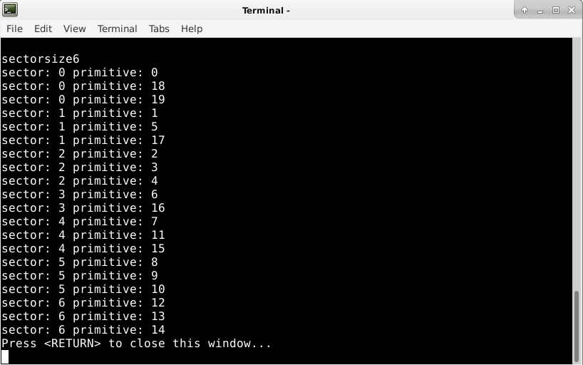

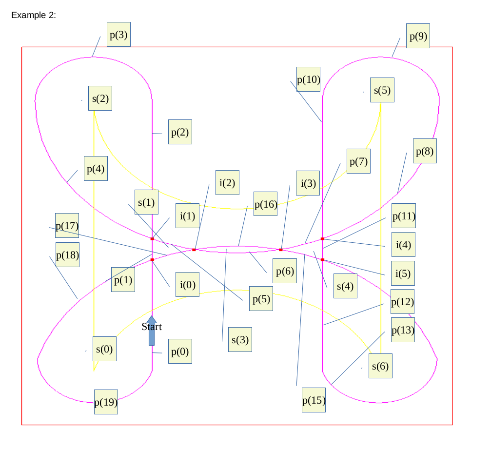

25 Jun 2020 20:44 #172752 by Grotius
Replied by Grotius on topic QT C++ code samples
Attached the tested header file "lib_pocket.h" for solving the pocket algoritme.
The terminal output is oke :
It is used for example 2 :
Today i did a hand calculation for example 2 :
So this is quite nice. After all, it's quite complicated stuff !

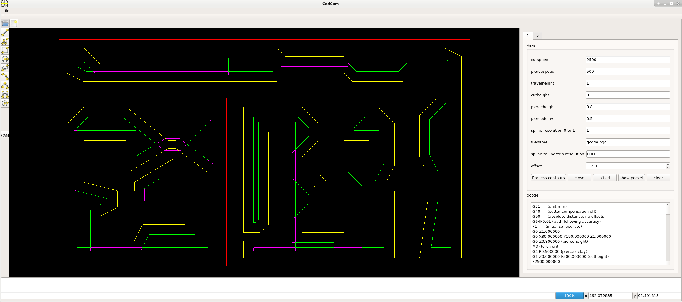

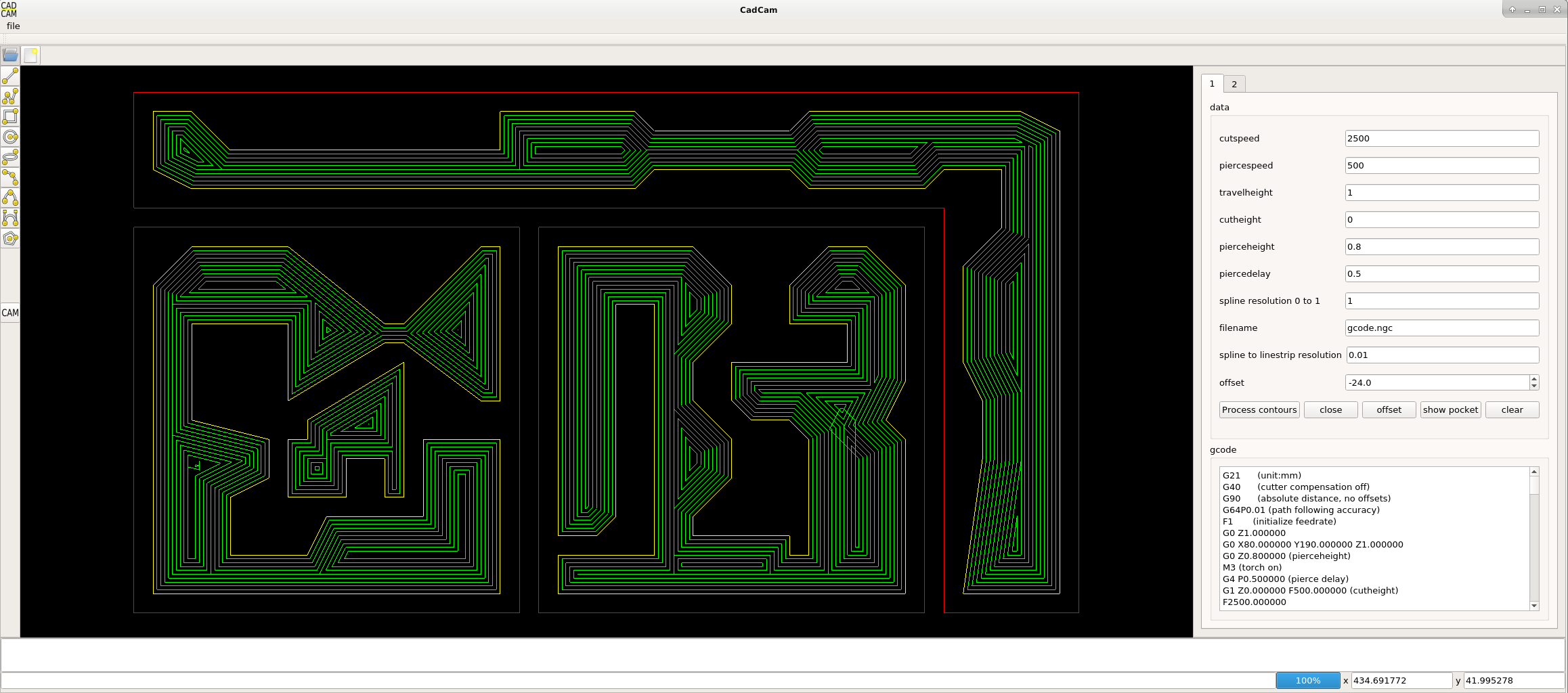

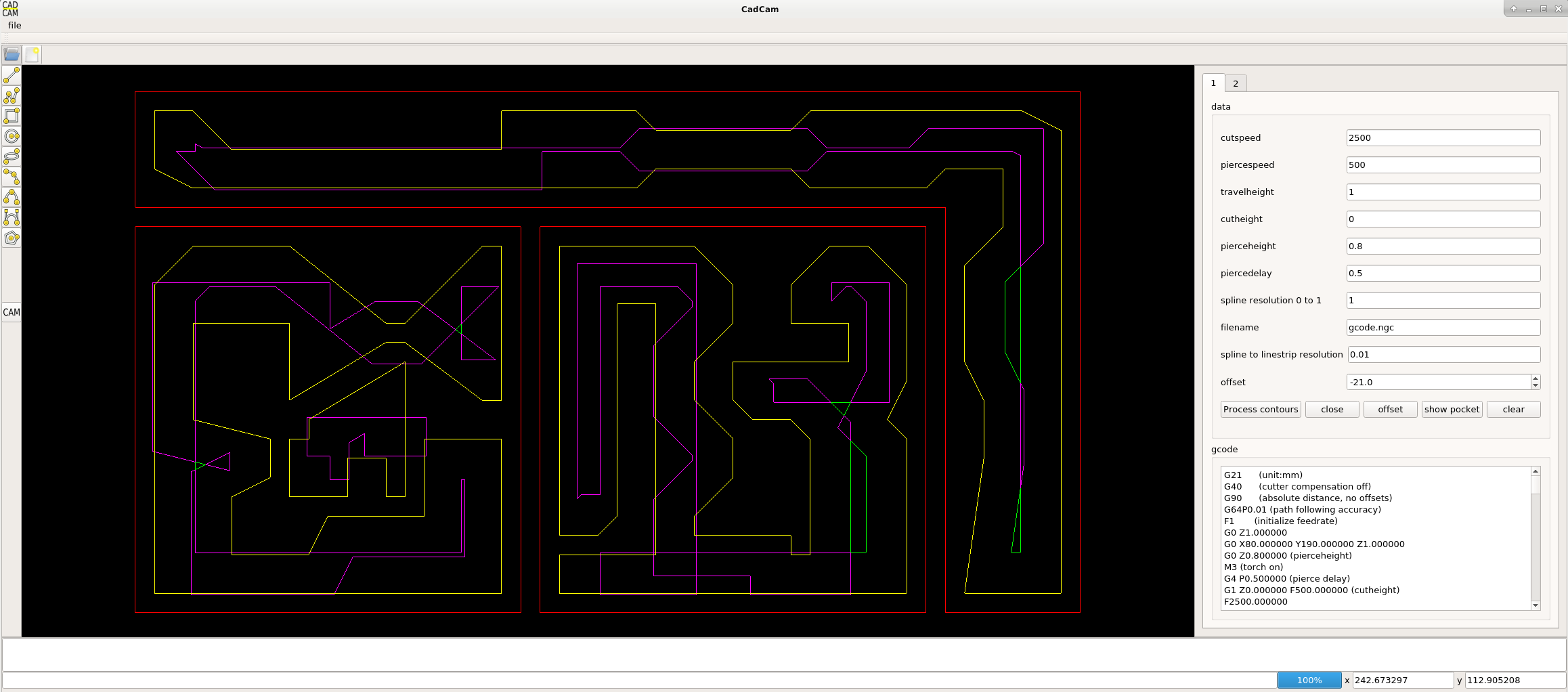

28 Jun 2020 18:23 - 28 Jun 2020 18:36 #173014 by Grotius
Thank you Patrik for the code sample. Yes i mixed them up, excuse for that.
This is interesting for me:
Object* object (i guess a pointer)
&object_1 (I guess by reference)
Today i tested some more with the pocket algoritme. To keep it simple i started with lines only. There was much work to do to get
it like the preview. There where some offset difficulties when value's became Nan. Some intersection problems that had to be solved.
A whole list of difficulties to get trhough.
This contour preview is based on a contour offset from farest outside to offset distance.
Next step is do a repeated offset from old offset to new offset and then stop offsetting at some point.
For today i am satisfied. :laugh:
Here you can see how the algortime works at offset distance -12mm
The purple lines are area's with positve area, these will be removed. It is showing how the algoritme works behind the screen.
At offset -21mm, there is almost no positive area left (positive area is color green)

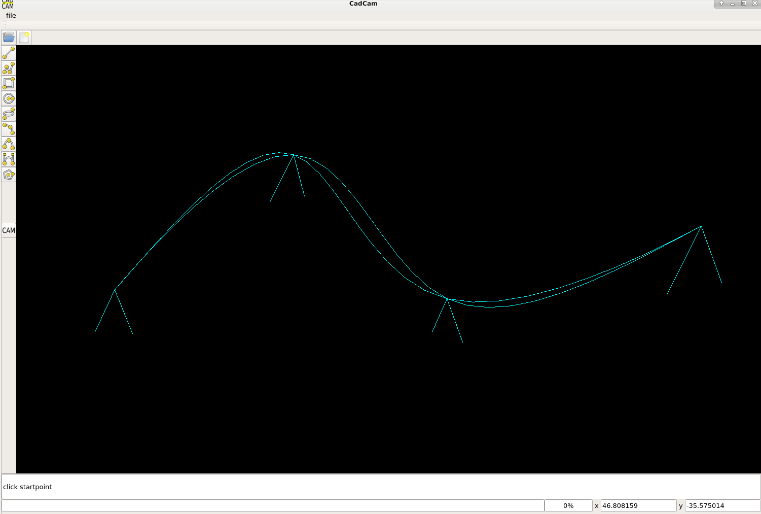

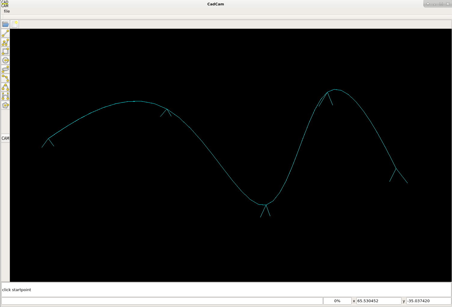

29 Jun 2020 23:28 #173153 by Grotius
I had an idea about a new type of spline. Tonight i did a "true spline" test for the fun !
The picture is showing a normal natural cubic spline.
When you draw the spline from left to right, and then you draw it from right to left, there is a difference.
The picture is showing the difference. The algoritme that is used : mathworld.wolfram.com/CubicSpline.html
Okey for robot's it's not handy to interpolate in a different path when moving in reverse.
And in the CadCam program i spotted "this not really problem" several times during swapping a spline.
The idea is to produce a spline that is always the same in every direction. The picture below is showing a True spline.
I call it that way. Just a name.
The C++ code is attached.
