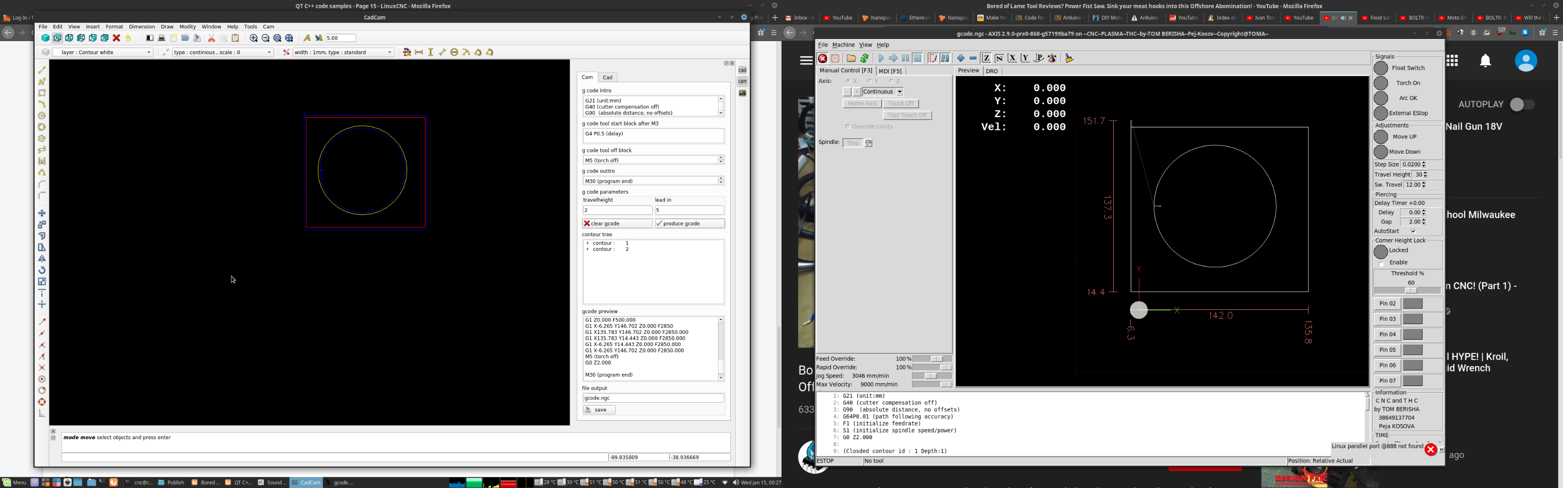

14 Jan 2020 23:50 #154860 by phillc54
Replied by phillc54 on topic QT C++ code samples
Well my issue seems confined to my Mac with a retina screen, the workshop Mac with a standard screen runs it fine in a VM and it runs fine on a real machine.
Everything that is there seems to work, it certainly is fast and it produces gcode.
I didn't see the issue Clive had, all the snapping worked
I am impressed, great work...

@Phill,
It looks good but there is a bit of strange behaviour shown in the video linked to below.
This is on a Stretch virtual machine in VMware Fusion on a Mac. I will try later today on a real machine.
The y-axis mouse cad coordinates are responding in line with the mouse movement. It's like the opengl screen is inverted on the y-axis.
Could this be a VMware related thing?

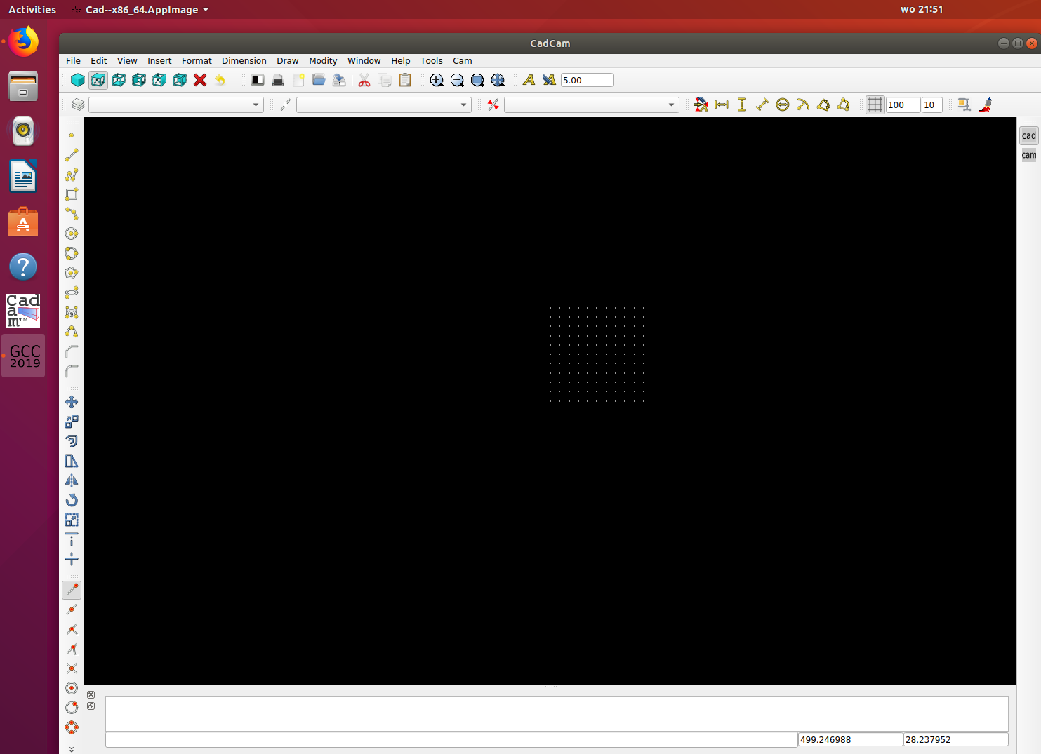

15 Jan 2020 20:04 #154949 by Grotius
Replied by Grotius on topic QT C++ code samples
@Tommy,
I dont exactly understand your question.
But with the version below you can follow the grid that starts at xy : 0,0
Here is a new CadCam for today : Cad
updates:
1.grid, this was a request.
2.line, linestrip, reqtangular are improved with coordinates, and clicking procedure

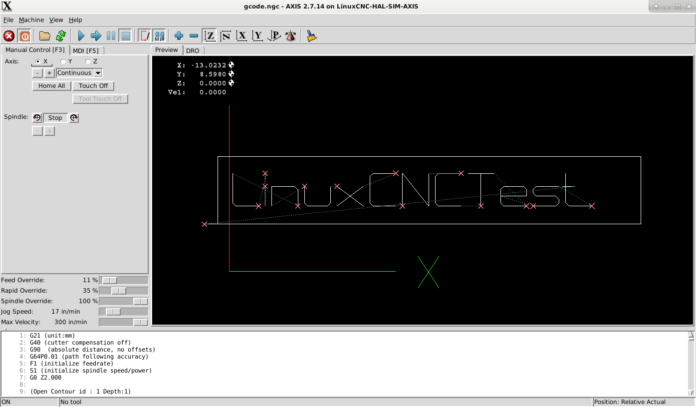

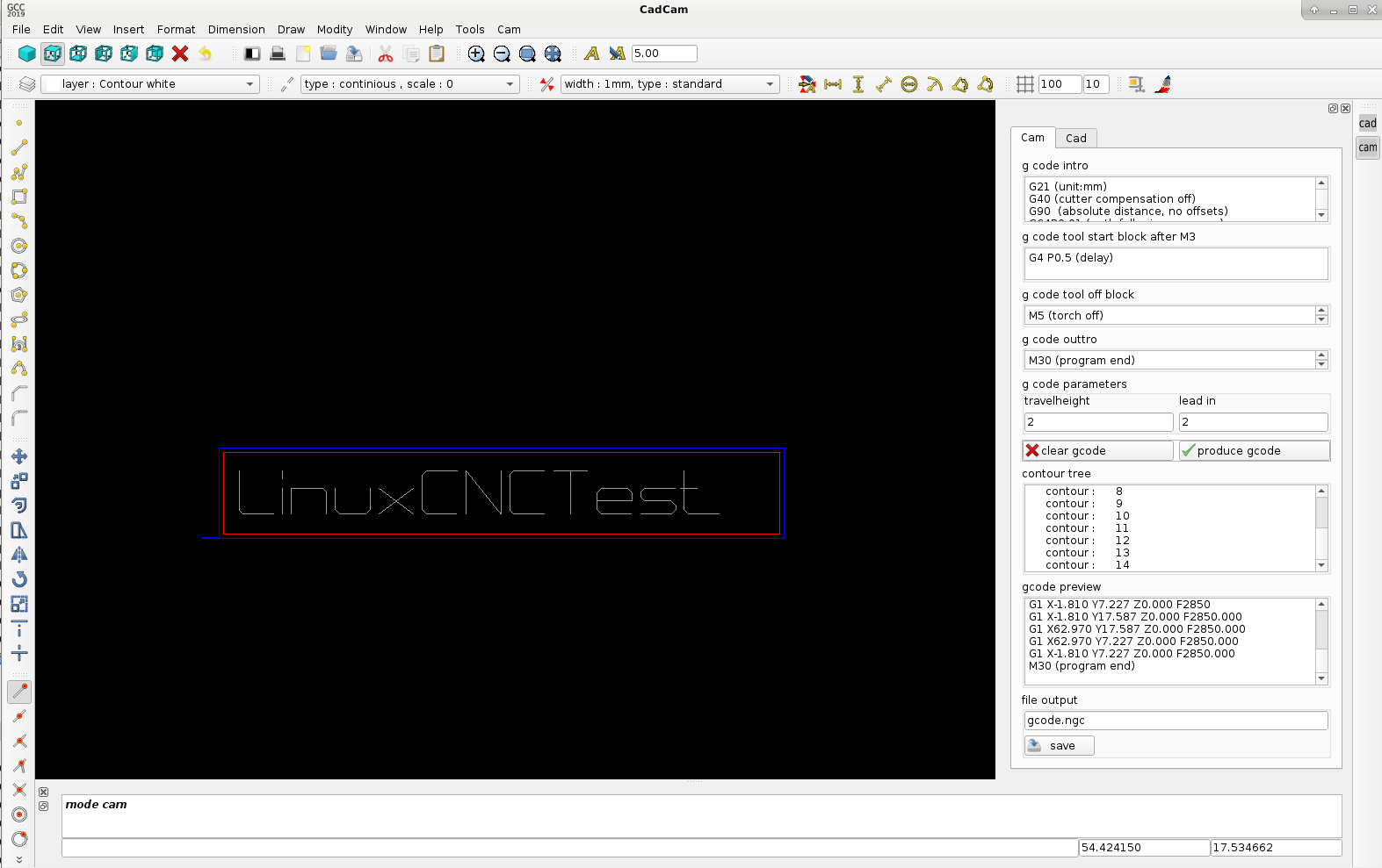

21 Jan 2020 18:43 - 21 Jan 2020 18:46 #155347 by Grotius
New release for today : CadCam
Included updates :
1.text fonts processed to gcode
2.draw points, also available in cam (this is handy for future drilling operations)
3.match properties in cad section. (matches color, linetype, linetype scale, textheight etc).
4.drawing purge function. Clean's up the array (delete's empty items) result's in reduced drawing file size.
Text to cam preview :
Look how the letter 'X' is done by the cnc machine.. This is a fast engrave letter fonts designed with minimal start's.
The gcode of this file is included with the release of today
Linuxcnc preview :

Hi Today i have a .deb package to try out.
It's installed like Freecad or Draftsight... Have fun !
Download link : CadCam
It's tested on a fresh ubuntu install without anything of qt installed.
Copy the entire 'cadcam' folder to your /home directory.
