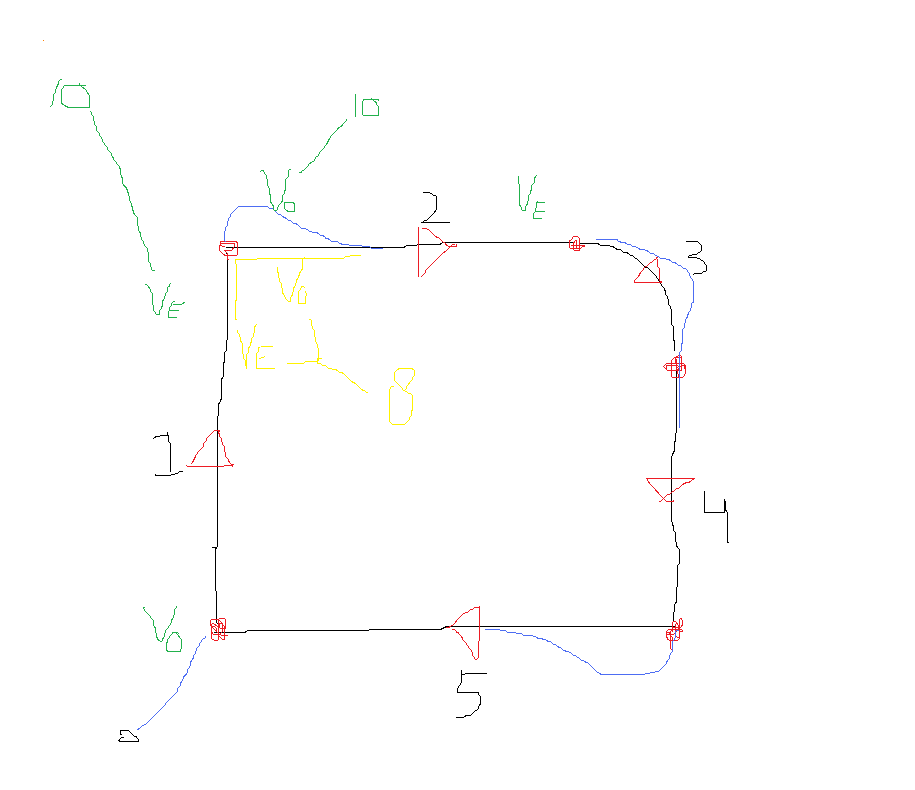

Hi Rod,
Thanks for your comment.
I have to be more specefik.
In the lcnc code there is a G64P0.01 to stay on path.
This will eliminate the cnc motion overshoot's in blue. I think the off path dist called "Ferror" in the ini files.
The motionplanner i have written calculates a path from a gcode. For example line 1,2 + arc 3 + line 4 + 5 will
be a motion where the s-curve does it's thing from start to end.
This video shows how the motion is done : user-images.githubusercontent.com/448801...7ee-0a229e1caa60.mp4
The stepgen component will try to stay at tcp speed, but
will overshoot at some corners if the machine speed is too high. There are plenty senario's where the machine has to slow down, but there are also plenty senario's where the machine may stay at full speed.
Therefore i have the idea to make a look ahead function that samples the Velocity end, Velocity start to get optimal results.
Green is a programmed value like Velocity : 10.
After the algo is done, it turn's out the machine will not overshoot if the Velocity-end of 1 = 8.
And so on.
So every gcode line has to be sampled and will get a different optimal value for Velocity start and Velocity end.
The s-curve max velocity will be used always. So when the machine can do it, it will go full trottle.
But with complex gcode it will sample until it will find the best g-force results, according to the acc and dcc values.
The picture is made with : sudo apt-get install gnome-paint

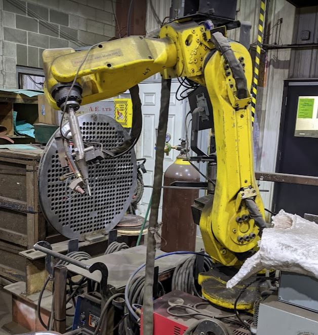

Hi Grotius,
The project I am working on is a 6 axis robotic arm, it is setup for TIG welding circular tube welds. I have a basic prototype working with normal LinuxCNC but looking at the work you have done with robotic modules for HAL has made me want to change my setup. I do not have a need for gcode and some of the features I have in my prototype are not ideal and use MDI and jog commands in a way I am not happy with.
The basic requirements for the robot are 6 axis kinematics to position in a XYZ coordinate area. The TIG welding head has a touch probe on it to find the center of the tube, once the welding starts it monitors the arc voltage to maintain the proper distance to the weld while rotating the 6th axis 360 degrees to preform the weld. Once the weld is complete, the operator moves to the next tube and restarts the cycle.
So I was just looking for some ideas if your modules would work well for this application? I see you have the kinematics with the KDL library already, do you have anything for probing? Any advice on how you would setup a system like this?

Hi Dave,
In the past i have done projects like that.
Professional inox heat exchangers where most of time welded with a polysoude welding machine.
I have welded a inox tube heat exchanger with sheetcam and mach3 in the past on a standard cnc, the result was ok.
For Valk Welding we used also a wire feeder on the robotic tig torch, but if the pipes are a little longer, you can do it without that option.
Hal-core is just the interface to the kernel (hal) modules. Hal-core is universal. It's like the big hardware & software connector between your robot motors,encoders and your c++ programs. Hal-core is realtime and fast because it operates from within the kernel. (golden keyring).
If you have installed hal-core you are able to connect your robot motors, encoders to hal. I use the ethercat bus for this. But you could also use other things like mesa, parport, rpi4 ethercat, etc as long as the driver is compiled and is placed in the hal-core/rtlib/
To send motion command's to your robot you need the kdl kinematic library. Wich contains your robot setup values.
Hal_kinematics is quite nice. You can insert your robot model parameters with hal commands. Examples are provided as runtests.
It's just like loading a bash script.
github.com/grotius-cnc/hal-kinematics

- Ruckig 0.001 sec 1 axis s-curve path interpolation, forward + reverse motion.
- cart xyz, euler xyz, 6 axis tcp output. extra 0-100% gcode block output.
- 3 axis path sampler, gforce optimizer Vo + Ve.
Sample, machine will go to 3 points. Problem is after passing P1 the tcp will not follow the path, but makes a path overshoot.
Solution, sample until the P0 Ve will not get a overshoot.
P0:
x 0
y 0
z 0
P1:
x 0
y 100
z 0
P2:
x 100
y 100
z 0
Howto sample?
Needed :
A: 3 virtual (lineair) stepgens or 3 ruckig (s-curve) axis, xyz.
- Inputs : Acc, Dcc, MaxVel=10, Jerk.
- Output : 3 axis xyz.
B: 1 ruckig cart xyz tcp s-curve gcode path follower.
- Inputs, the same : Acc, Dcc, MaxVel=10, Jerk.
- Output, xyz tcp.
Info :
- Vo is path begin velocity = 0.
- Vmax is max velocity.
- Ve on path = Vmax, is max path velocity of multiple gcode blocks, named a contour.
- Ve on path end M5 or G0 is 0.
Result : Difference (Ferror) in mm between xyz A,B.
Function : If difference (Ferror) > 0.1mm, sample with lower Ve on B until ok. Next block Vo = Ve.last
Sample algo has multiple stages to quickly find the solution.
For example, sample in 4 stages:
if 0.1mm && Vtcp==75% Ve
if 0.1mm && Vtcp==50% Ve
if 0.1mm && Vtcp==25% Ve
else Ve=0
Ruckig is standard used every ms, 0.001 sec. But for path optimizing we use a resolution of 0.1 sec to speed up the process.
- Check every 0.1 sec after the gcode block until the Ferror is ok.
sample 10-20 gcode blocks forward or sample everything after gcode file is loaded into the gcode block vector.

Hi Grotius,
This machine will be used for heat exchanger tube end welds, I have seen the polysoude machines before and used a similar setup. Pretty interesting that you have done something similar before, I will defiantly be picking you brain for information
My current robot setup is a Fanuc arcmate that I changed the motors to regular servos and connected it to a MESA ethernet interface card. We made the welding head from scratch and are currently working on a new revision.
One quick question, I was going through your post on compiling HAL components with QT, you have a include and lib directory in your hal-core directory in the pictures, but I don't seem to have one with the hal-core from github. Do I need to do a full compile of linuxcnc to get these include/lib directories?
Here is a picture of the robot (pretty dirty as the project has been on hold a little while haha) and one of the test welds the robot did before.

The directory structure of hal-core is slighty different then lcnc.
Lcnc has /include dirs. Hal-core uses the /src dir if it nees more info.
No, you don't need it. You only need lcnc if you want to simulate the robot with lcnc. hal_trajectory can be compiled with lcnc halcompile.
But later on halcompile is not used anymore. Now we use gcc (compiler) directly without a python script between it. That also makes it
more ultimate. We have seen that with compiling rpi4 ethercat hal drivers with gcc.
If you want to compile mesa source files. These are currently not present in hal-core.
But they have to be copied into the /hal-core/rtlib. Wich mesa drivers do you need to load?
If you can provide a 3d stepfile of the robot with your current tool eventually in welding position.
I can make a simulation for you.
You can make a qt c++ gui for parametric heat exchanger input. That i can use to send data to the robot.
But it may be also a dxf drawing of the welding paths.
