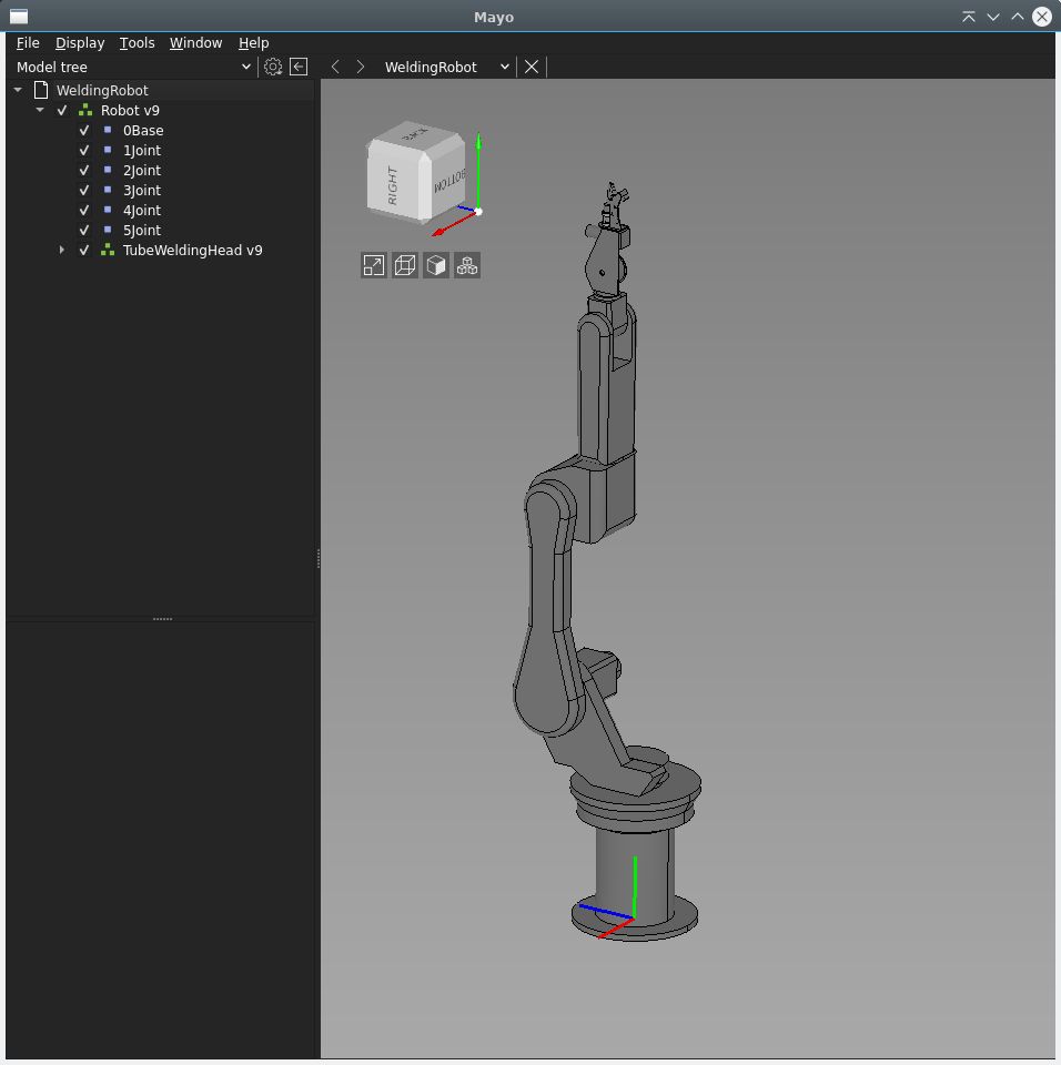

Hi Grotius,
Here is a 3d model of the robot arm with the welding head, the robot model isn't exact but the joints are in the correct location.
Please let me know if this will work for the simulation

Replied by Grotius on topic hal-core
Nice drawing !
For other users. To load and preview step files like this, you can use the program Mayo.
It can be found over here : github.com/grotius-cnc/mayo/releases/tag/v1.0.0
This is indeed a nice starting point for testing, good found!

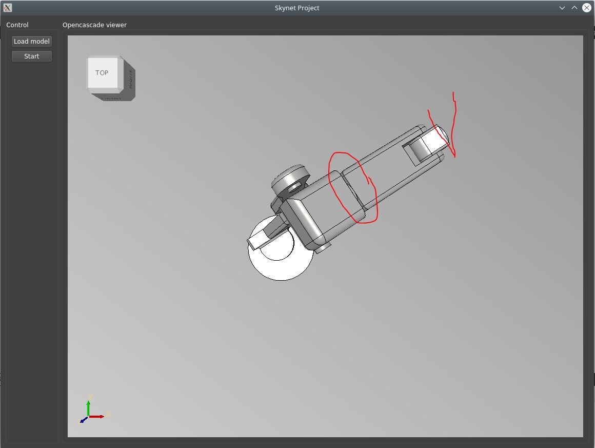

29 Oct 2021 17:23 #224664
by Dave3891
Replied by Dave3891 on topic hal-core
Hi Grotius,
I was able to get the origin points on my model and the kinematics values sorted out for my robot. I also changed the waypoints in the program to make a basic square, but I noticed an issue.
It looks like one of the joints isn't rotating to keep the face parallel with the coordinates.
Here are some images of the problem.
Also is using the kinematics in the qt project the current best way to go? Or should I be using the hal kinematics module? What about sending positions? Keep using the MotionVec.push_back? Or is there another way?
Thanks for all your help with the project.

29 Oct 2021 21:29 #224679
by Grotius
Hi Dave,
It looks like one of the kinematic values isn't correct. Tiny problem.
Check this kdl values with the robot document and compare it to your fanuc arcmate datasheet.
To learn how it works, it's a good starting point. The example is compact and transparant to see how things are done.
Hal_kinematics is integrated to Hal_opencascade. Hal_opencascade
would be your next starting point. You can off cource try Hal_opencascade any time you want.
But understanding the code is more difficult then your current example.
The motionvec is just a databucket used by the example. In real life the robot will follow a motion planner or something like
that.
The example of Hal_opencascade used Lcnc as the motion planner.
I see from the ./runtest it is based on the /opt/linuxcnc install.
To install this version, get it here. The dependencies for lcnc are written down here : dependencies
Your second picture has the correct robot start position. Try go get the Forward Kinematic "FK" xyz start position coordinates.
This is one of the first initialized parameters by KDL and you can check them with your drawing.
In "IK" mode, inverse kinematic mode, the face should be kept parallel indeed. In "FK" mode, that's not the case.
Oke, try to get the robot working. And if you spent more then 4 hours, pass me the robot datasheet if you have one.
