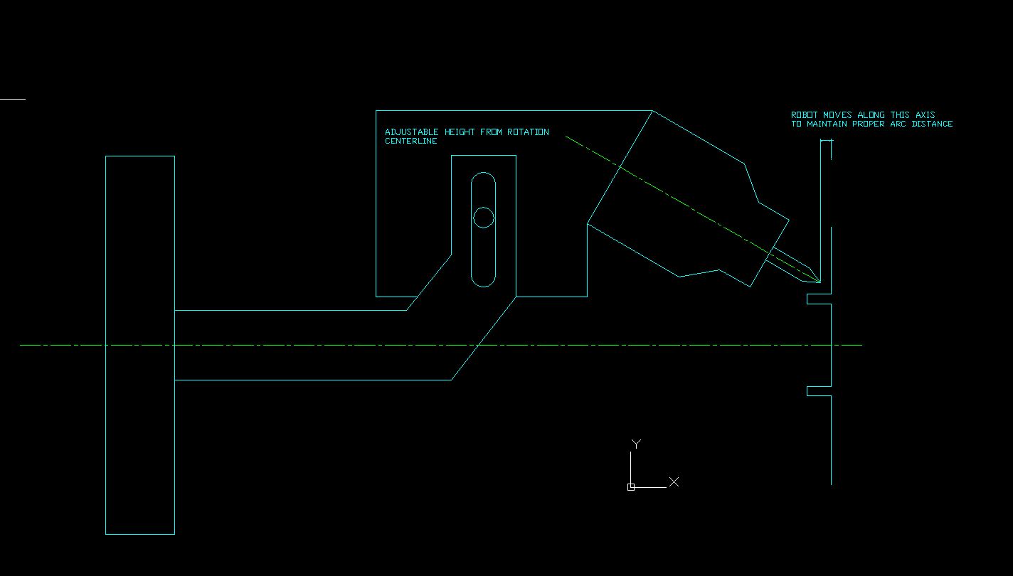

I have some different mesa hardware that I need to wire in to the robot before I can test it. The current hardware is the 7c80 with a raspberry pi, but I had boot up power problems with that so I switched to a normal PC and an ethernet card. This will have more rendering/processing power as well.
I can bench test the boards before I wire them in the machine to simulate the motion though to keep the project on track.
So the way I currently have the welding head setup is:
- The welding amperage is set on the welding machine
- Wire feeder is a DC motor connected to a drive to the mesa card and set with HAL
- Robot moves to the estimated hole location
- A 3D probe is used to center the welding head to the tube
- Welding feed is with the 6th axis rotation
- TIG tungsten to weld puddle distance is adjusted automatically by monitoring the arc voltage with a mesa ADC and adjusting the X position to maintain the setting
- There is also a preheat/postheat stage that strikes the arc and waits a set amount of time before the wire will start feeding in the weld and the rotation starts.
Hope that makes sense

Hi Dave,
The pendant is ok. It can be connected to hal.
From now on if you want to get the latest code, just download the latest release. It's precompiled.
The tig torch is not in line with the robot flange. If you want to move in tig torch direction, we have to add a extra 7th "fake" axis.
Then you could also do a torch height control from that perspective. Torch height control in heat-exchanger x-direction is not
a optimal solution.

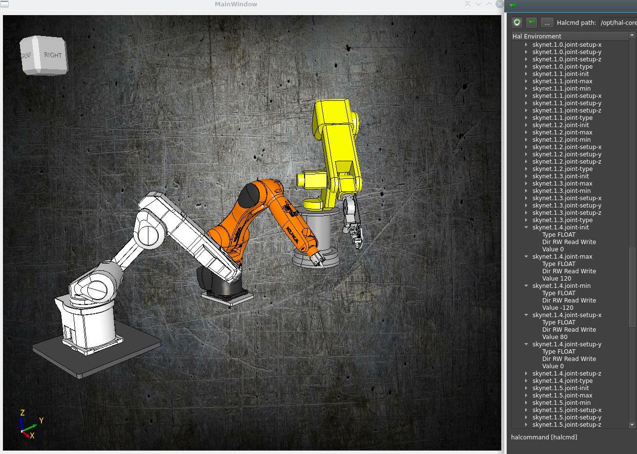

Just a hal-core update.
I started coding from the bottom trough hal, kinematics and opencascade.
A few day's are past.
What i learned is to use dynamic memory allocating in a c coded hal component.
Then i was able to setup a dynamic realtime program. Where you can add multiple robots or gantry's at the same time.
The shape of the machine doens't matter. The machines may even be stacked to each other. The kinematics models can be
stacked and moved around in 3d realtime, connected to the previous 3d node in hal this is possible.
This is really a crazy program.
All my previous code was not dynamic in c. Also the kinematic c++ code was not dynamic for a machine setup.
As far as i am now, This is becoming amazing.
I had to apply some rules to the hal setup, like how do you call machine 0 and machine 1?
How do you organize stepfiles for different models to load etc.

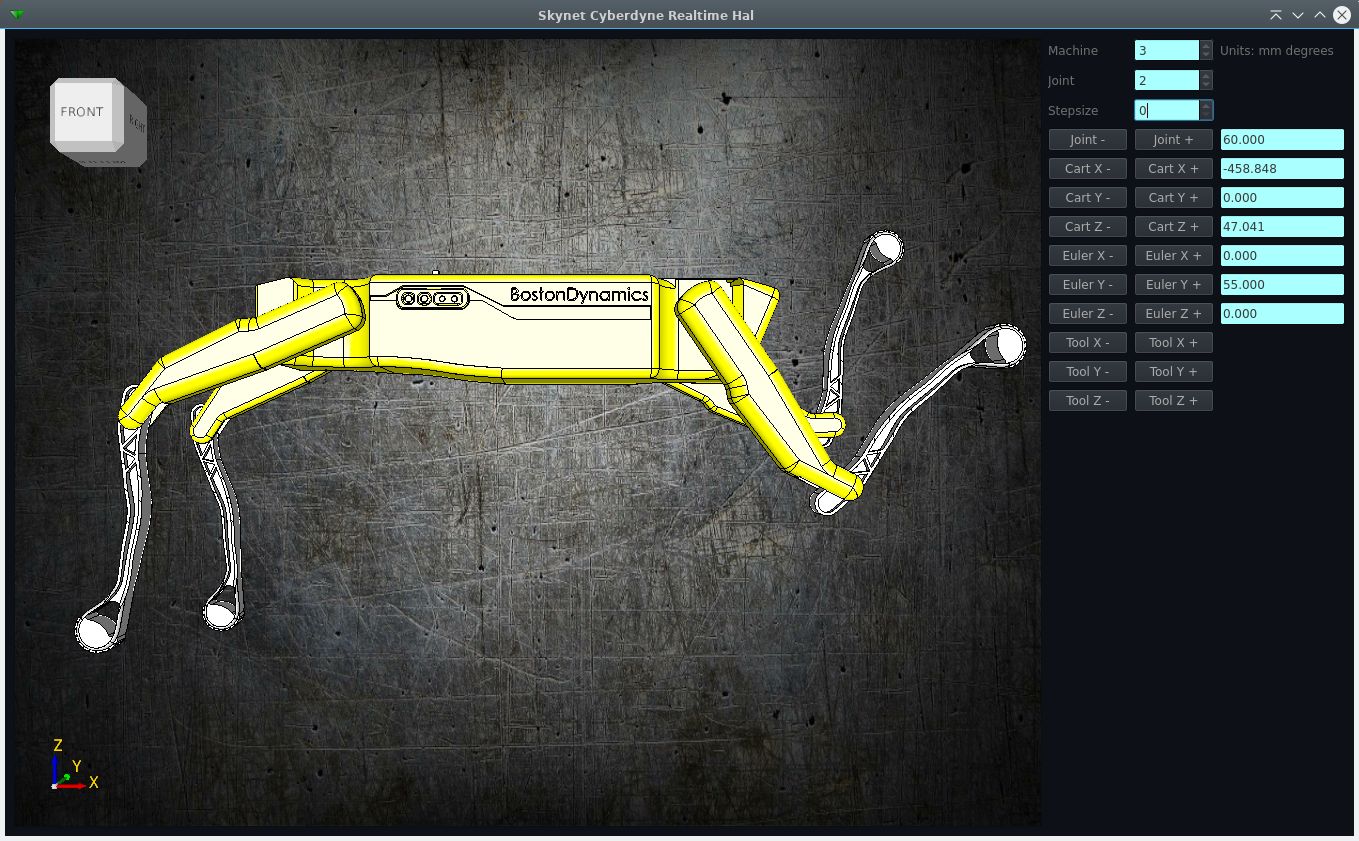

This is a hal-core example of a boston dynamics robot dog. It is equiped with a stack of 4 dynamic kinematic chains.
Each chain representing a dog's leg. The dog can be equipped with secundairy robots on his back wich are slave nodes, connected by 6 hal parameters. Translation + 3d rotate.
The robot dog can perform a s-curve motion profile for the leg's. I think this is a proof of concept hal-core is working dynamicly and
can do complex tasks.
Next item to test is a chirurgical robot operation implementation with hal-core.
By this i mean 2 robot humaniod hands reflecting the real human positions. The data is then transferred trough a internet connection. So i have to make a internet interface for hal-core.
