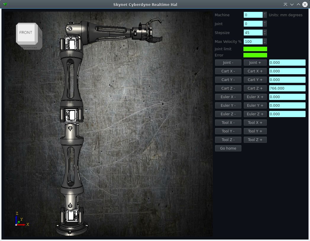

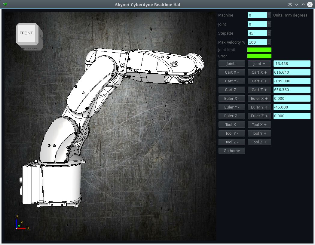

@ Dave,
That is looking really great! There will be a lot more automation applications that it could be use on.
Yes yes. The current code is dynamic. It doesn't matter how the machine looks like. It automaticly setups the
kinematic chain and hal pins etc. Everything is now more or less automated.
But it was hard working to get here.
I added some examples to hal-core and a new code archive : github.com/grotius-cnc/hal-core/releases
The novabot is interesting. The kinematics of the novabot is interesting.
The 5 axis cnc uses 2 kinematic chains.

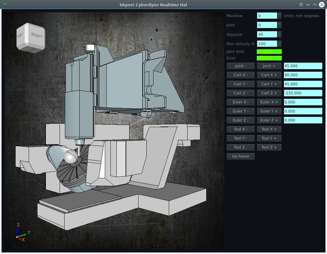

I just added a 5 axis cnc concept with a 6'th positioned toolaxis.
It can drill in a 3d tooldirection by jogging.
This type of machine is most used by plasma, laser, milling etc.
From this example i will go and finish the motion planner.
user-images.githubusercontent.com/448801...93f-bb8093ccdb41.mp4

- Dave3891
- Posts: 56
- Thank you received: 7
16 Nov 2021 04:19 #226620
by Dave3891
Replied by Dave3891 on topic hal-core
That's pretty cool how it can work with pretty much any machine, makes me want to add 2 more axis to my foam router!

Hi Dave,
Building that on your machine requires capabilities for sure.
That's pretty cool how it can work with pretty much any machine.
Yeah.
Video of 5 axis cnc now including jog motion based on the ruckig scurve lib.
It costed me extra time to get it working correct on all fronts. I had to find a needle in a haystack. But it works now.
user-images.githubusercontent.com/448801...a10-24c6f8bb7cf0.mp4

- Dave3891
- Posts: 56
16 Nov 2021 21:24 #226680
by Dave3891
Hi Grotius,
Looking at your latest code release. Is everything done with the skynet hal module now?
Does the skynet module output the required position pins that you would connect to a stepgen module? Or does it need a accel/decel planner in between?

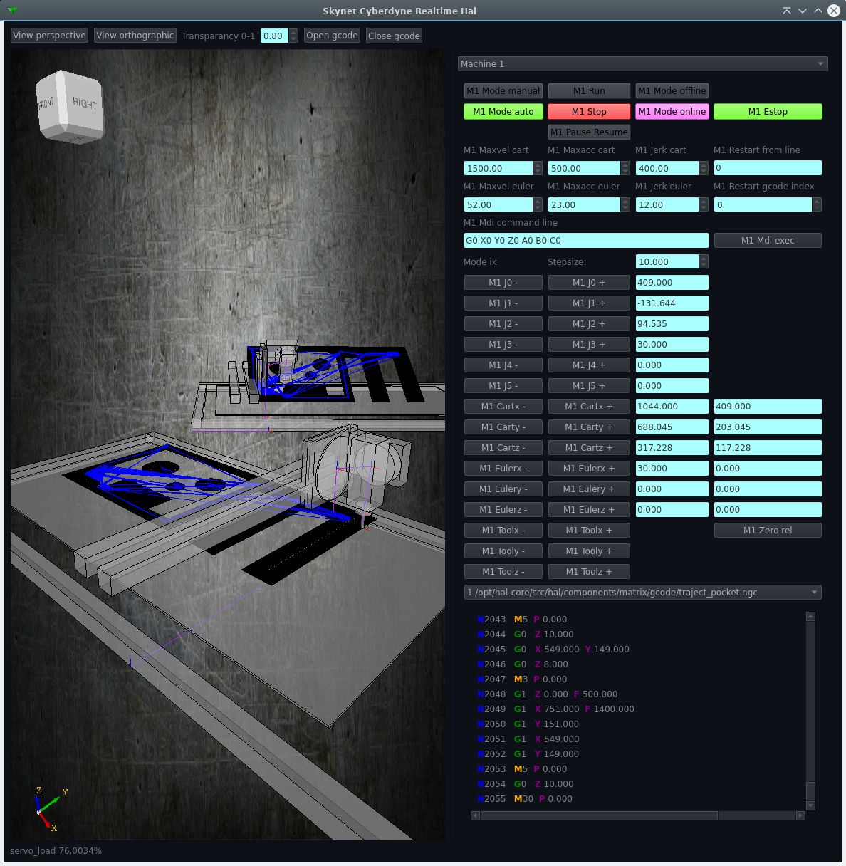

A tiny update for hal-core.
I recorded 2 machines moving at the same time.
The program is build up using dynamic memory in the hal component.
I recoded parts of the kdl kinematics, the ruckig trajectory, the gcode parser etc.
Now close to programming the gcode runner.
video link
mention the servo-load, lower left of window. This indicates the actual load of the servo thread.
video link
Last edit: 05 Dec 2021 00:38 by Grotius.

A tiny update. The gcode runner is now captured on video.
The program has loaded a standard .ngc gcode file. This file is then placed in 3d on the machine table.
The machine has to follow. If you have a good look at the path's you can see the path follow error is visible.
This is when the joint velocity, acceleration and jerk are set to low. In fact the machine xyz speeds are to high. But
nice to mention this.
Then there is no path optimization for the end velocity at the moment. It now stops at every gcode line. This off course
has to change.
a video:
user-images.githubusercontent.com/448801...94b-2b6bf52af1aa.mp4
The servo-load, lower left of the window, is glad not ticking far over the 100% load.
I have a old pc. So it can not get much worse than this.
And a video of doing a gcode pocket program. 2000+ gcode lines to being exec. for each machine.
a cool video:
user-images.githubusercontent.com/448801...308-38a88b8f102a.mp4
