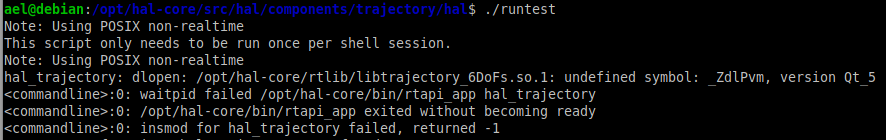

Hi Dave,
The quickest way to solve this, is to recomplie the qt part of trajectory component with your qt version.
This type of errors can be caused by a qt library change. Or it can not find the qt libraries.
You can add a : ldconfig ./ path to qt library in the trajectory startup script.

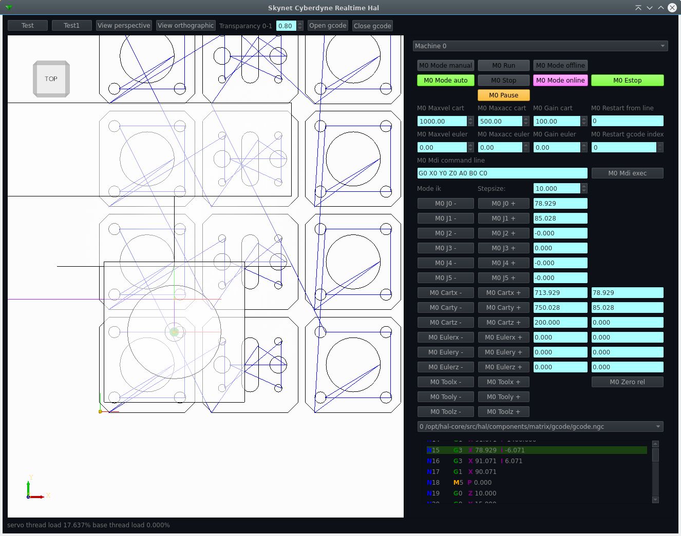

Just did a archive update for hal-core.
The update is showing the matrix component doing a gcode motion.
The motion is done by a new trajectory planner i am coding at the moment.
I had difficult times to code this. Mainly trough the user interupts like velocity changes during runtime in combination
with a new scurve library.
A short video
- The trajectory planner has the s-curve implementation.
- It accepts acceleration changes during runtime.
- It accepts velocity changes during runtime.
- It can do a forward motion trajectory.
- It can do a reversed motion trajectory.

A tiny update.
I am soon at the point it is usable software for motion planning.
Some effort is done to get the source code nice and clean.
It's still possible to load multiple machines at the same time, including separate gcode and motion at the same time.
I coded every machine as a stand alone widget. Then the program load's an instance of the widget, like "machine 1=new widget"
The gcode can be rotated and placed on the machine bed in 3d.
The machine will follow the 3d gcode positions relative.
The machine can be a robot, a gantry or a exotic kinematic model.
The entire program is just one hal-component, in this case called "matrix.so"
I have to code some parts yet. But the diffuculties are behind us now !
