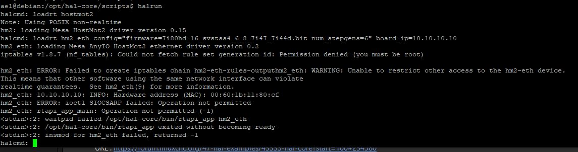

I am also unable to use the mesa ethernet module, I can load the hostmot2 without issue, but I can't use the hm2_eth due to looks like some kind of permissions issue?

Did you edit and perform the runtest file of the hm2_eth file?
~/opt/hal-core/src/hal/components/hm2_eth/./runtest
I can not test it myself, i have no mesa.
The "could not fetch" warning is a warning outside of hal-core. I think pcw know's what's going on here.
the /usr/sbin/iptables is a root dir.
See hm2_eth.c line 464

11 Feb 2022 16:21 #234585
by Dave3891
Replied by Dave3891 on topic hal-core
Yes, but the runtest is missing loadrt hostmot2 before the loadrt hm2_eth.
Once I add that I get the same errors

Maybe first get the mesa going. Then we solve the pendant.
If you start hal-core as root. Maybe it helps?
user@debian10:/opt/hal-core/scripts$ sudo su
root@debian10:/opt/hal-core/scripts# . ./rip-environment
