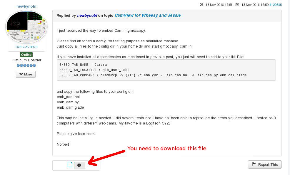

emb_cam.hal
emb_cam.py
emb_cam.glade
Which are 3 files needed by this command in the .ini file:
EMBED_TAB_COMMAND = gladevcp -x {XID} -c emb_cam -H emb_cam.hal -u emb_cam.py emb_cam.glade
The "here" link points me back to this message, and is a loop I've been around twice now. But despite a couple hours of searching this forum under an even broader search, I have not found a link to download a package containing those files.
Consequently its impossible for me to report success or failure as you requested.
They do not exist in any other cam* file I have downloaded and unpacked so far.
What I am asking is where can I source those 3 files listed in this thread? Also shown as part of the EMBED_TAB_COMMAND above.

Gene,
the thread i mentioned, has attached a zip file. You need to download the file, unpack it and in the resulting config folder you will find the mentioned files.
Norbert
Norbert

Replied by Gene1934 on topic CamView for Wheesy and Jessie
Norbert was kind enough to pm me the files, and a jpg showing where the download was at. But I don't click on unlabeled buttons. Can this lack of button labels be addressed?
