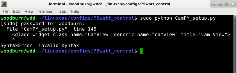

well you're right i din't installed camview. I installed the campy module on page 2 of this thread from Bogie. Thats exactly what i did the last time. I think its just called CamPy but is a updated camview to run under wheezy
OK, I see that now. Nothing at all to do with this
Can you check that camview.py found its way to the right place? (from a previous post:)
copy
camview.py
hal_python.xml
hal_pythonplugin.py
to /usr/lib/pymodules/python2.7/gladevcp
and also to
/usr/share/pyshared/gladevcp

Ok that seems to be the problem. The Files are in the right place but camview.py is marked with a red cross and is empty. But i cant just copy the files into the folder because i dont get root rights. I tried to copy the files as root via the terminal but that didnt worked. How can i copy these files ?

02 Sep 2019 21:43 #143956 by andypugh
Replied by andypugh on topic CamView for Wheesy and Jessie
You probably meed to just run
sudo ./CamPY_setup.py
02 Sep 2019 22:12 #143960 by FedX
Replied by FedX on topic CamView for Wheesy and Jessie
Nothing worked so i re installed Linux and did evereything from the beginning now it works..
Thank you even If i really dont know where the Problem was..

I have completely set up linuxcnc two times now and I get the same error every time. can someone help me?
Thanks.
