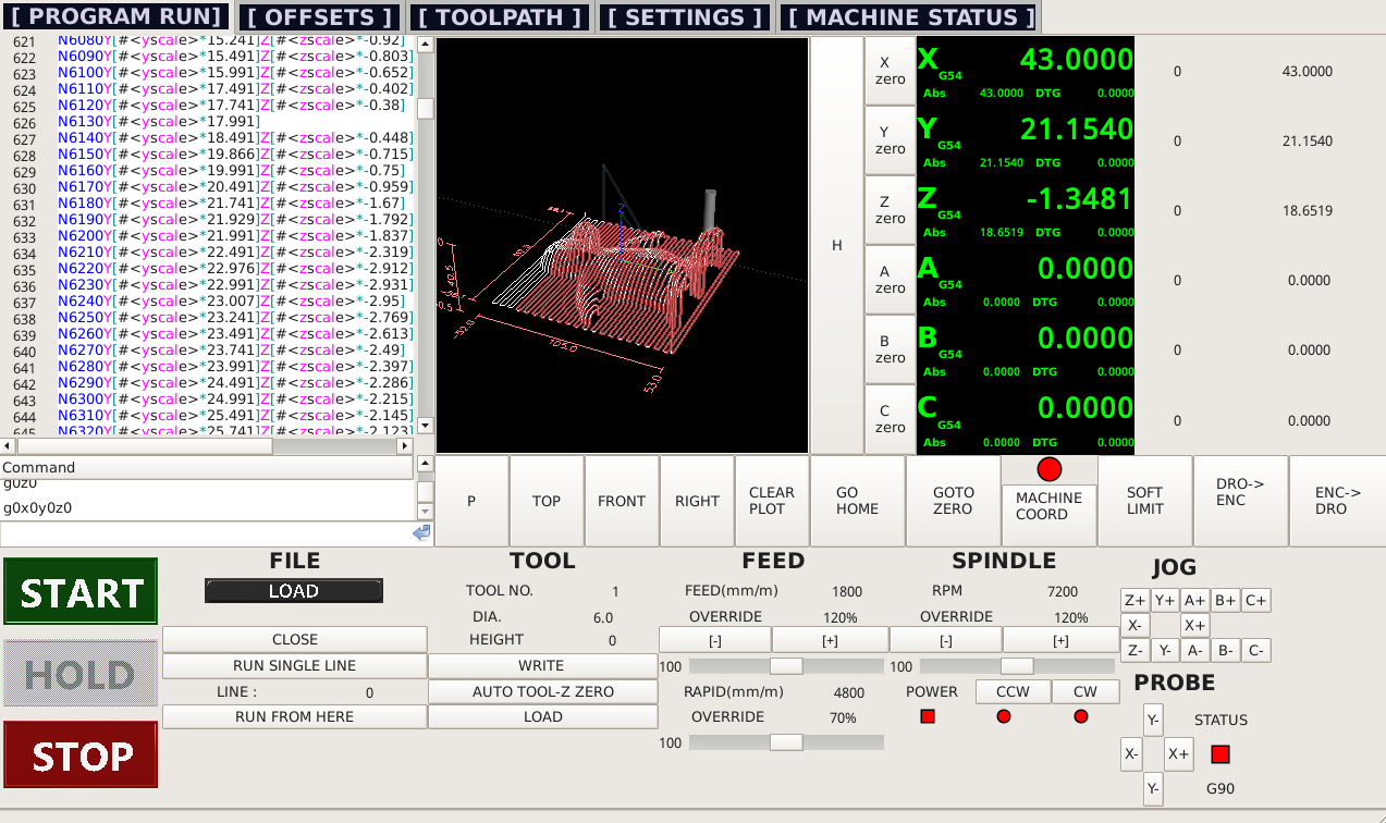

Hey guyz,
noob here,
I have installed .iso distribution, and installed 2.8 pre, updated to most recent version and trying many things inside virtual machine.
Currently using Mach3/ESS/AC servos and I think my next build would be LCNC+digital servos with mesa cards.
One of the things I mostly would like to do is to build a new GUI.
I've been reading related articles - glade, gladevcp and so on - for many days now and I think it might be doable even though slow and tedious, love to chhallenge..
BTW, I don't mean to be very professional or commercial-like. I am not skillful enough to implement all the stuffs.
- not quite familiar with HAL structure and programming languages yet
Attached is a draft using glade(with yellowish icon, I read this is the right version for the task)
it is only partially working at the moment.
A few questions here - and yes, these can be very stupid ones to experts' eyes
- Can I make most of status windows as mouse-clickable/input directly enabled? like, click DRO and input numbers using keyboards or click tool number window and input 2, like that. If yes, does it involve lots of programming or simply by using widgets? I played with some widgets but nothing seems to be ready for direct input to that window
- Can I use custom image icons for all major click buttons? (I believe I can)
: and then, should I need to make two images as one set for unpressed/pressed status when clicking mouse?
- Can I use background images for the DRO and other status windows? like a green LCD window (or some other colors, not hurting eyes but still can grab eyes)
- image label applicable to notebook tab labels?

Hey Kevin.
Those are not low grade questions.
In general, your creativity, skill and mostly time, are the real limiting factors in screen building.
Making widgets clickable to enter data is possible but most are not built that way in gladevcp.
So you could build new or update old widget for this or use event windows to catch clicks and call functions.
This would be some of programming, but probably more time spent learning how to put the bits together.
generally I would suggest using themes for images on buttons etc - particularly if there are lots to do.
You can also do it programmatically. Usually there needs to be images for on/off/un-sensitive and sometime 'pre-light'
It depends on how the widgets works - you can sometimes get away with images for on/off and just darken it for un-sensitive state.
I am pretty sure you could add images as backgrounds to most widgets (programically) changing the color is possible.
Details depend on the widget.
- image label applicable to notebook tab labels? Not exactly sure what you mean but if it means can you add images to notebook tabs - yes just delete the label and add a image widget.
I will also add that in master there is a new screen building system Qtvcp. Similar idea to Gladevcp but uses QT instead of GTK.
Qtvcp is still being developed and I would be interested in ideas about needed widgets etc.
GladeVCP is Getting difficult to support moving forward - eventualy we will need to make some choices about it - probably in a few years.

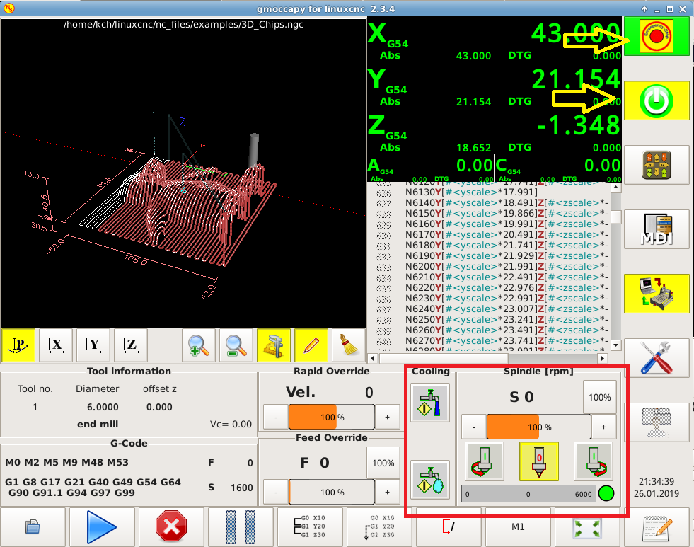

Most Stuff you asked is realized in gmoccapy, so i recommend to play a little bit with the sim configs and check the code of gmoccapy.py. Imho that can give you a good start and as it is open source, feel free to use my code
The following user(s) said Thank You: KevKim

I just realized that you are the author of that screen,
tyvm for your effort.
I have certain ideas but skills are not supporting ideas...sad..
I'll definitely look into the codes you made.

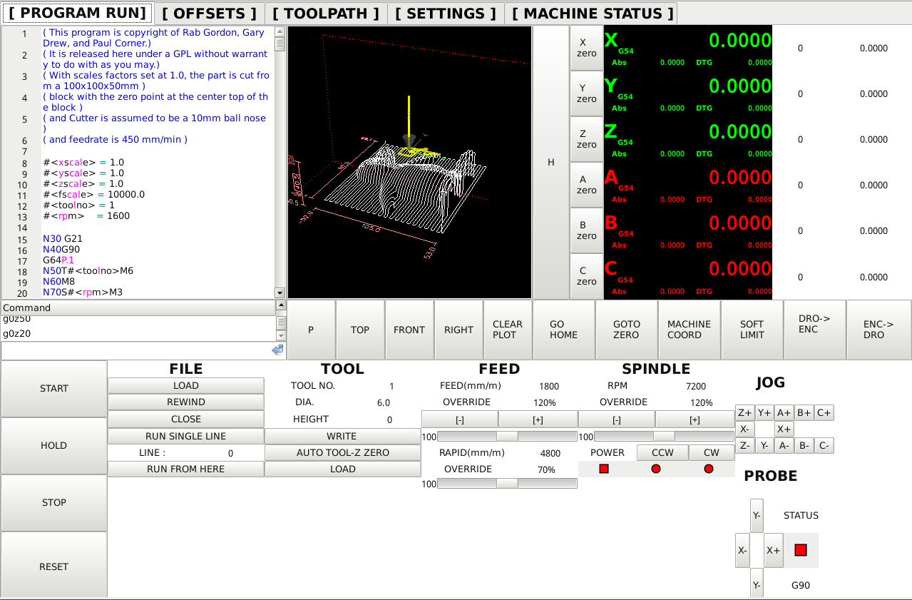

I had some progress , figured out some necessary stuffs.
Modified stock led.py to have horizontal/vertical slim type shape at number 3 & 4 which was easy once I figured where the files are located.
And I am currently drawing graphical elements one by one.
While looking into your gmoccapy.glade, there is one thing I can't quite understand how action was done.
power/estop buttons in your screen changes to another shape when toggled,
I couldn't make that action happen in my screen.
Can you briefly explain the sequence please?
This surely involves image swapping when toggle is triggered but I can't find proper location to initiate this option and their relationship.
TYVM

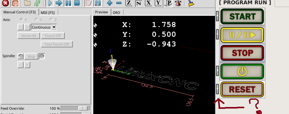

I think I am my wit's end for now.
I designed some buttons, and tried some hal leds and I can't figure out how to connect them to each button.
I followed John's tutorial and all other available documents in LCNC sites but to a noob like me, documents are missing something.
I guess mytestui.py needs something to make this connection, is this correct?
