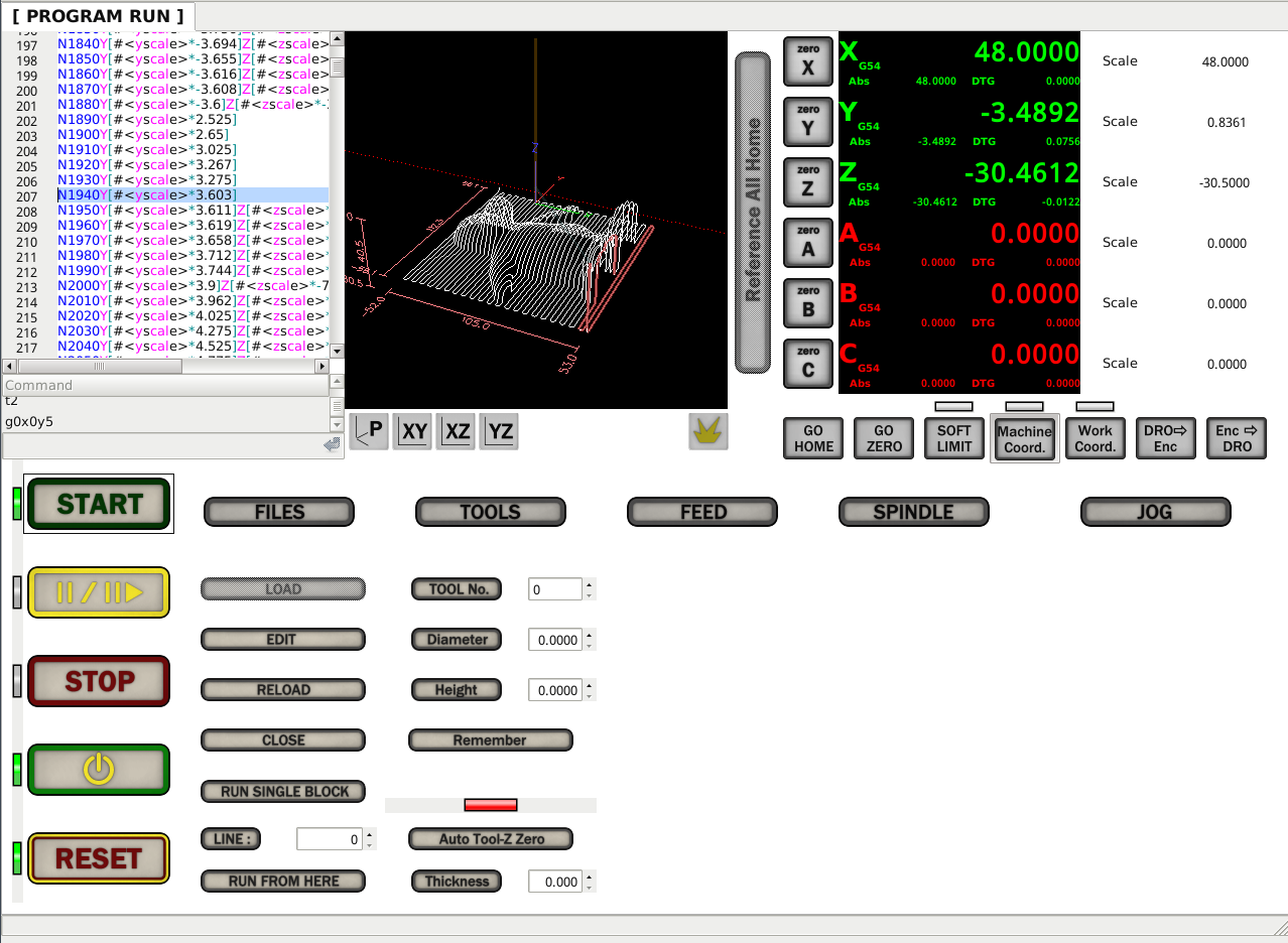

How hard is it to build a completely new standalone GUI?

29 Jan 2019 08:05 #125140
by KevKim
Replied by KevKim on topic How hard is it to build a completely new standalone GUI?
hey,
tnx for the comment, I'll check that too.
Building buttons is slower than I thought.
I could see gscreen sample uses spinbox to enter <run from here> input, but I couldn't find .hal file for that,
I couldn't catch the flow/necessary pin or action to implement that.
That also applies to all input window in tool/spindle/feedrate.
When linuxcnc system sends rpm/feed/tool info, do I use status_label or what?
I will post all files once I think main page is flooded

29 Jan 2019 08:19 #125141
Replied by cmorley on topic How hard is it to build a completely new standalone GUI?
Motion controller commands that are beyond what the Gladevcp actions offer, must be coded. Gscreen probably has some functions already coded so you would need to call those functions. - documents are lacking. You can gleam some info about Gscreen functions by: in a terminal type 'gscreen -F | less'
Or else you code them yourself with python using the linuxcnc library:
linuxcnc.org/docs/devel/html/config/python-interface.html
Motion controller status can be had by using status_label widgets or by using the GSTAT library and using python code.
linuxcnc.org/docs/devel/html/gui/GStat.html
The docs for GSTAT are behind - there are more options now.
The status_label widgets are new and could be extended for more options - I was lazy when i build them for someone else.
Welcome to a deep rabbit hole
Chris M

29 Jan 2019 09:10 #125145
by KevKim
O great,
good to learn that the handler file is for that purpose - I didn't know hehe
Yes, ofc, I want to maximize the use of widgets, its only because widgets do not provide very detailed GUI controls, then two choices, either giving up some stuffs or looking for alternatives if available, and I am trying to judge if this approach would be feasible or not at my level of knowledge.
Now I think I get some idea of how I should treat this, it is never light and can never be done in a week. To learn more about its functional flow, can you give a favor to show me an example on how to call a very simple python code with a GTK_button made inside glade editor? That would be a stepstone for me to learn how this will work.
O btw, I just found one big secret.....
(I blame who developed python grammar..)
The reason of previous errors, I mean themes, notify, etc, was INDENT!!!
I can't believe this.... All looked same to my eyes, space or tab, but python distinguishes it. Damn it, who's idea is this !!!!!!!
