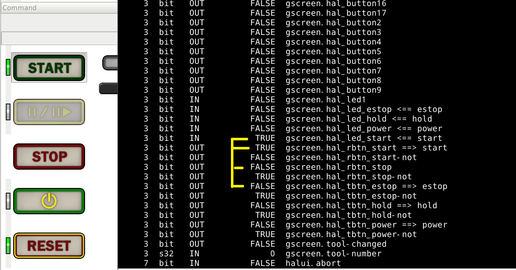

28 Jan 2019 07:50 - 28 Jan 2019 07:52 #125047
by KevKim
Replied by KevKim on topic How hard is it to build a completely new standalone GUI?
Here is a certain initialization trouble with button status.
this is the first screen after launch
Start button in set to <active>
while stop is inactive,
and estop is inactive,
all by default.
In glade editor, I didn't touch their initial status. All are set to NO for the initial status.
So, I tried to change some status, like YES for Estop and Stop button - not only button, widget itself too
, it didn't work.
I thought about manually putting each value (setp) as initial status but then error message saying button pin is NOT writable.
So what would be a good way to overcome the situation?
desired initial status is
- estop ON
- power OFF
- stop ON
- hold OFF
- start OFF (start/stop are marked as one radio button group, so stop=ON will make start=OFF automatically, just my thinking)
kevin
ps. postgui file has only 4 lines;
net power gscreen.hal_led_power <= gscreen.hal_tbtn_power
net estop gscreen.hal_led_estop <= gscreen.hal_tbtn_estop
net hold gscreen.hal_led_hold <= gscreen.hal_tbtn_hold
net start gscreen.hal_led_start <= gscreen.hal_rbtn_start

28 Jan 2019 07:59 - 28 Jan 2019 08:01 #125048
by KevKim
changed .ini to XYZ 3joints machine, now problem gone for the gui building - temporarily
I am totally happy with those slim-rectangular leds, it may have thickness option for maximum versatility but I am good with it for now.
I guess other ppl will like that too!!
Waiting for any response on how to set initial status of each button.
O, one more thing that I need help.
Now LCNC messages - like warnings - appear on top-right corner and they build up unless I manually click each of them.
Can I contain system messages inside <status bar> at the bottom of the main window? it is very annoying.

28 Jan 2019 08:18 #125049
Replied by cmorley on topic How hard is it to build a completely new standalone GUI?
You could invert the on/off colors of the leds to match initial state.
Ultimately it would probably be better for the LEDs to be connected to linuxcnc state directly - but that can come later.
(in Qtvcp there are state_leds that follow linuxcnc's state - no HAL pins)
I will look into how to disconnect the notify messages...
Chris M

28 Jan 2019 08:22 #125050

28 Jan 2019 08:44 #125052
I'll have to look at why the start button isn't disabled at start up all by it's self.
You could put it inside a hal_state_sesitive_table and set all the options on:
must be idle, must be homed, must be on.
To rid your self of the notify message:
open the my_gui_handler.py file
look for the function:
change it to this:
run the screen once (it will still notify)
now in your home file open the file:
.gscreen_preferences
it's a hidden file so you may need to set show hiddden file in your file manager.
now in that file look for:
desktop_notify = True
set it to False and save the file.
Now notify will not show.
If you add a statusbar named statusbar1to your Screen it will get those messages instead.

28 Jan 2019 08:51 - 28 Jan 2019 08:53 #125053
by KevKim
hey Chris,
You know what?
Once things are running, it is getting more and more interesting and exciting!
Now, I think I found a permanent solution to the above ON/OFF at initiation trouble.
After looked into all hal pins monitored by halmeter, I changed buttons to normal momentary switches and modified .hal file as belows;
net power gscreen.hal_led_power <= halui.machine.is-on
net hold gscreen.hal_led_hold <= halui.program.is-paused
net start gscreen.hal_led_start <= halui.program.is-running
As of now, led gets signal directly from halui so it does not rely on button status any more. Likewise, I want to replace estop led too but so far I couldn't figure out which pin emits estop <true> signal. Instead, I could see in <signal tab> there actually is the estop but I don't know proper syntax to inject that signal directly into led pin. Will you give me a hint plz?

28 Jan 2019 08:57 #125054
Yes that works too.
if you change form action_run to toggleaction_run the button will change sensitivity based on state.
toggle actions will control sensitivity
actions will not
Chris

28 Jan 2019 09:00 #125055
halui.estop.is-activated would work for the estop LED
