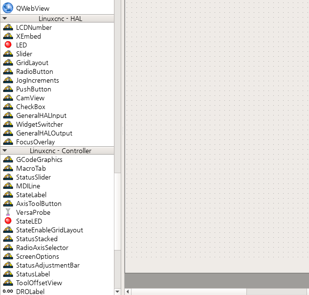

I have managed to do the followings since last login;
- installed debian 9 64bit + rt-preempt kernel patch
- compiled/installed Lcnc -uspace, master 2.8, it runs good
- installed glade-gtk2, glade runs with Lcnc plugins, OK
- installed pyqt5-vcp, designer launches with the following error in console, is it OK to continue stuffs under these errors when starting? I can see LCNC widgets but most of icons are missing
I have attached all errors message when launching it in console,
$designer -qt=5
$designer -qt=5

Replied by cmorley on topic How hard is it to build a completely new standalone GUI?
Good job there - success!
if you see the widgets and Designer doesn't shutdown -you are golden.
The missing icon warnings and INI error messages are normal - you can ignore them.
The MDI_history error is new and it's because I've never tested on a clean machine with out running AXIS first apparently.
If you run AXIS and do an MDI command that error should go away. I'll fix it permanently on qtvcp's side soon.

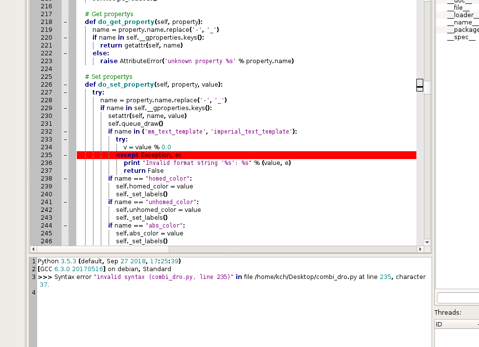

Yes, designer was launched without axis running.
IDE Eric was installed and ran just yesterday but for some reason that I do not know of, it simply refuses to be loaded, so I am clean-installing whole stuff again, I am becoming a master of installation by now.
One thing out of cuorisity :
It looks like python is a cross-platform language and quite standard-stuff, qt designer is run on python 3.5 and I found qtdesigner running on windows too, then can I simply copy those qtvcp_plugin.py into somewhere in windows environment and do the GUI development in windows? I am thinking of copying final result into Lcnc for execution only,
My first time into language stuffs, so I don't have knowledge/experience but glade forced me to think like this because that application is simply too unstable, crashes randomly and shut-down randomly without my permission >.<
you are there, ty for your quick attention.
- Posts: 7368
- Thank you received: 2181
01 Feb 2019 14:37 #125470
linuxcnc doesn't use python 3 - we in fact precompile the python2 libraries because they are not available anywhere.
I don't use windows for almost anything so i don't know if it will work - but I highly doubt it. you couldn't test the screens as HAL won't run on windows...
Chris M

02 Feb 2019 01:23 #125513
en.wikipedia.org/wiki/Eric_(software)#Su...t_for_Python_2_and_3
says any version 5.5.0 on should be able to edit python 2 code.
I don't use a IDE so can't really help you.
Chris M
Anyone farmiliar with ERIC IDE?
It loads python3 and I can't find anything related how to change it to use python2.7
Installed IDLE for the time being
Chris M

02 Feb 2019 01:33 #125515
by KevKim
Replied by KevKim on topic How hard is it to build a completely new standalone GUI?
ty Chris,
Google told me Eric5 is with QT4, is that okay for the job?
Further problem is that I don't see any download link of previous Eric version, so be it... I would have to use something else...
