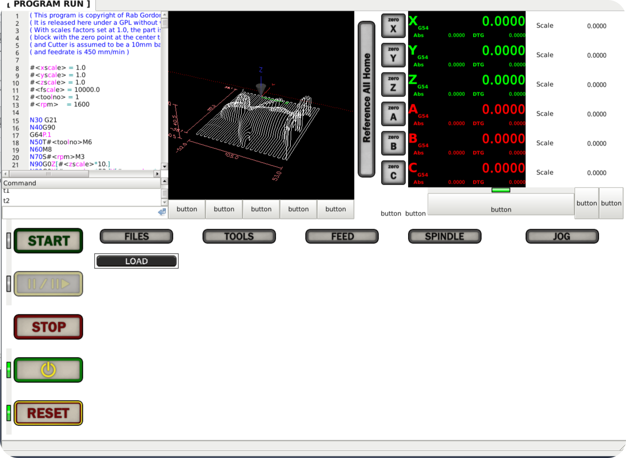

28 Jan 2019 09:12 - 28 Jan 2019 09:14 #125058
by KevKim
PERFECT!!!

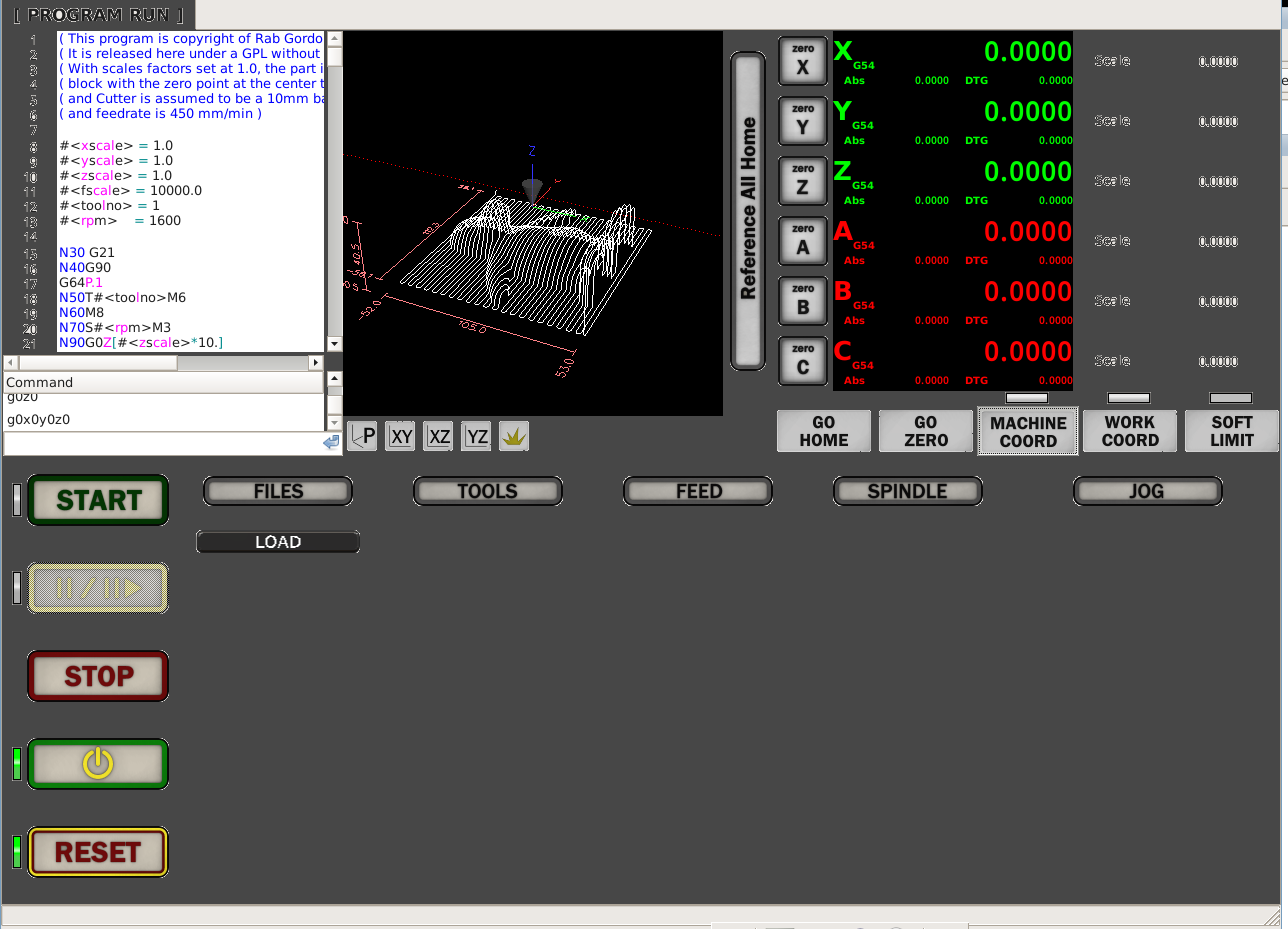

All operation buttons are replaced with momentary switches, vcp actions are working very nice together with leds!!! TY!
It's time to continue button image work
Replied by KevKim on topic How hard is it to build a completely new standalone GUI?
halui.estop.is-activated would work for the estop LED
PERFECT!!!

Made some more button images, upper part of page1 is almost done.
Yes, final goal is to be mach-like screen, or maybe I can call it tormach-like, whatever.
I wonder if there are pins to indicate in which coord system machine is on between machine coord/non-machine coord.
That would be desirable to have.
I found motion.on-soft-limit pin, though its not clear at the moment what this exactly means, I need some hal functions to set & indicate whether soft limit is on or not.
Btw, how would I fill the entire workspace with a color? I want to fill whole area with some dark grey color like the example, that would be good for eyes. - I just filled it in windows paint brush.
If you look at themes, you can switch system colors. You can concider to use this text into your gscreen code, it's a dark theme example :
self.settings = gtk.settings_get_default()
self.settings.set_property("gtk-theme-name", "Adwaita-dark")
In your case it can be :
self.gscreen.settings, or some text, but first try above.
If you want to switch background color in glade, you can do that. But if i want to do that, i would make a new linux theme i think.
That option is located in your system file, just google the source location.

28 Jan 2019 22:24 #125112
Replied by cmorley on topic How hard is it to build a completely new standalone GUI?
Theme is the best way to change the background.
You can change the theme is the preference file;
gtk_theme = Redmond
You's have to build a custom theme or download a suitable dark theme.
As for motion.on-soft-limit pin (True when the machine has tripped a soft limit - not a hard limit), I would use python code to read the pin. This saves you from connecting a bunch of HAL pins in a separate file.
In the tester_handler file find the function:
change it to:
Then add the relevantly named LED on to your screen.
Chris M
gtk_theme = Redmond
def periodic(self):
passchange it to:
def periodic(self):
value = hal.get_value("motion.on-soft-limit")
self.widgets.hal_led_soft_limit.set_active(value)Chris M

29 Jan 2019 02:39 #125124
by KevKim
ty grotius & Chris, I'll try that themes stuff definitely.
BTW, my desired function keys under dro are like these;
- go home : go to machine home, probably available through .ngc macro
- go zero : go to work zero of current work offset, probably available through .ngc macro
- soft limit : toggle activate/deactivate soft-limitation of all axis, useful when setting up machine travel to see how far it can go under operator's responsibility ( I have no idea if this is available by simple macro/widget/hal call)
- soft-limit led : shows current status of soft-limit active/inactive, green for ON, red for OFF
- machine coord&led : sets DRO to machine-coord display and shows its status, green for ON, grey for inactive
- work coord & led : sets DRO to (current) work-coord display, radio button group with together machine coord (or if technically possible, can make just one toggle to show if it is in machine coord display or not)
- dro2enc : overwrites current DRO to encoder DRO, will be possible using LCNC variables and .ngc macro
- enc2dro : overwrites DRO backward, these last two functions are quite useful that I modified my Mach3 screen like this. I use servo and made a circuit board to read enc report from servo amp, its mentally comfortable to see it always, and also useful to go back to certain coord when something (or zeroing by mistake) happened, it can help to go back to previous position without too much hassle
So, I'll try to implement such stuffs, however, if something brings too much complex or sophisticated modification then I may drop a few stuffs. If you can add several python codes, that would be nice too. I'll upload whole pack from time to time for ppl who feel interest in this project. Needless to say, I am too ambitious ;p
regards,
kevin

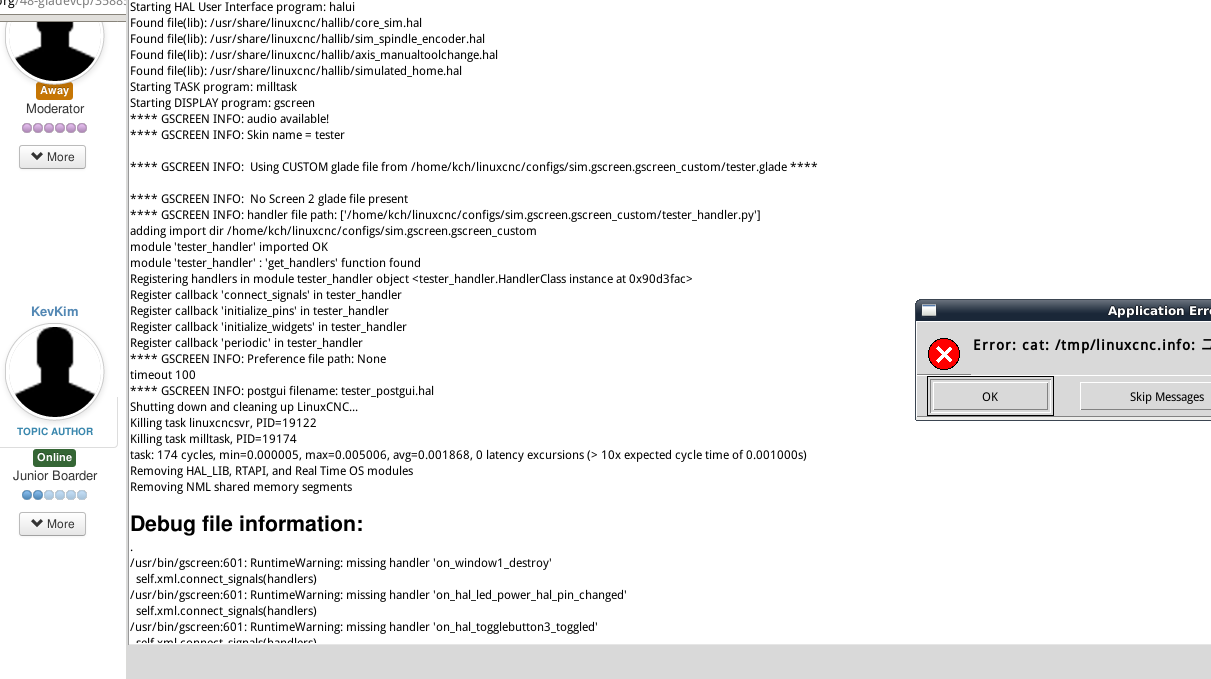

29 Jan 2019 06:49 #125134
Sorry that doesn't give enough information to diagnosis the error.
What does the dialog say and what does the end of the debug info say?
