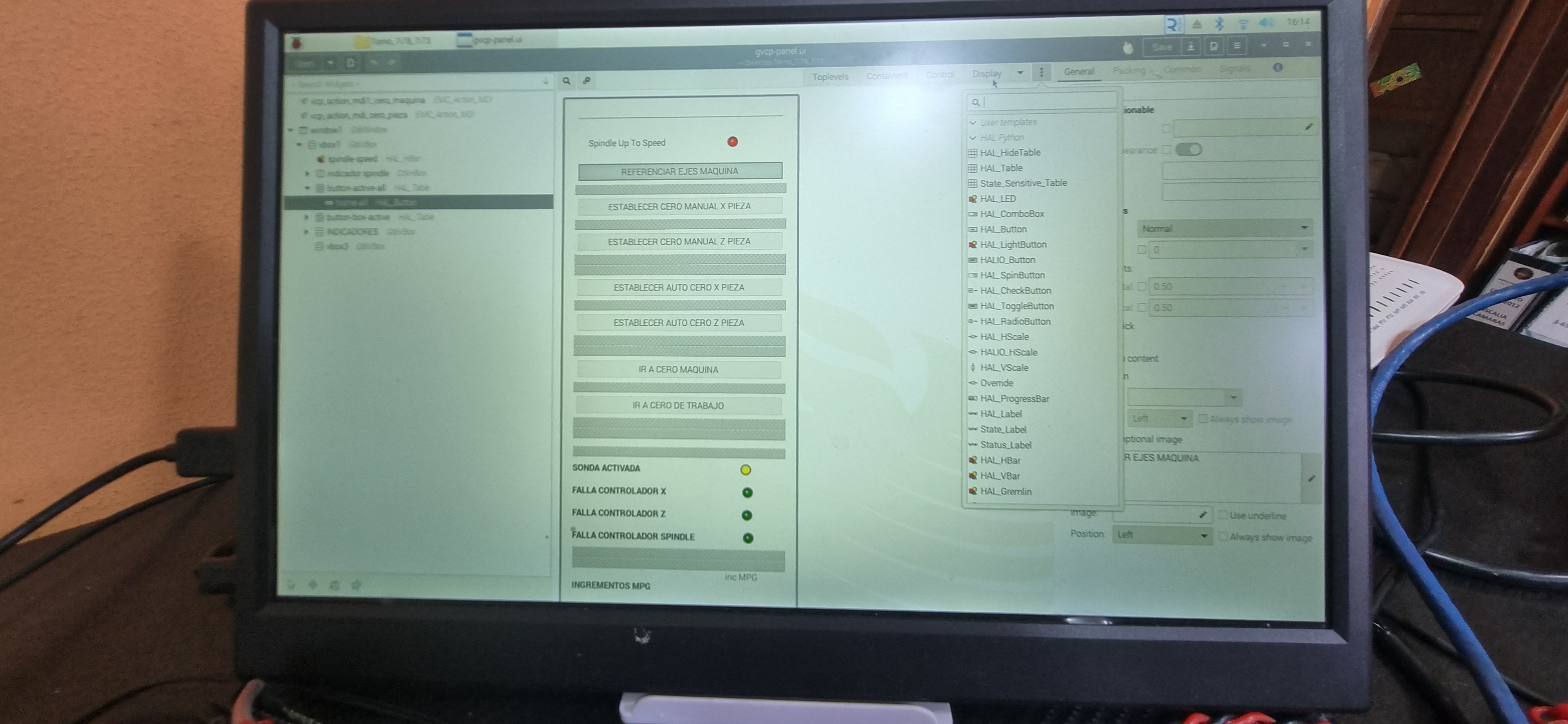

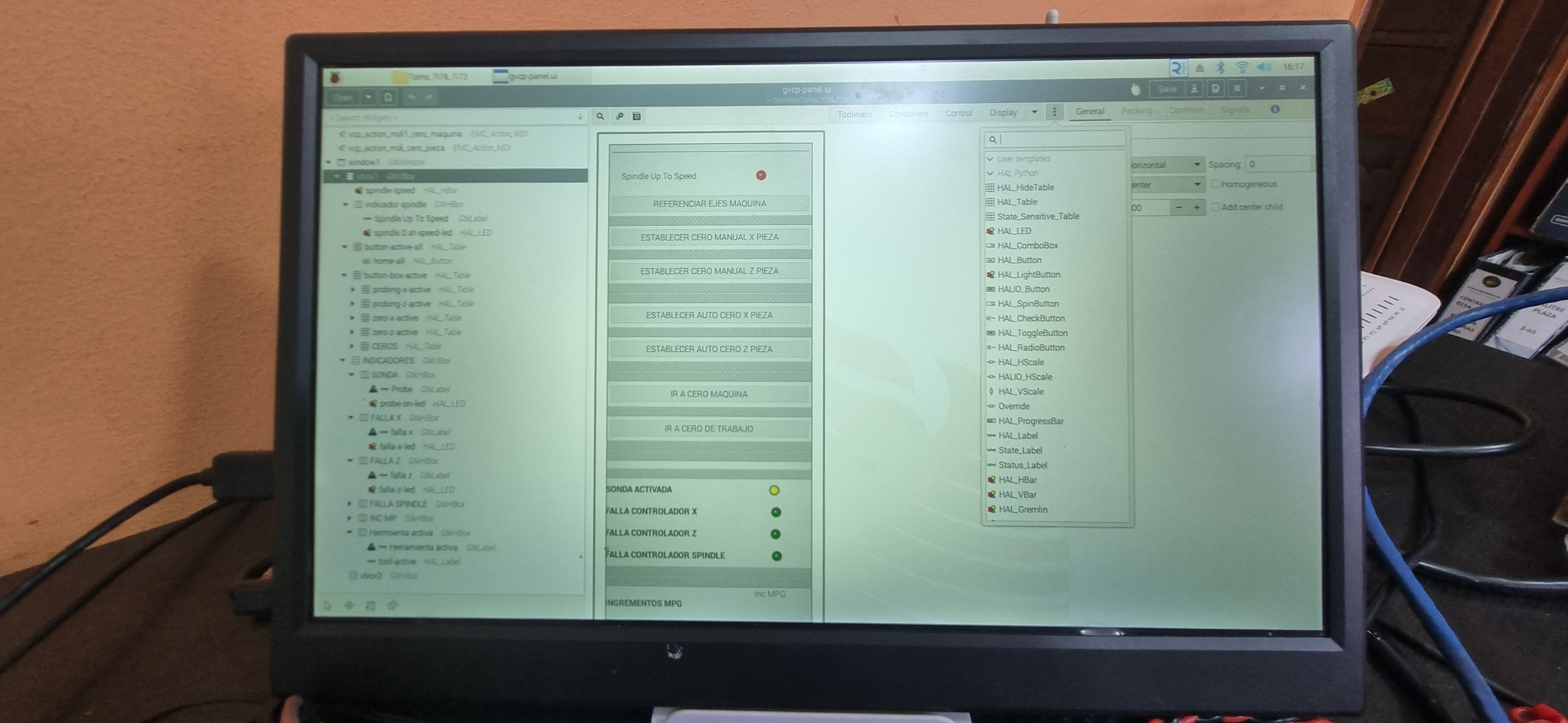

Thank you for your prompt response.
It looks like I was in error thinking that
<!-- interface-requires gladevcp 0.0 -->
<!-- interface-naming-policy project-wide -->
was a comment. Removing these two lines allowed the hal.ui to load into the glade IDE. It then displays a box but doesn't show the button and LED.
In either case that's not the point. If the Glade IDE requires a 'catalog' then what I'm asking is how to tell the Glade IDE where the 'catalog' is for linux CNC and what it consists of.
I can pull over any folders I need from the Raspberry Pi4 that can run LinuxCNC. And BTW, it throws up the same error when I run Glade on it.
So my question remains the same. The Glade IDE screen designer requires a path to a folder or set of folders in order to be able to load the icons and appropriate HAL connections.
So where are they for the 'simple' example hal.ui. If it can't figure out how to show the items described in the hal.ui then it certainly can't do the AXIS screen.

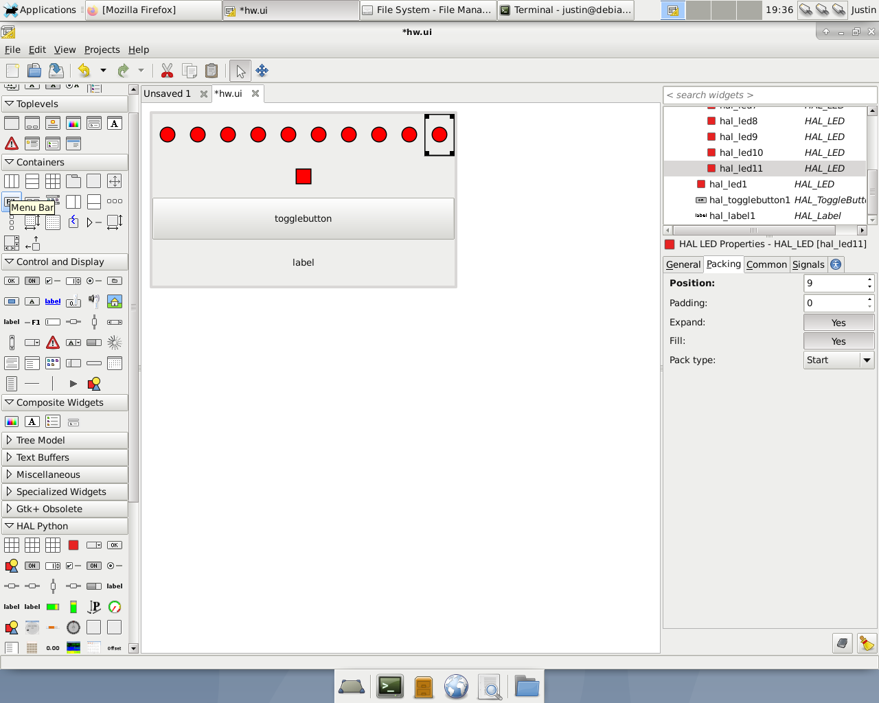

11 Aug 2023 23:50 #277686
by blazini36

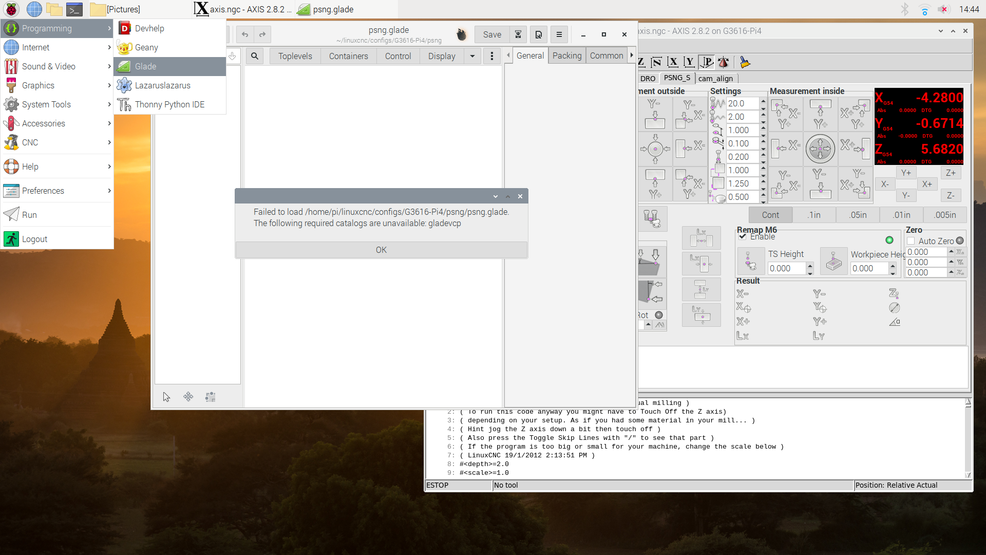

You just tried to open a file created with glade-gtk2 inside of a version of glade that uses GTK3 or GTK4.....ya know how I know? Because of that wierd little icon to the left of the save button.
I took 10 minutes to install a Debian buster ISO inside of a virtualbox VM just to show you how this works, I expect a thanks.
On your Raspberry Pi with LinuxCNC installed run "sudo apt install glade-gtk2" Not "glade" that is the recent package, I told you what you are trying to do is ancient and you need legacy glade.
Anyway on my fresh Debian Buster/ LinuxCNC VM install I ran "sudo apt install glade-gtk2". Then I ran "glade-3" to open it. You should probably understand that glade "version 3" does not mean it is for GTK3. Glade version 3.8.6 and below is for GTK2 and that is what you want to use. What you are trying to use in your screenshot is a version higher than 3.8.6.....ya know how I know?......
I can add 10 more LEDs if I really want to......
See the "HAL Python" widgets in the lower left? If you don't see those you aren't opening that file.

Makes no difference whether LinuxCNC is running or not. So why does this message show up?
Why is the catalog unavailable. It's now Linux. Running LinuxCNC. Running Glade trying to load psng.glade which BTW, is shown on the LinuxCNC axis panel.

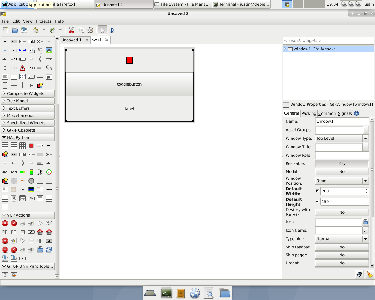

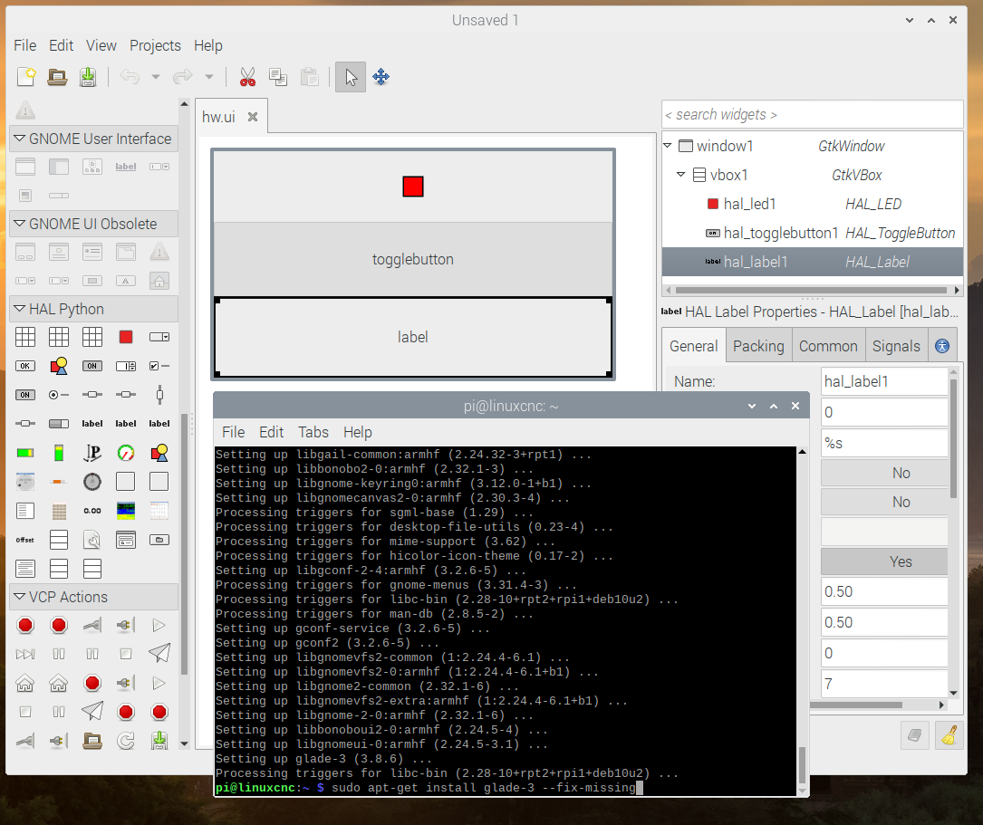

12 Aug 2023 21:22 #277757
by jcdammeyer
Replied by jcdammeyer on topic gladevcp catalog, and other questions
Andy Pugh provided the correct answer! forum.linuxcnc.org/48-gladevcp/40971-how...-get-gladevcp#196434
To get the older version of Glade for the Pi LinuxCNC one must install Glade-3 after doing a
sudo apt-get update and although I don't know if it made difference before the update I also did a
sudo apt-get dist-update.
After that, as the screen shows.
sudo apt-get glade-3 --fix-missing.
Without the --fix-missing it won't install.
And now I can run the helloworld example and see the hal LEDs etc.

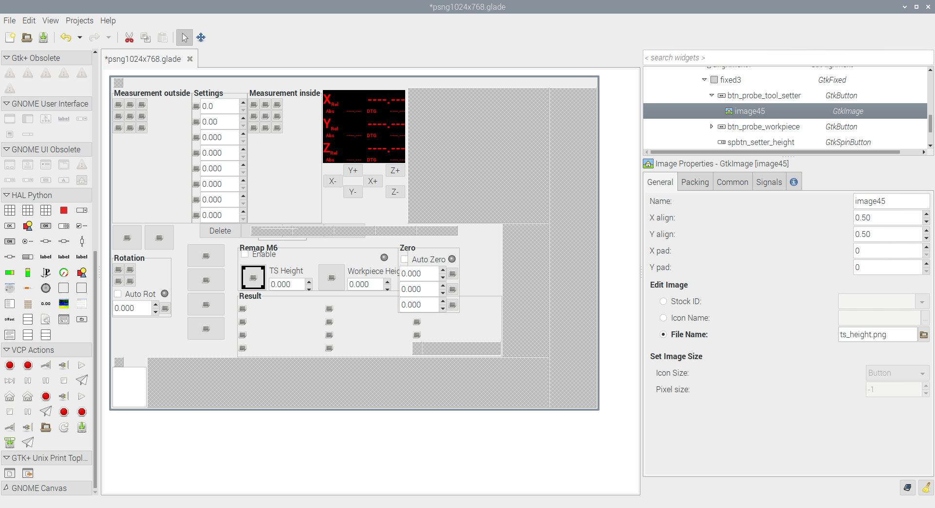

But there's still an issue as this next screen shot shows.
The buttons are there and the path to the icons are correct inside the structure describing the button. The Glade-3 IDE does a pretty crappy job of representing the glade file. Even the newer Glade version that Justin said wouldn't work does a better job of at least showing the icons even if it can't find the gladevcp.
At this point the pi4 is going to be put back into the cardboard storage box along with the new 1200x800 touch screen.
Thanks everyone,
John
