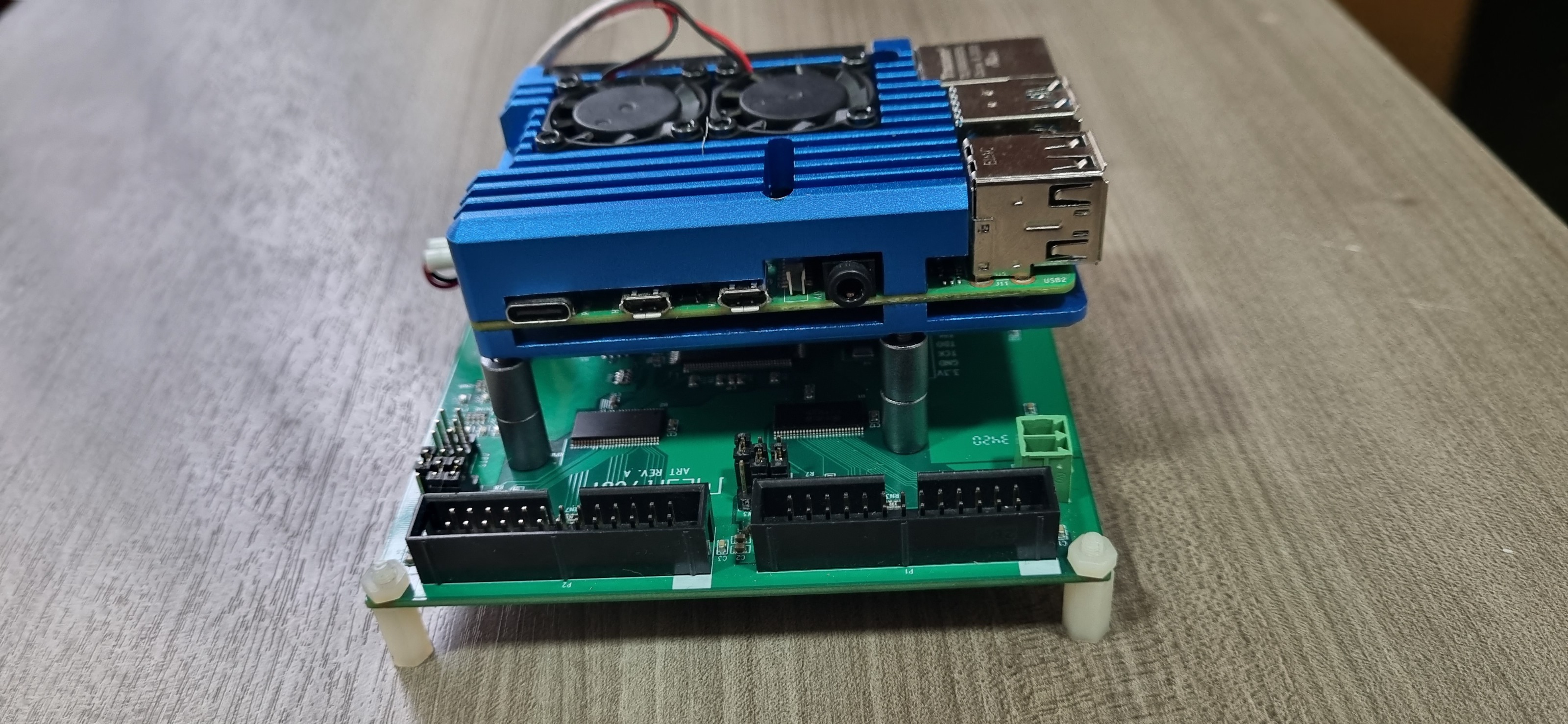

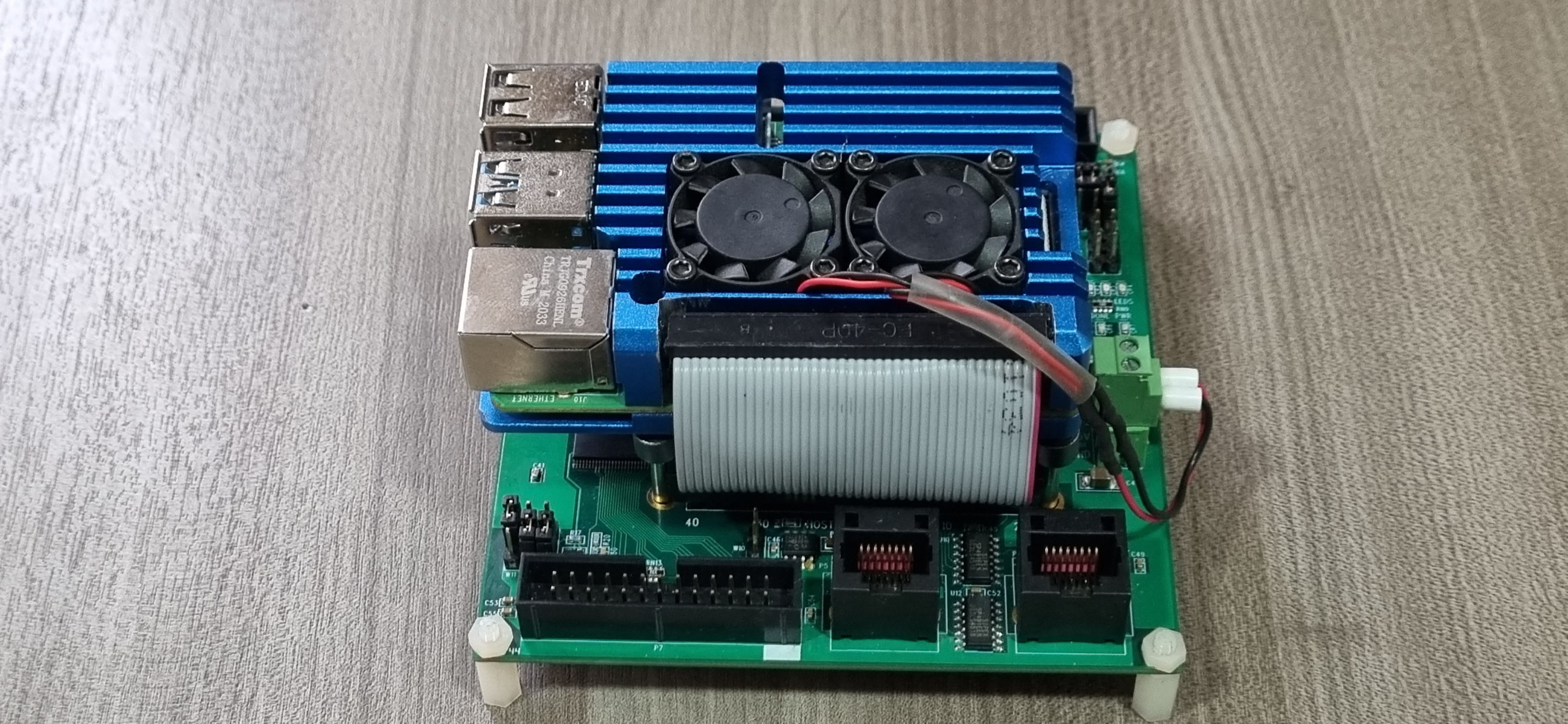

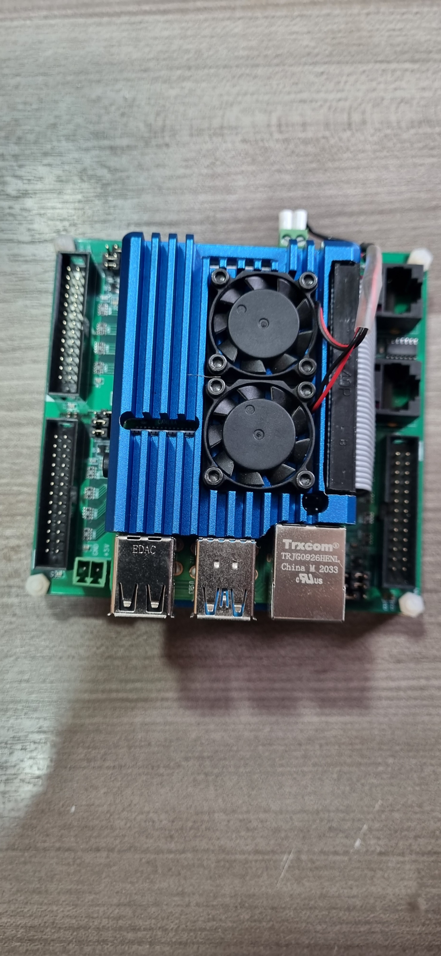

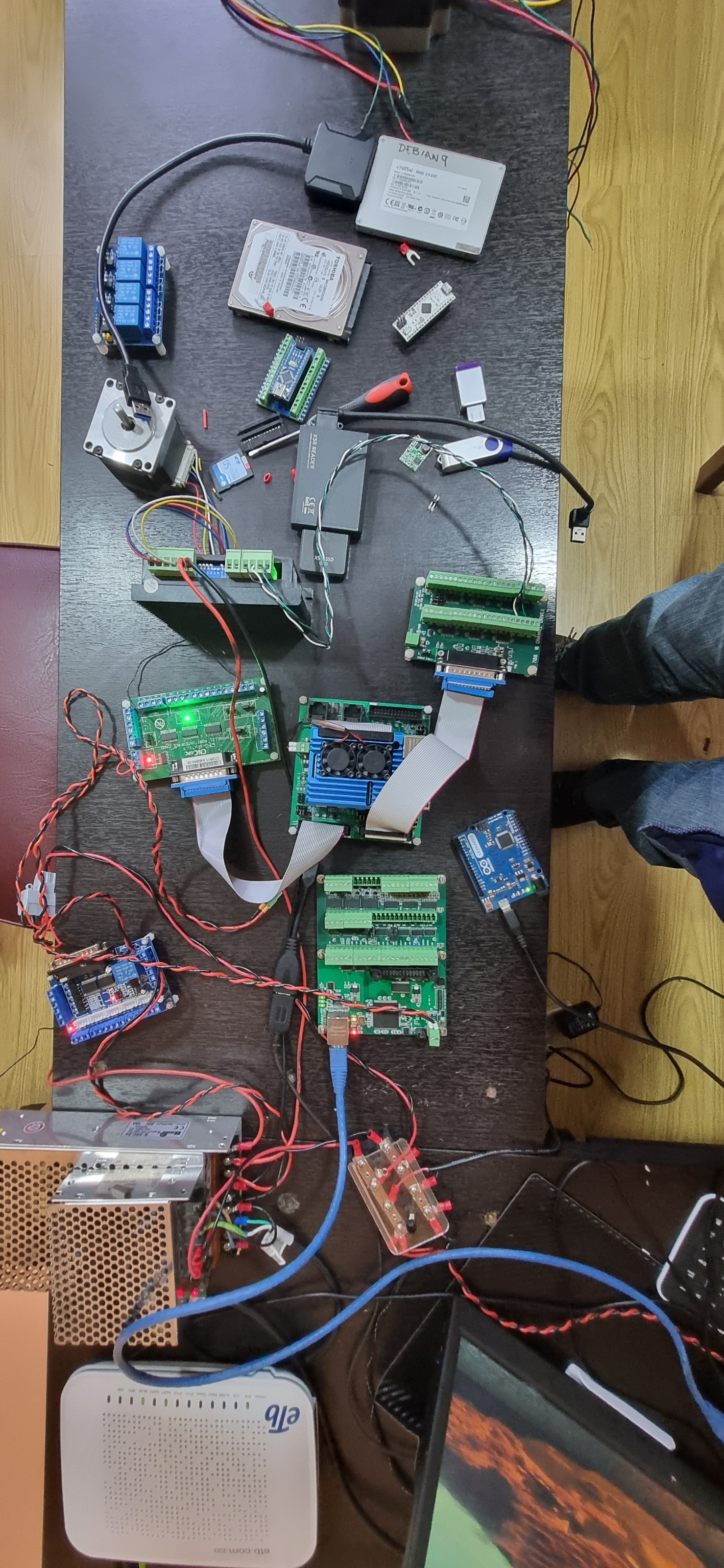

There's nothing wrong with you using a Raspberry Pi. You have Glade working and that's great.....But you cannot use Glade-GTK3 to open a file made with gladevcp for glade-GTK2I don't understand why I discard the PI4, I have my lathe working with one with 7i92, 7i88, 7i73, raspian 11, 64 bits, GLADE and everything works fine.
And I'm putting together another one with 7c81, 7i88, C10 and BOB 5 axis China.

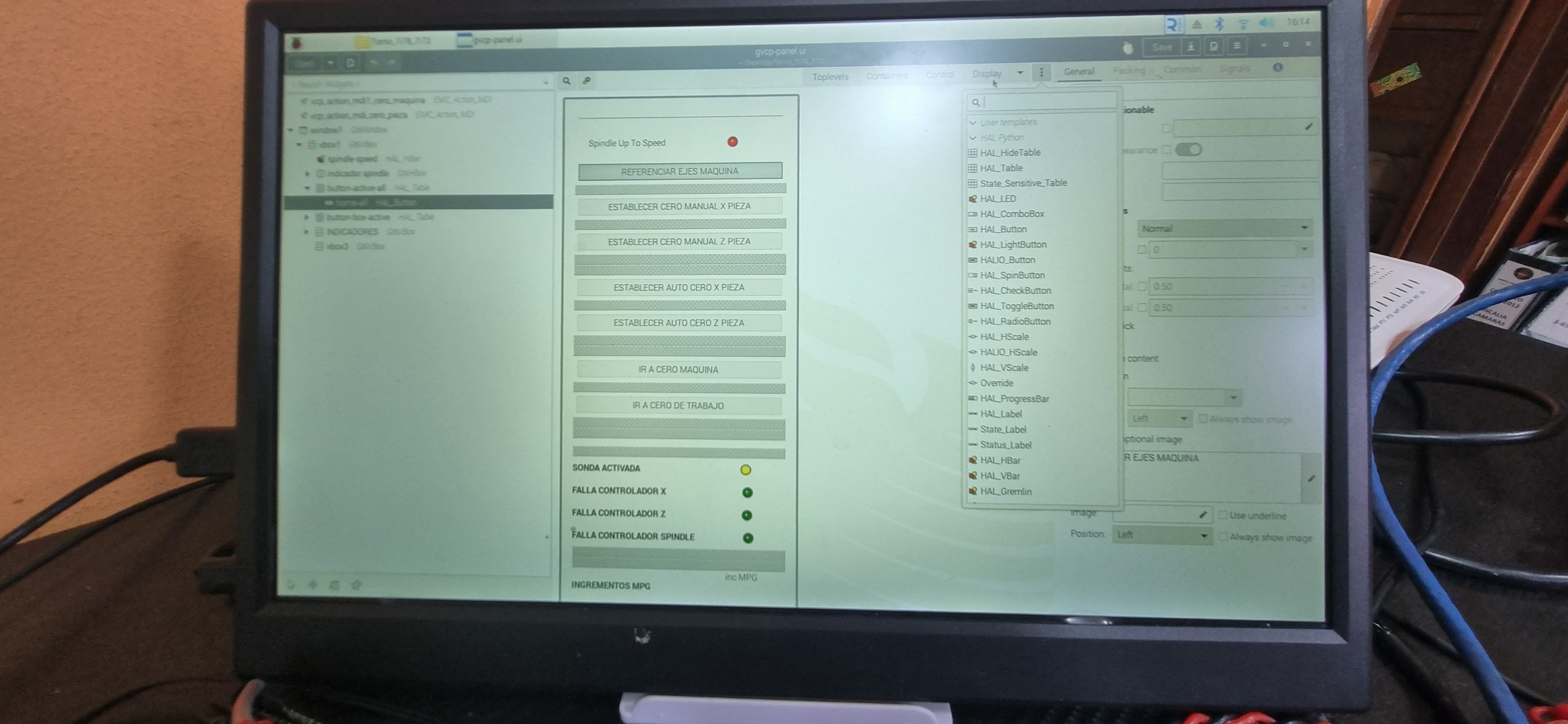

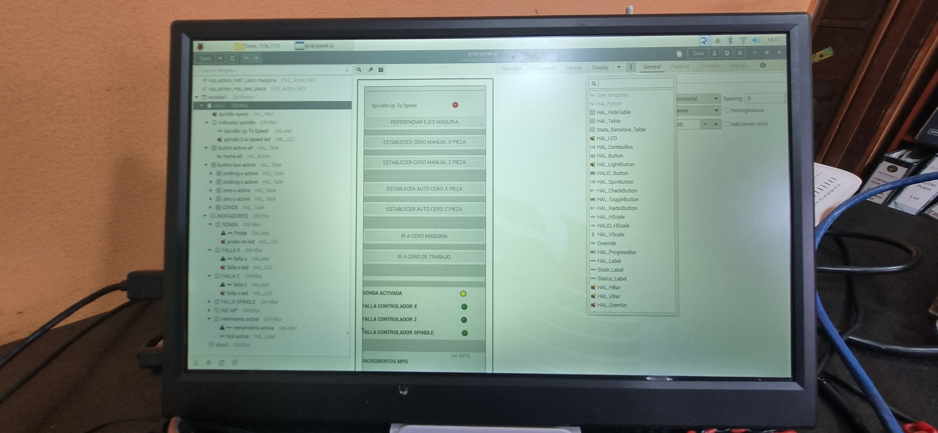

GLADE-GTK2 IS GLADE 3
GLADE-GTK3 is GLADE version above 3.8.6
Edit: You can open a glade gtk2 file with glade gtk3 these days. They must have added support in recent versions because horizontal and vertical boxes were depricated in earlier versions of GTK3 so that I take back....
but the main point here was you need linuxcnc's gladevcp environment to open a file with gladevcp widgets or else glade-gtk2 can't open it at all and glade-gtk3 just shows dead widgets
Replied by blazini36 on topic gladevcp catalog, and other questions
It is not true, I have created virtual panels in GLADE 3 and later, I have been able to edit them with GLADE 3, like what I am showing in GLADE 3, which were created with GLADE 2, the only thing is that some wigets have been decapitated.
