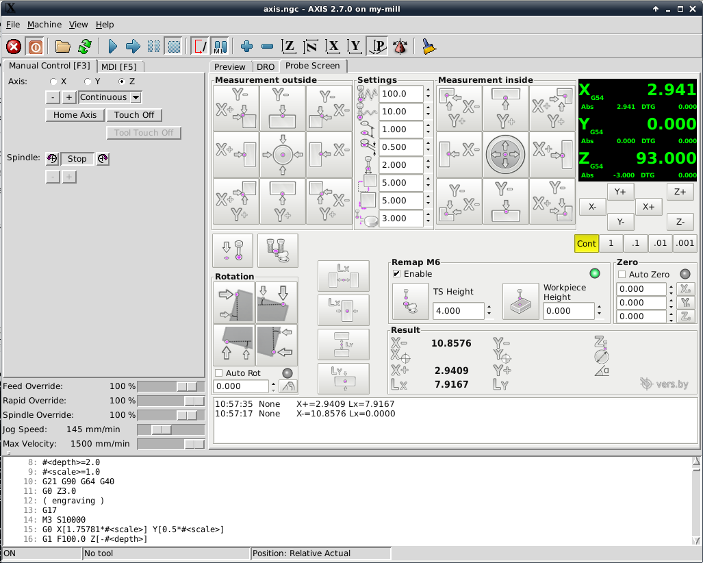

01 Nov 2018 15:25 #119765
by verser
Replied by verser on topic Work with probe
Update Probe Screen V2
Added:
- convenient control levers of movements without leaving the screen
- field with quick manual tool change settings (remap M6)
- measurement of tool diameter
- measurement of length-width inside-outside
- the mass of minor edits
Sources.
Added:
Sources.

27 Nov 2018 20:59 #121491
by FernV
Replied by FernV on topic Work with probe
Hi Serguei
On github.com/verser-git/probe_screen probe_screen.py is 10 months old and probe_screen.glade is 3 years old.
Where is Probe Screen V2 ?
Fern
Fern

28 Nov 2018 20:43 - 28 Nov 2018 21:01 #121550
by FernV
I installed V2 and after making a change in my .hal file fromtoit finally seems to work. I do not know if it is mentionned somewhere but now some users may find why it is not working.
It looks good and I think is a great addition.
However I had a case with Axis and NativeCAM did not load and the error was:
HAL : ERROR : duplicate component name 'gladevcp'
GLADE VCP ERROR :Asking for a HAL component using a name that already exists.
The fix was to change ini file fromtoor any other name
I noticed that with gmoccapy, when pressing a jog button and the screen change that it will jog until <esc> is pressed.
Also the spinbuttons do not accept the dot from the numeric keypad, a keydown callback like I did in NCAM could fix this.
I will fork your work and write a few patches, specially for the default values either for mm or inches (very simple)
Keep on your nice work
Fern
