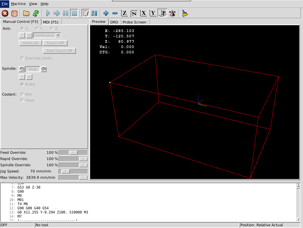

Replied by Ferdl on topic Work with probe
Hi all,
I'm facing with one problem. The Probe Screen V2 can be loaded and it seams to work. But if I load a gcode it will not be displayed in the axis Preview.
If I remove the M6 command in the gcode the tool path will be displayed...
Any idea what can be wrong? I saw from some user they having the same problem...

09 Mar 2019 11:41 #128155
by pl7i92
Replied by pl7i92 on topic Work with probe
the mauell toolchange is interfeard with the probescreen so M6 is inconsist at this moment they are working to solve this
be patiant within the next 14 days or so it may be fixed

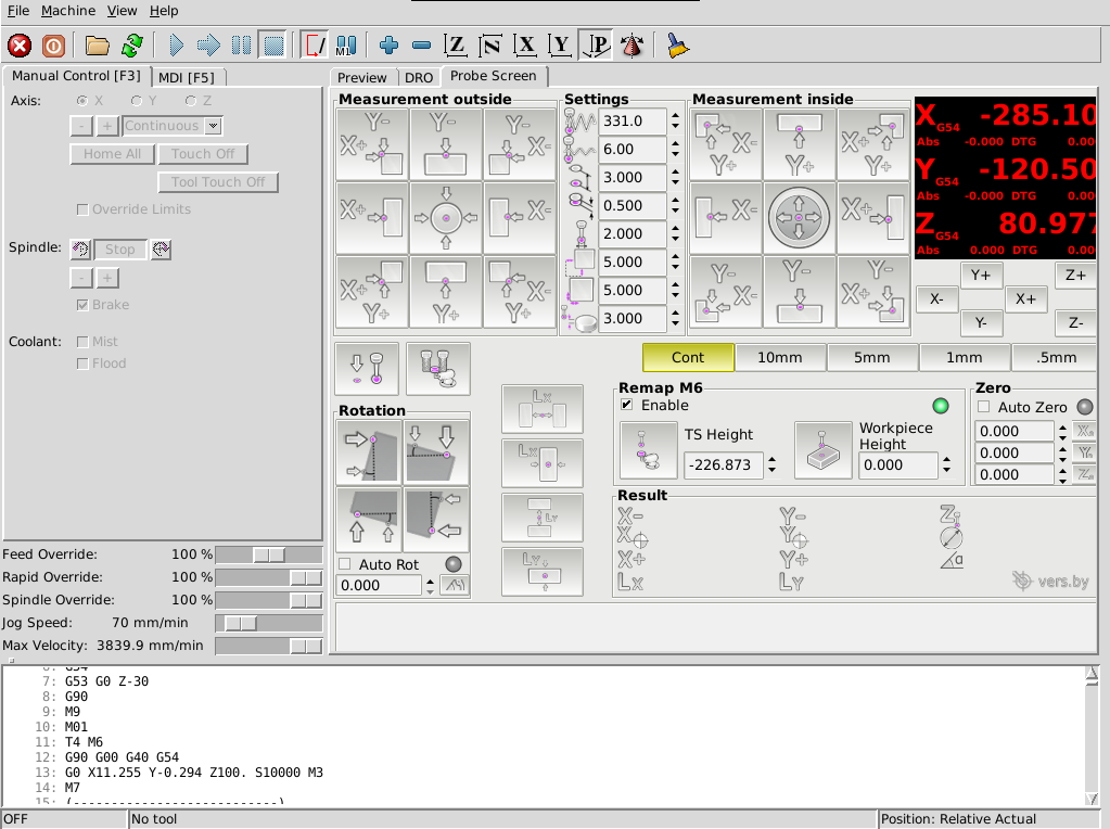

09 Mar 2019 20:00 #128177
by vmihalca
Replied by vmihalca on topic Work with probe
I have done everything that was mentioned in the instructions (or at least that's what I think) and now I have an issue at tool change from MDI.
How should I do a tool change now that I have ProbeScreen, whose installation required me to comment the manual tool change in my hal file.
I am attaching a video below with all the settings that I've made and what's the current behavior.
If I've missed something, please let me know
