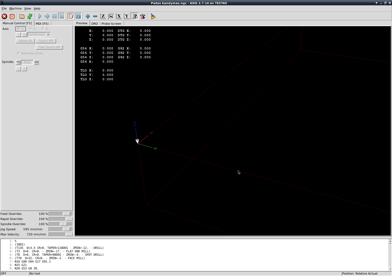

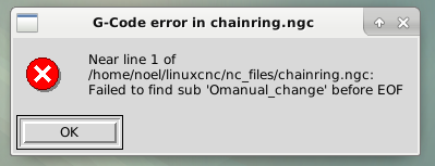

I installed Probe Screen V2 and it seem all functions work fine, but when I try upload Gcode (from fusion 360) code not work. In preview screen it doesen't show tool pases, when I try hit cycle start machine go to Z0 and then nothing happens. I noticed G code without tool in descripcion work fine(example linux engrave program "Linux CNC" ). So I what to ask if anyone have similar problem and solve it, or I simply wrongly intalled program and asked stupid question? :dry:

Damn, i should have look this thread 3 hours ago, fighting with the same problem x)

Tool replacing window can fall to a level below due to manipulations with the mouse on the Axis screen during the procedure. You can pull out it by folding Axis in the tray.

No i think its not there, in fact i think that i'm misunderstanding some of you instructions, because i don't have any connections in my hal signals regarding to tool.

09 Feb 2019 01:07 - 09 Feb 2019 01:09 #126027 by Roguish
Replied by Roguish on topic Work with probe
Verser,
Not sure what happened, but now I get an error on startup of Linuxcnc. I have traced it to the remap:
REMAP=M6 modalgroup=6 prolog=change_prolog ngc=manual_change epilog=change_epilog
If I comment out the remap no error.
this is ProbeScreen v2.
so, What's up?
Last edit: 09 Feb 2019 01:09 by Roguish.
13 Feb 2019 22:18 #126402 by andypugh
Replied by andypugh on topic Work with probe
"Failed to find sub" can be caused by loading a G-code file that is %-delimited and calling a G-cide subroutine that is also %-delimited (though this bug only exists in recent versions of 2.8)
24 Feb 2019 10:46 #127043 by franstrein
Replied by franstrein on topic Work with probe
As I mentioned in another thread, I added NativeCam and the Probe v2 functions to my gmoccapy 1.5.4 and Linux 2.7.14 setup.
Most things work very good.
The only issue is that when I try to execute a gcode file generated by my HSM Express CAM functions, I get an error:
In line 0 of the gcode file the pycall(remap.change_prolog) call fails
I expect this to be caused by the line
in my INI file. I needed to add that for the probe screens to work, according to the instructions at
github.com/verser-git/probe_screen_v2
Is there a conflict with a similar mapping ??
Any suggestions?
Thanks,
Frans
