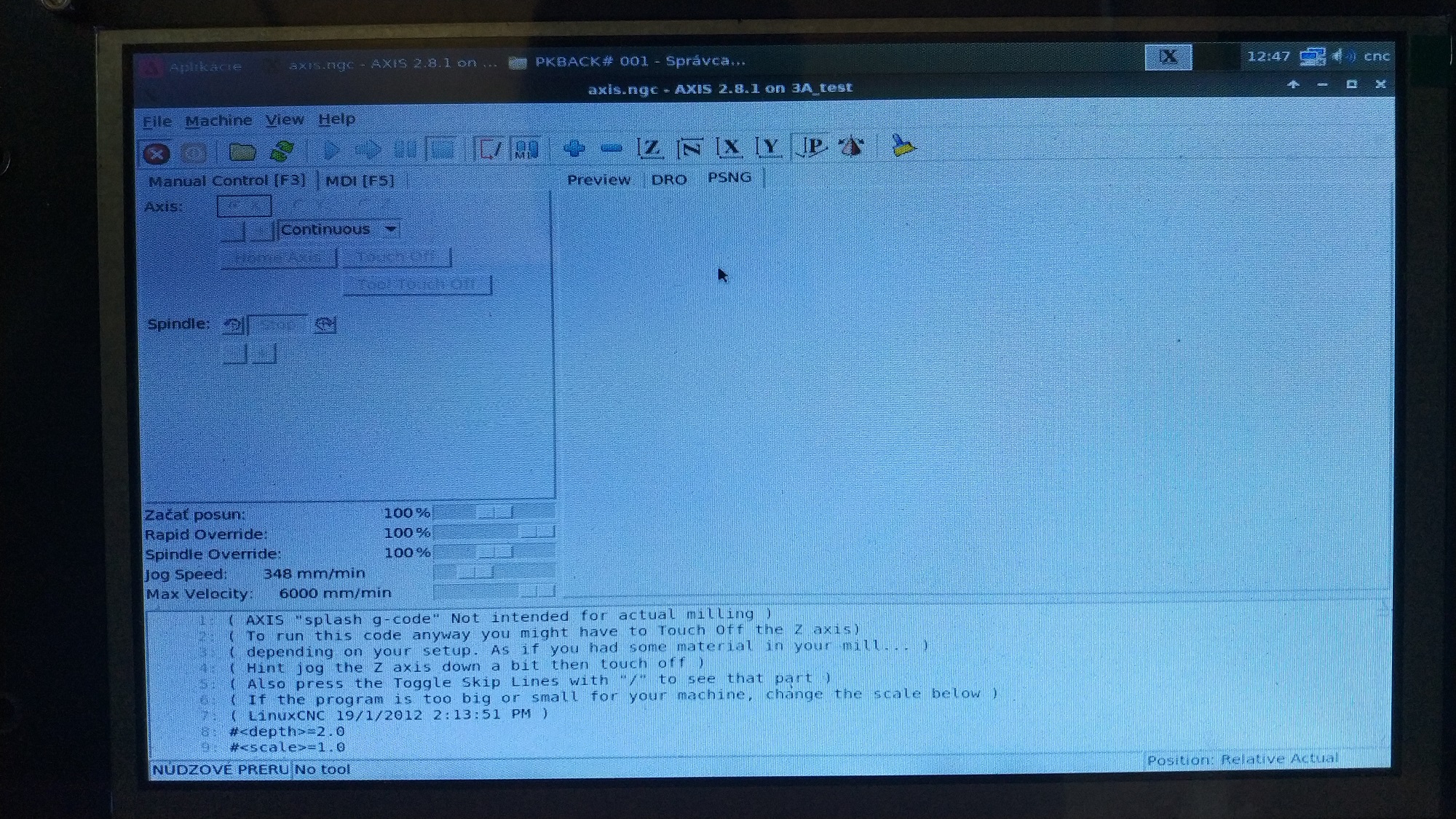

14 Jun 2021 09:27 - 14 Jun 2021 11:55 #212007
by MLc
Replied by MLc on topic Work with probe
Hello guys, I want to ask if it possible run this probe screen on OrangePi linuxcnc from MXmaster. I try it but I have problems. I did it according to the manual. Here is my config files for check. (This is my test config where I tested the probe screen. If it will work I add it to my config which I use)
I use this probe screen: github.com/linuxcnc-probe-screen/probe-s...-ng/tree/master/psng
Thank you for answer
Martin
EDIT:
I fix the problem, linuxcnc run but the window ''PSNG'' didn't show any icons.
Martin
EDIT:
Last edit: 14 Jun 2021 11:55 by MLc.
- Posts: 19896
- Thank you received: 4648
15 Jun 2021 23:23 #212155
Replied by andypugh on topic Work with probe
Start LinuxCNC from the command lone, and you will probably be able to see the problem printed to the terminal.
- MLc
- Posts: 12
16 Jun 2021 15:56 #212205
by MLc
Hi Andy, can you tell me how to run it from command line? I tried it but I don't know how... linuxcnc not start.

17 Jun 2021 07:32 - 18 Jun 2021 06:05 #212260
by MLc
Hi all, I managed to start the linuxcnc from command line. Here is the terminal log:
Found file(REL): ./config.hal
Note: Using POSIX realtime
note: MAXV max: 100.000 units/sec 6000.000 units/min
note: LJOG max: 100.000 units/sec 6000.000 units/min
note: LJOG default: 5.000 units/sec 300.000 units/min
note: jog_order='XYZ'
note: jog_invert=set([])
Unexpected realtime delay on task 0 with period 200000
This Message will only display once per session.
Run the Latency Test and resolve before continuing.
Gtk-Message: 08:48:27.898: Failed to load module "gail"
** (gladevcp:3711): WARNING **: 08:48:27.989: (../atk-adaptor/bridge.c:993):atk_bridge_adaptor_init: runtime check failed: (root)
File "/usr/bin/gladevcp", line 46, in <module>
import gladevcp.makepins
File "/usr/lib/python2.7/dist-packages/gladevcp/__init__.py", line 1, in <module>
from hal_pythonplugin import *
File "/usr/lib/python2.7/dist-packages/gladevcp/hal_pythonplugin.py", line 42, in <module>
from hal_sourceview import *
File "/usr/lib/python2.7/dist-packages/gladevcp/hal_sourceview.py", line 27, in <module>
import gtksourceview2 as gtksourceview
ImportError: No module named gtksourceview2
Any solutions? (I run linux on OrangePi) I tried to configure machine settings on my old thinkpad with LPT port and the probe screen working..
Thanks Martin
EDIT: I fixed it. Gtksourceview2 was missing. After instalation probe screen working.
