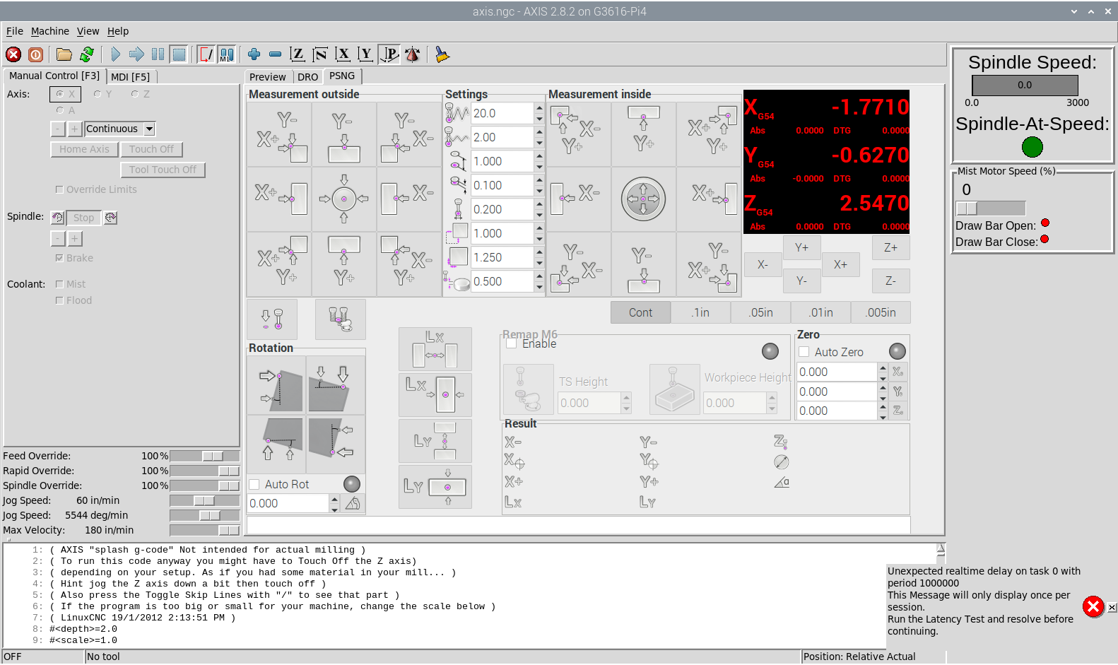

The .axisrc is dramatically different between versions so you probably do need to update it.
Some observations on the Pi4 with 2.8.2 AXIS remembering I don't actually have a machine connected and just a wire for the probe. (Should really wire in a button). Anyway.
1. The jog buttons now work and the DROs on the PSNG screen now change.
2. Click on one of the probe action buttons and the DROs do not change. At first I wasn't sure if they were even working since nothing is connected. However, quickly flip to the main screen and the DROs are changing and you can see the tool following the path as outlined in the original first posting in this thread for whatever operation is chosen.
3. Run a G-Code program with tool T1 in the tool table and T1 M6 G43 and the tool lifts up, moves to the tool change position. Goes down, Goes up, Goes down and then the dialog with the date of the T1 entry into the tool table shows up. Click on tool has changed button, dialog box vanishes and program stops. After that it won't run again.
Likely this is an interaction between the need for an automatic tool changer and manual tool changing which was commented out as part of the installation procedure for PSNG.
Point #2 isn't critical but really _should_ show all axis motion no matter how it's happening.

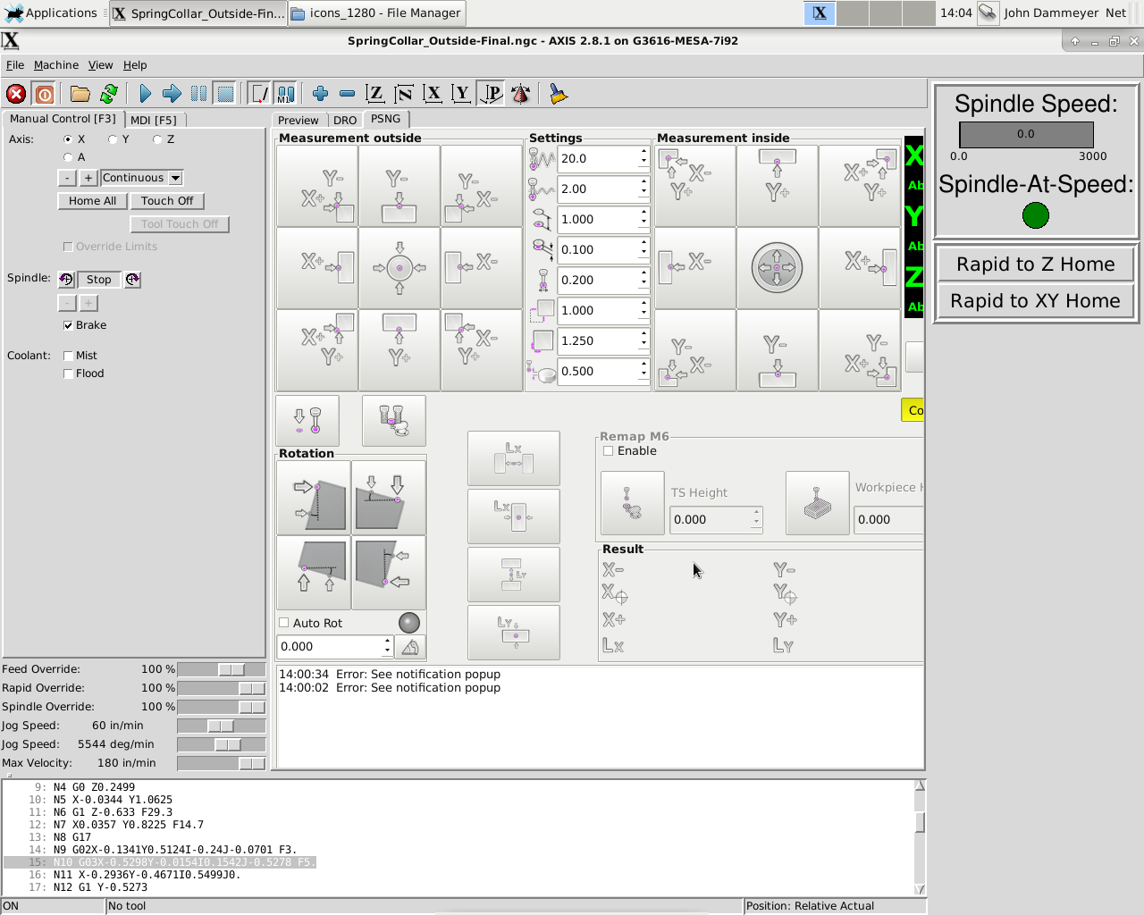

That restores manual tool change with only one annoying feature that as yet I have not solved.  We move to the tool change position.  Then it moves move up and then down again before putting up the original dialog rather than the one from the PSNG code.
The second issue and way more annoying is there doesn't seem to be a way to load the smaller icons etc.  renaming the icons folder to icons_1280 and the icons_1024x768 to icons doesn't seem to make a difference in icon sizes.  And I can't find anything that directly references the size of the screen.
What is needed is one of two things:  either a smaller PSNG screen or the ability to slide the panel on the right out of the way whenever the PSNG screen has focus.  I can't be the only one who has stuff sitting beside the main screen.
Other than that, as expected it reaches the -Z distance before the contact occurs (because nothing is connected) so that part appears to work.

Hi John, have a look to ini file and replace
EMBED_TAB_COMMAND=gladevcp -c probe -x {XID} -u psng/python -H psng/psng.hal psng/psng.glade
by
EMBED_TAB_COMMAND=gladevcp -c probe -x {XID} -u psng/python -H psng/psng.hal psng/psng_1024x768.glade

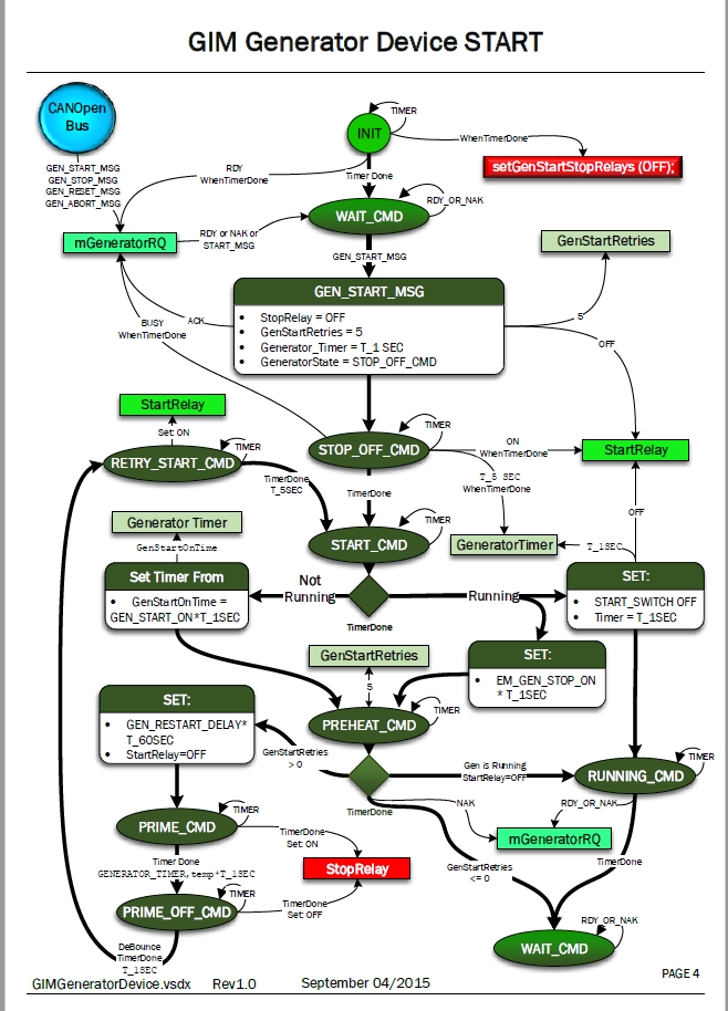

I'm going to start documenting some of the code because two hours later I've forgotten what the heck it was doing.  I think for external documentation some state change and dictionary drawings would also be helpful.  Something like the attached.  I did this a long time ago.
27 Oct 2021 06:01 #224474 by jcdammeyer
Replied by jcdammeyer on topic Work with probe
BTW, instead of changing the INI file with the psng/psng_1024x768.glade I renamed psng.glade to psng_1280.glade and rename the 1024x768 file to psng.glade.
No difference. My monitor screen is 1280x1024 and the image I posted is actually that size. On the Pi4 the 1080P screen does show both my panel and the touch psng screen.
27 Oct 2021 06:09 #224475 by jcdammeyer
Here it is on the Pi4 which is connected to a MESA 7i92H. Not sure if the real time delay warning is because I'm also connected via WiFi or if the CAN bus code is taking too much time.
27 Oct 2021 08:03 #224482 by furynick
Replied by furynick on topic Work with probe
On my side I just renamed psng.glade to psng_1280x1024.glade and made a symbolic link to the file that fit my screen and I have a different panel according to which file I choose.
