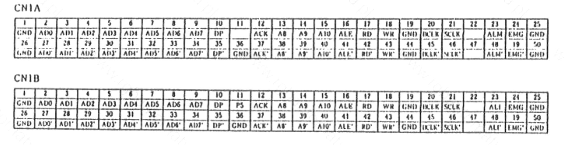

What version of MELDAS is currently supported? I have a machine I'm in the process of fixing with MELDAS M3 controls, and I'd really like to run it from LinuxCNC ultimately.
I have a logic analyzer, can provide traces (when I get to that stage). I'm also very familiar with coding and hardware design. I'm guessing the older protocol would be quite similar to the newer one. Seems a little redundant to start from scratch on the M3 protocol when it's probably similar to work you've already done.
I have a
MR-S3-100AA 3 axes servo controller (integrated in one unit) for the axes
FR-SF-2 spindle drive.
They both connect to the FCA M3 controller on some kind of a bus - it's a big 50-60 pin (the terminator is screwed in right now - I'll remove it and count the pins later) 0.1" IDC-type connector.
I was looking at the YMDS2P card on your website which supports MELDAS and it looks like it only has the smaller connector for the newer bus type. I wonder if completely different hardware is needed, or just some adapters. I think the pin out of the bus connector is in the MELDAS M3 manuals somewhere, but it's been a while since I've looked at them.
I would guess supporting M3 / M5 would open up a lot of machines to easy linuxcnc conversion. There seem to be quite a lot of those machines out there being retired from their first life.
I have a

currently i support
MDS-A/B/C-V/SP/SVJ/SPJ servo/spindle with YMDS2P (copper serial)
MDS-D/E servos with YMDS3P (optical)
sorry, i don't support the older parallel bus on MR-S/FR-SF
FR-SF spindle drive, afair, can accept analog speed command
/dmitry

Do you know anything about the older protocol? I mean obviously it'll be different at the hardware level if the old bus is parallel and the new bus is serial, but are the commands or packet structures similar at all?
I need to fix some mechanical things on the machine before I'm ready to dive into doing anything with the bus anyway.
Also I looked up the bus in the manuals I have - 50 pins, all in pairs (not sure if they're differential signalling or not - probably). I thought some manual had at least a rough pinout, but all I could find was a basic cable spec.

unfortunately no, i haven't tried to hack the MR-S... no idea about the protocol. c'mon, those drives are 30 years old...
i'd be surprised it the protocol is similar to the newer drives. from my experience with reverse engineering, mitsubishi changes everything with each new version. unless you have a somewhat working control to snoop on the bus or a lot of time to disassemble and understand the drive firmware - i wouldn't try to resurrect them. would be more practical to replace drives/motors with something more modern. imho
