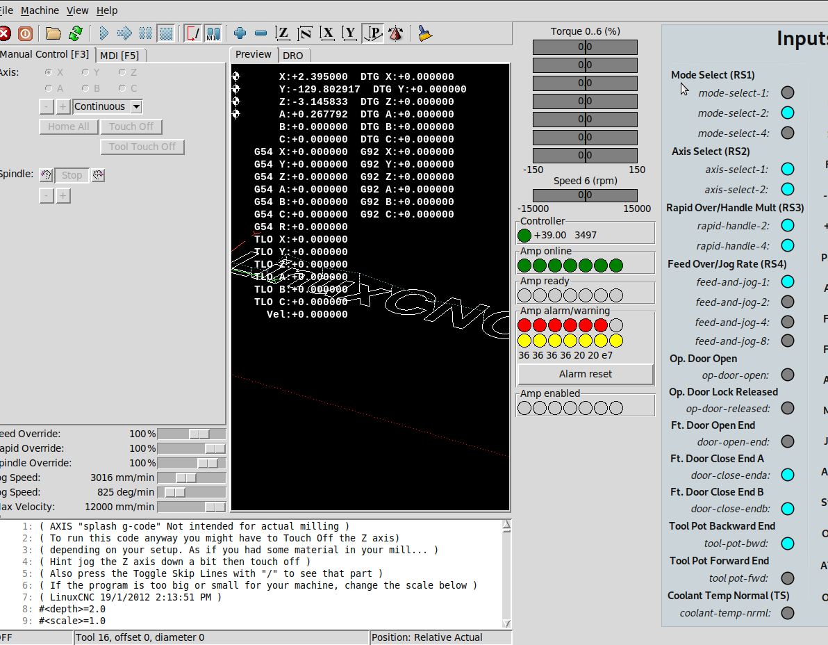

Screenshot after startup. Servo period is 888888ns. I added an 'err-count' readout to the right of 'phase' display.
Any idea what's causing the alarms?

- dm17ry
- Posts: 211
- Thank you received: 89
01 Jul 2023 17:26 #274610
by dm17ry
Replied by dm17ry on topic Mitsubishi SSCNET
not 100% sure, but it may be provoked by other drives in alarm state..
i would start from the end of the chain. connect the card to the spindle drive's CN1A. MDS-CV i guess is hooked to the spindle. get it up and running without alarms.
then add one SVJ before it, get rid of the encoder alarm 20.
and so on..
and so on..

- tropostudio
- Posts: 39
- Thank you received: 4
03 Jul 2023 23:04 - 03 Jul 2023 23:08 #274717
by tropostudio
Replied by tropostudio on topic Mitsubishi SSCNET
dm17ry -
I put together LinuxCNC machine configurations that let me isolate and check individual Mitsu drives. MDS-C1-SPH-110 is fine by itself. Both MDS-A-V2-0505's throw #36 'NC transmission' errors on each drive, no matter what I adjust within the .PAR files - even setting them up with Mitsubishi standard parameter for the drive and motor settings. Maybe it is a matter of re-zeroing axes, even with absolute encoders that report back as OK?
We can take this to email if it's getting into the weeds. What is the best way to contact you?
