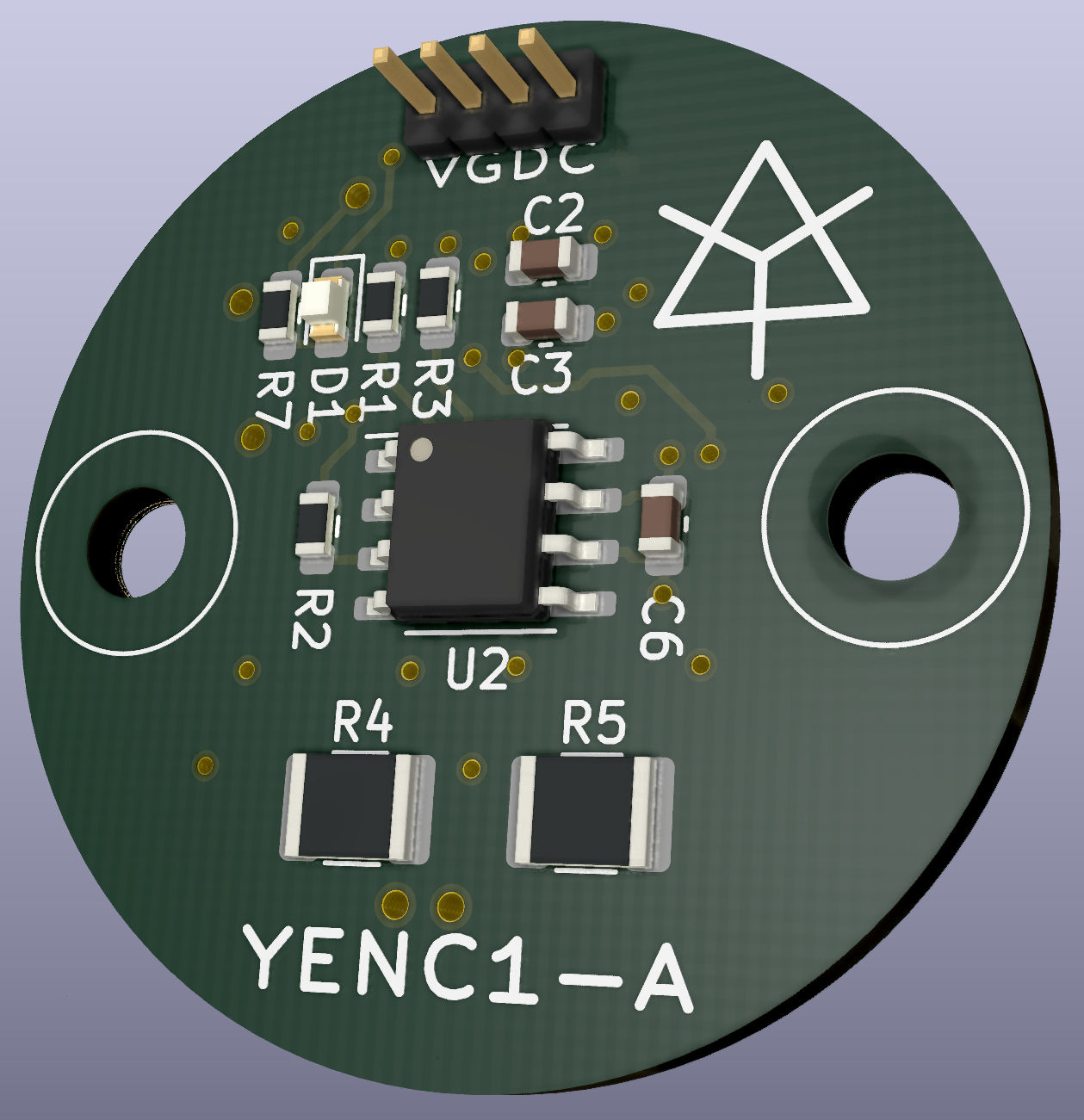

implemented a support for MDS-D-SVJ3/SPJ3 servo drives. it turned out that they are using a slightly different sync symbols than SSCNET-III... while the next gen (J4 based MDS-DJ/EJ) can understand both. anyways, was able to reflash firmware/modify MR-J3-B drives into MDS-D-SVJ3/SPJ3. the SPJ3 was interesting for me as it is based on the same hardware as MR-J3-B and can drive induction motors. so with a bit of fiddling with the hardware i was able to get the firmware running, but not enough to get a generic induction motor spinning with a OBA18 encoder. that encoder is not officially supported, original induction motor spindles use TS5690 PLG detector with 2/4Mcpr. the OBA18 is recognized by the firmware, however the resolution is downgraded by the firmware from 18 bits (262144cpr) to 260000cpr using software floating pont arythmetic (sic!). the spindle drive worked fine with PM motors, but with an IM it failed:
i played with it for a while trying to tweak all the motor constants, but without any significant improvement. got tired and angry, disassembled the firmware and removed all the encoder resolution checks. set the resolution by servo parameters to proper 18bits (262144cpr), and viola - it worked!
an induction motor behaves perfectly under position control

- dm17ry
- Posts: 211
- Thank you received: 89
11 Jul 2021 17:37 - 11 Jul 2021 17:57 #214300
by dm17ry
Replied by dm17ry on topic Mitsubishi SSCNET
yes it does! feels pretty much like a PM motor to me... with MDS-D/E drives (MELDAS M70/700 M80/800 controls) they totally ditched a speed control for the spindle from the protocol. previously (M60/M600) the spindle was speed controlled and they only switched it to position for sync tapping/C-axis. tool changer orientation was controlled by a separate signal bit. starting with 7th gen the spindle is always position controlled...
actually, my next step would be trying to make my own mitsubishi serial-interface encoder and try to run a small chineese 24rpm induction motor spindle with a MDS-D-SPJ3-075 drive. the encoder is based on a TLE5012B magnetic IC. not quite 20+ bits like the original ones, but i hope it will work. will report how it does

- dm17ry
- Posts: 211
24 Sep 2021 22:40 #221521
by dm17ry
a bit of a progress here... made an ABZ incremental encoder to mitsubishi serial converter. tried that converted MDS-D-SPJ3 drive with an induction motor and a generic 12-bit incremental encoder instead of OBA18. it spins, but kinda rough and noisy. the drive seems to expect much finer resolution so doesn't take much effort processing the feedback. gonna try to put it thru something like a kalman filter, but no idea if it will help...
