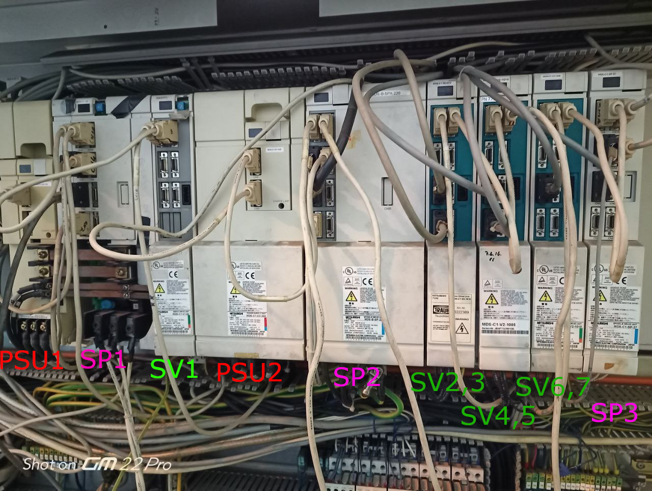

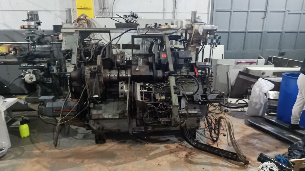

yet another retrofit in progress - traub tnc 65. originally mitsubishi meldas 500 controller with some customizations from traub i guess. mds-b/c1-v/sp servo drives. the oem controller was alive, so i got servo/spindle params from it. the machine has 3 spindles: main, counter and live tooling. main and counter have hi-res secondary encoders for C1,C2 axes plus hydraulic brakes. two carriages were mapped to Z,X and W,U axes and counterspindle to V, but a secondary independent control channel is badly needed for adequate utilization of the machine potential... also spindle-counnterspindle synchronization is in research...
the machine has no limit switches relying on absolute servo encoders. it has Z1,Z2,V overload sensors. it has two Z1-V proximity switches. linuxcnc homing was configured with rigid stops and servo motor torque limiting.

I'm wondering what the original controller did to drive the two carriages independently since I suppose everything came out of the same Gcode. A lot of it was probably handled in the CAM but it certainly seems that you would need two independent linuxcnc installations with the gcode for some of the axes passed over from one to the other with some sort of synchronization.

afaik, mitsubishi controllers have a "system" entity. i belive it's an independent g-code interpreter+interpolator. for this machine has
system $0: Z1,X1,V
system $1: Z2 X2
system $2 ??? aux functions - workpiece removal
spindles are shared
i don;t have yet a programming manual for the traub, i'll try to obtain one. i guess they have 2 g-code programs running simultaneously plus some means of synchronization between them
system $0: Z1,X1,V
system $1: Z2 X2
spindles are shared

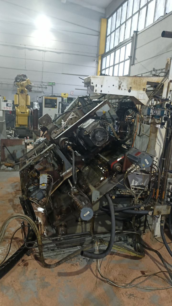

there's also a fanuc robot on the photo in the background - i may try to get on it too
