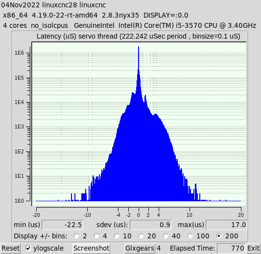

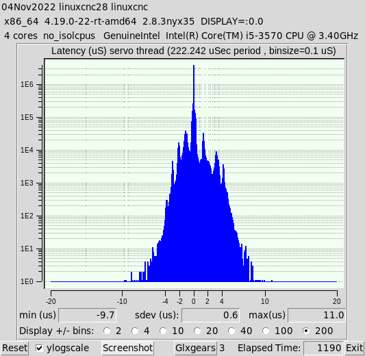

All BIOS options were already turned off, latency was quite good (<25 us on a 15min run, and did longer runs with similar performance).
Surprisingly, after modifying /etc/default/grub, the isolcpus does not show in the second run:
But overall this latency seems to be within what you recommend, no?
I am still getting "sync glitches" though, and the D6 LED is behaving erratically.
[EDIT] I have linuxcnc running without sync glitches and D6 long on->short off, but still the same status.
