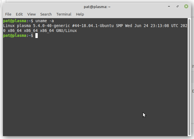

I'm trying to install Linuxcnc on my new PC, and apparently it won't install the Debian version. Instead, I found this thread and installed per instructions. First let me say, Mint looks a lot 'cleaner' (maybe modern is a better way to describe). Anyway, whenever I ran pncconf and entered the stepper scale and attempted to test, it says I'm running a simulation. That's different for me. Did I install Mint/Linuxcnc wrong?

What does
uname - a
say ?
uname - a
say ?

I don't recall seeing that. Forgive me, because I'm a little lost inside of Mint as it's layed out a bit different than Debian was. Where can I find that?

Replied by tommylight on topic (superseeded) Linuxcnc on Linux Mint 19.3 quick and easy installation
in a terminal from the menu or left side on the bottom panel, black square.

25 Jul 2020 19:13 #175829

Did you install the kernel ?
wget http://http.us.debian.org/debian/pool/main/l/linux-signed-amd64/linux-image-5.4.0-0.bpo.4-rt-amd64_5.4.19-1~bpo10+1_amd64.deb
sudo gdebi linux-image-5.4.0-0.bpo.4-rt-amd64_5.4.19-1~bpo10+1_amd64.debPlease Log in or Create an account to join the conversation.

25 Jul 2020 19:35 #175831
by dvn4life1972
Yes sir, I did.
Replied by dvn4life1972 on topic (superseeded) Linuxcnc on Linux Mint 19.3 quick and easy installation
wget http://http.us.debian.org/debian/pool/main/l/linux-signed-amd64/linux-image-5.4.0-0.bpo.4-rt-amd64_5.4.19-1~bpo10+1_amd64.deb - sudo gdebi linux-image-5.4.0-0.bpo.4-rt-amd64_5.4.19-1~bpo10+1_amd64.deb

Reboot and hold down ctrl+shift keys until you get the grub menu.
select the line with RT in the name
