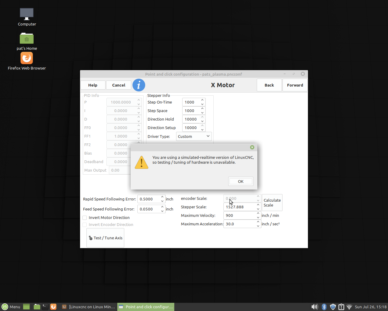

26 Jul 2020 15:19 #175962
by dvn4life1972
Replied by dvn4life1972 on topic (superseeded) Linuxcnc on Linux Mint 19.3 quick and easy installation
Here goes this thing again...says I'm in simulation.
- Posts: 22030
- Thank you received: 7504
26 Jul 2020 16:01 #175973
Replied by tommylight on topic (superseeded) Linuxcnc on Linux Mint 19.3 quick and easy installation
Nevermind that, make the config and save it, you can tune things later from LinuxCNC using the calibration thingy.
What does uname -a say now ?
The following user(s) said Thank You: dvn4life1972
