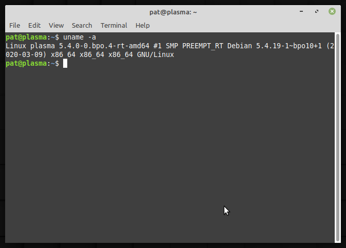

tommy,
I'm trying a second computer, it continues to boot in 5.4 instead of 4.9. I moved 4.9 to the top in the grub customizer, that didn't work. I removed 5.4 in customizer and it continues to boot in 5.4.

Replied by tommylight on topic (superseeded) Linuxcnc on Linux Mint 19.3 quick and easy installation
That will work, but 5.4 has a bit worse latency.
Did you try the config ?

Did you move it to the absolute top, not the top of the sub menu ?tommy,
And save it ..

26 Jul 2020 16:57 #175983
by riversvic
Replied by riversvic on topic (superseeded) Linuxcnc on Linux Mint 19.3 quick and easy installation
That was it! thank you

26 Aug 2020 15:32 #179577
by aparecido
Replied by aparecido on topic (superseeded) Linuxcnc on Linux Mint 19.3 quick and easy installation
I am testing Mint 19.3 following the tutorial in the first post, I checked the kernel and it is the same as in the initial post of the topic.
IPM31 v1.03 motherboard (Pcware / Pegatron) with onboard video
Core2duo E7500 2.93GHz-FSB 1066Mhz-L2 cache 3MB
1GB Kingston DDR2
Hd sata
I opened several programs and some windows with glxgears, the Jitter is around 40000ns and then jumps to 166640ns and stays at that value.
What can I do to lower the jitter value?
Thank you.
Add more memory, 4GB works fine, sometimes even 2GB are ok.
