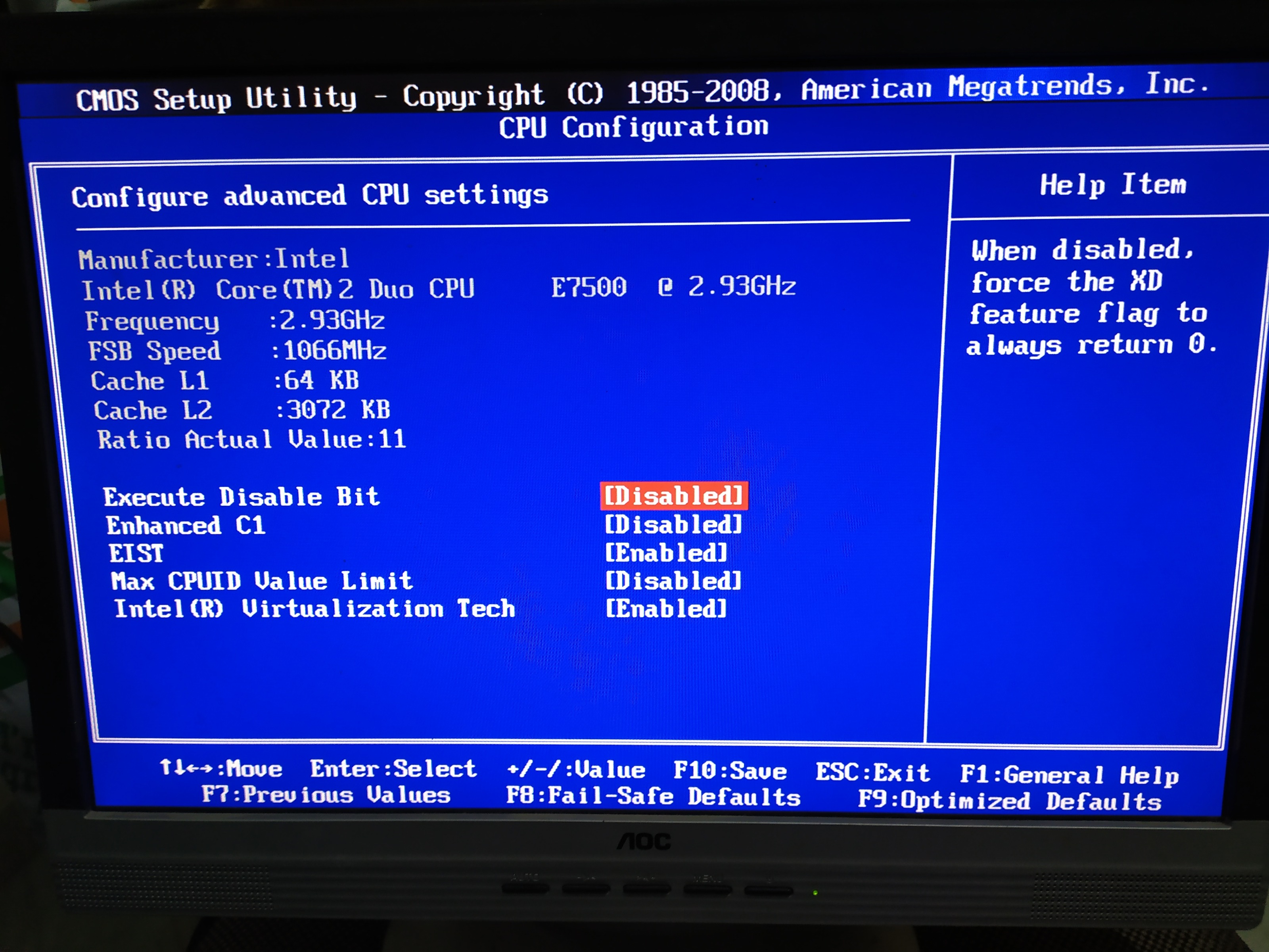

aparecido
Check the bios options, there is really a ton to try. Start with disabling hyperthreading, cpu frequency, powersaving. Just disable everything you do not need, audio, pcspeaker....
If possible, add ram.
Sometimes a ssd helps too.
May I suggest you use the script here and post your results there ?
greez
chris

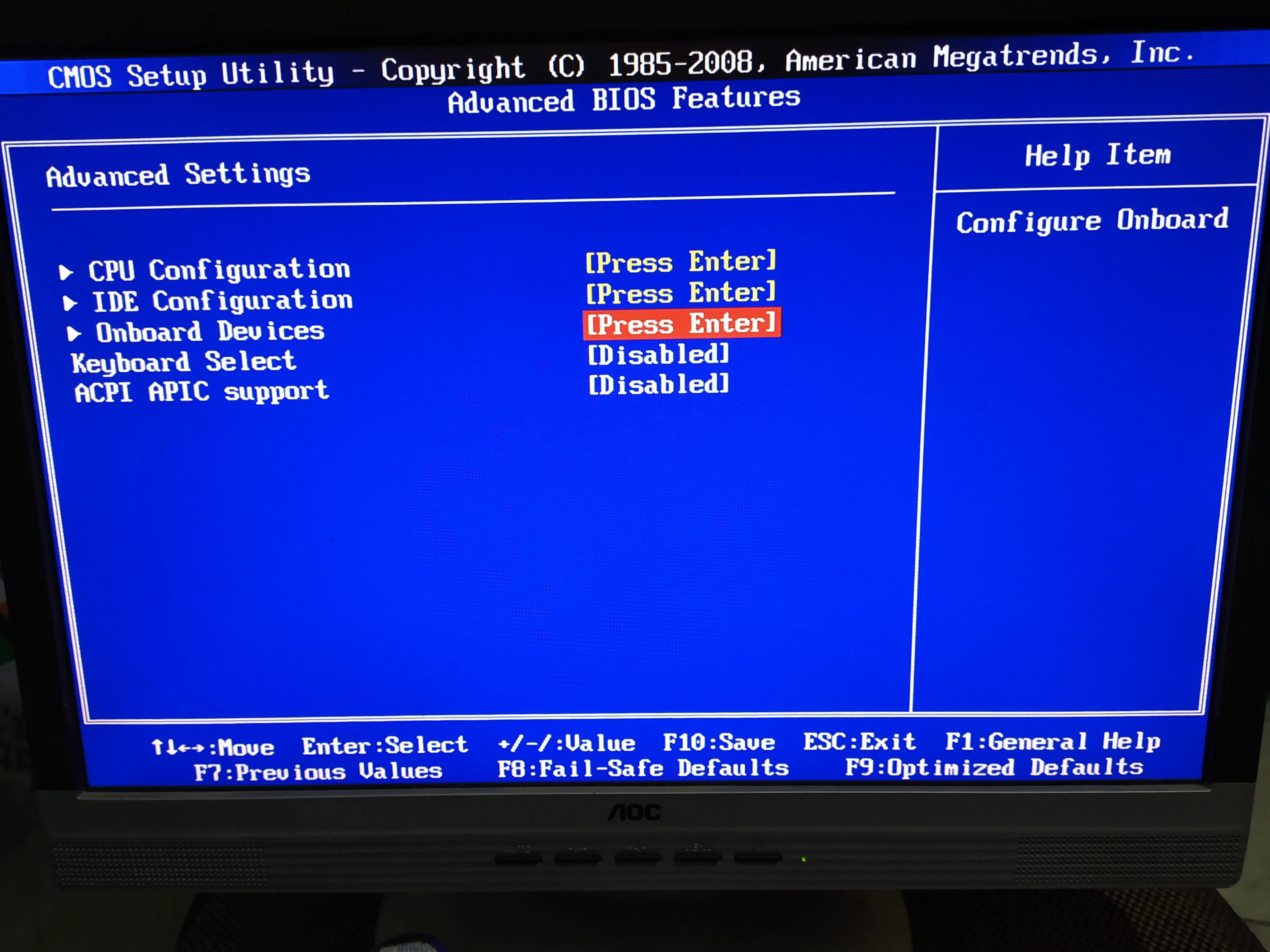

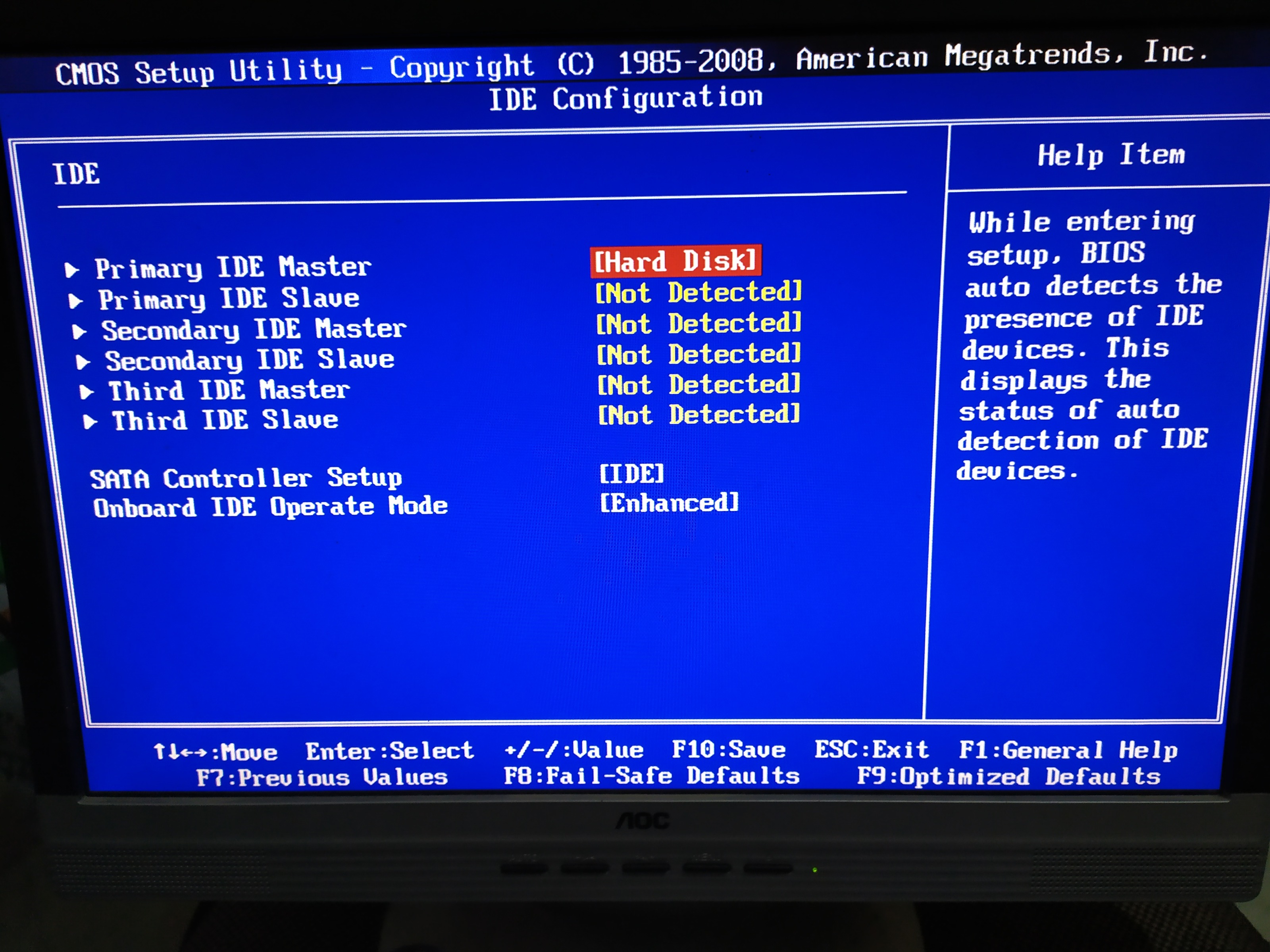

aparecidoa
I suggest the following:
in "advanced cpu settings" I'd disable "intel virtualization"
In "IDE config":
It remains to be tested, if you can/should or must disable "ACPI APIC" support
[EDIT]
In "Power managment features" play with "ACPI suspend" and +APM Configuration"
[\EDIT]
Just hints, you need to play. It may pay though.
greez
chris
PS: for a quick imporession, run the script for a few ten minutes, as tommylight usually does. In order to keep things comparable, kindly take your better half for dinner and let the script run the 2 hours
. I usually go sleeping or windsurfing and if there is nothing better to do, I go working meanwhile
