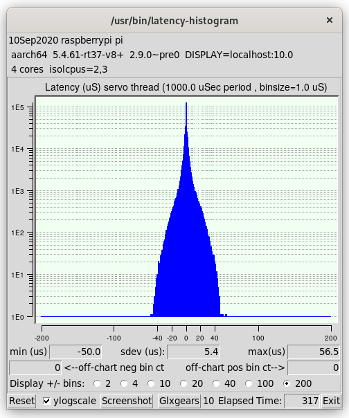

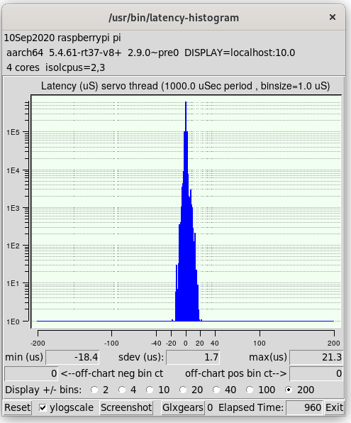

Hi elovalvo,
thanks a lot for your work! I tried your release from today morning.
Without any glxgears running it look quite good (still not so good as phillc54's):
But as soon as I start 10 glx gears it look much worse:
I installed according to your description
Linux raspberrypi 5.4.61-rt37-v8+ #1 SMP PREEMPT_RT Wed Sep 9 18:58:22 CEST 2020 aarch64 GNU/Linux
cat /boot/cmdline.txt
console=serial0,115200 console=tty1 root=PARTUUID=60687991-02 rootfstype=ext4 elevator=deadline fsck.repair=yes rootwait quiet splash plymouth.ignore-serial-consoles processor.max_cstate=1 isolcpus=2,3
any ideas?

Yes, that is still very good latency.any ideas?

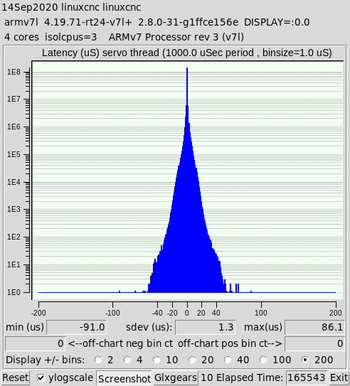

This is mine with 10 Glxgears after a couple of days. It had a couple of odd spikes but perfectly adequate for my machine which has a Mesa 7i96 and a 2mS servo thread.
This using the ISO from the LinuxCNC website without any modification:
www.linuxcnc.org/iso/
It has isolcpus=3 in /boot/cmcline.txt

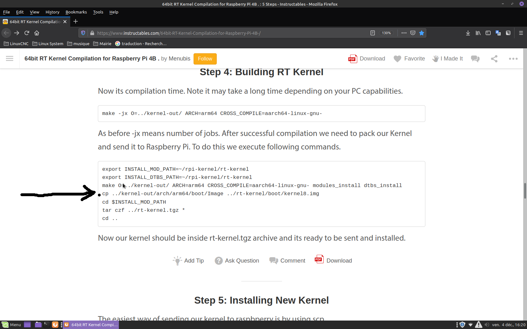

Hello ,
i built on u amd64 linuxcnc 2.9pre with switch kin branch. It works very well.
Now i want to make it all work on raspberry pi4
I'm trying to install a 64-bit Kernel Preemt-rt on my RaspPi4.
: www.instructables.com/64bit-RT-Kernel-Co...or-Raspberry-Pi-4B-/
works well, until the moment when it no longer happens on a simple file copy.
Can you help me please because I am not very easy in the matter.
thank you so much
