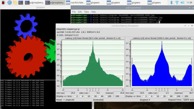

20 Apr 2021 05:05 #206501
by tjtr33
Replied by tjtr33 on topic RPI4 Raspbian 64 bit & LinuxCNC
i think there are too many closely related threads here
and this hread is about rpi 64 bit so i post again...
elovalvo's 64bit runs well on pi4 4g
aarch64 5.4.61-rt37-v8+ 2.8.1
30.2 max base latency after 14 hrs
latency-histogram --base 80000 --servo 1000000
with 4 glxgears
hth
tomp
with 4 glxgears
hth
tomp

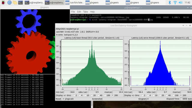

21 Apr 2021 05:25 #206615
by tjtr33
Another 14 hr run gave me 25.8 max base latency.
I use
with boot params of
isolcpus=1,2,3 idle=poll
and disable the screen blanking & screensaver
I dont know why 80 uS base period is such a sweet spot,
but 50,60,70,90 and 100uS were all tested. ( many tmes on may pi's )
and all (non-80) were not as good.
Why is 80 'sweet'?
I did get pretty good resuts from 50uS base period,
seeing 34uS latency after just a couple hours.
I was ready to discard the 50uS as a possible based thread period,
but it leaves 16 uS.
I say this ("leaves 16uS") because I believe the period - latency = reliable time available.
Is that true?
Then...
how good is 16uS as a time to get everything done?
When people say that 20uS latency is good in the context of a 50uS thread period,
are they implying they need 30uS to accomplish all tasks?
Is there a profiler that can determine how much of the period is used/unused?
thx
TomP

21 Apr 2021 22:44 #206729
I suspect that you are closer to knowing that than anyone on the planet. At least you know it.
The number of realtime users on the Pi in the world who have analysed the system is measured in the "severals" I suspect.
Replied by andypugh on topic RPI4 Raspbian 64 bit & LinuxCNC
Why is 80 'sweet'?

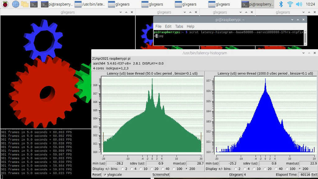

22 Apr 2021 03:37 - 22 Apr 2021 03:38 #206760
by tjtr33
Thx Andy
also
i ran a 50uS base thread ( still running)
and have max latency 28.7
i did change the environment in that i setup Samco's suggested ntp fix.
lateny-histogram --base 50000 --servo 1000000, with 4 glxgears
over 17hrs now
