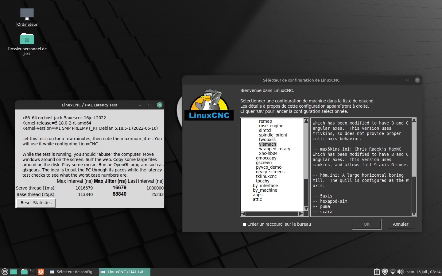

16 Jul 2022 06:26 #247431
by JackRay
Replied by JackRay on topic Installing LinuxCNC 2.9 or Master on Linux Mint 21
Hello Tommy,
Another great version of linuxcnc 2.9 on linux mint . Thank you very much for the work done, for people who are like me users without understanding everything they do ...
So, I just went from Dabian 10 with a very unstable RT to Mint 21 with a very stable RT (see attached picture).
Unfortunately, I can't find the xyzac-trt configuration to apply my 5 axis machine configuration.
Is there still something I have misunderstood ?

Replied by Aciera on topic Installing LinuxCNC 2.9 or Master on Linux Mint 21
you should find the xyzac-trt configuration if you drill down further in the menu:
vismach/5axis/table-rotary-tilting/xyzac-trt
Note: That README displayed in the right side of the window is outdated and does not list all of the configs in the folder.

Hello, impossible to develop the "vismash" branch in the menu. But it's not a big deal, I just copied my configuration in the ./linuxcnc/config menu, made some adjustments to the access paths and EVERYTHING WORKS WONDERFULLY. My 5 axis TCP milling machine is operational.
Moreover this last version on linux mint is very easy to install
Thanks again to all this great team who helped me with a lot of patience (I hope you didn't take too many antidepressants) with me .
Thank you very much for your help.
