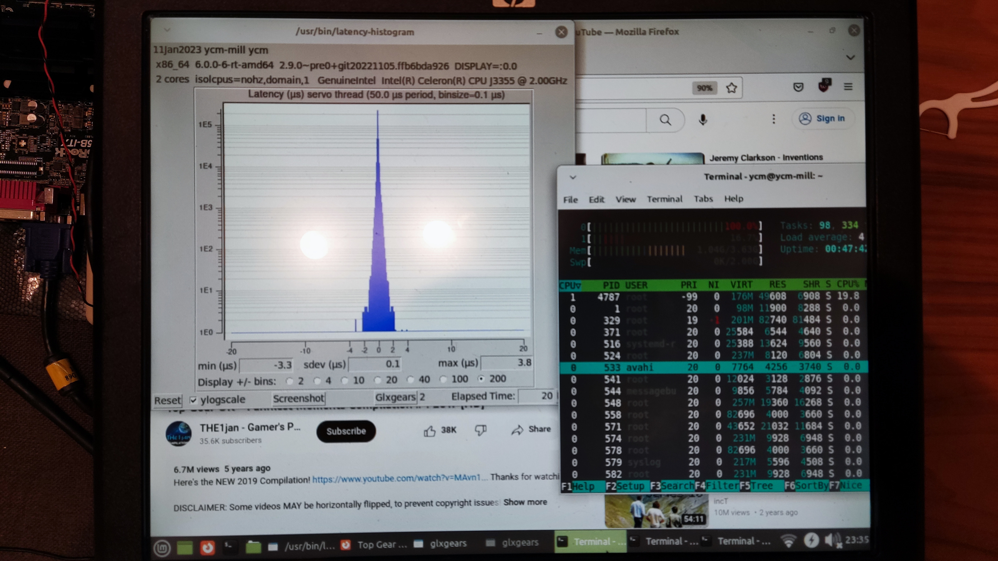

Agree, that apparmor is really messing system.That helped. Still needed apparmor=0
This is Debian Bookworm with my 6.1 kernel.quiet isolcpus=nohz,domain,2-3 apparmor=0 [attachment=50991]debian-11Jan2023-70.png[/attachment] So I think that will do me for now as its way under what a mesa card requires. I really would like to poke around with the kernel parameters to see if there are settings that improve network latency (which you should be able to measure roughly with ping times. PCW has ping command syntax that lets it run without a screen refresh until you stop it. Then look at averages...

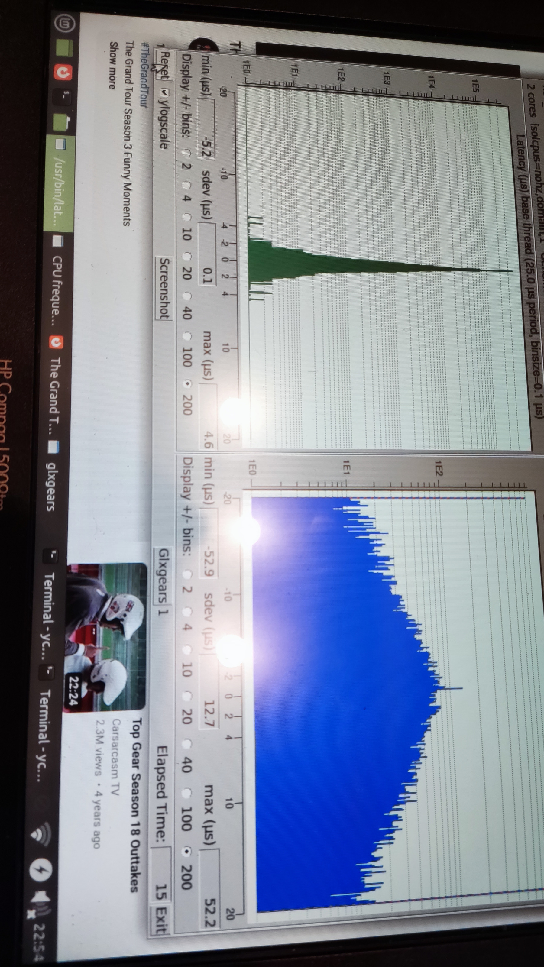

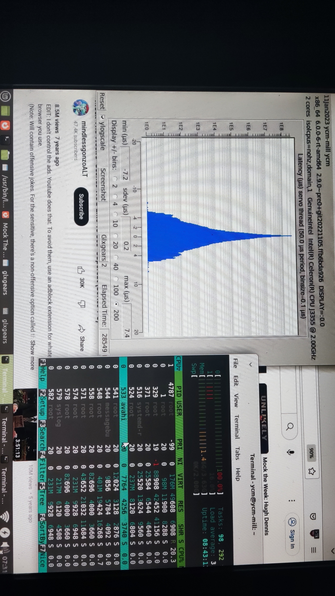

One more approach. I was curious - why i have marginally better results without nohz. And why some graphs have trident shape. On same setup/session.Reason - nohz is useable if we have 1 process in isolated core. But while testing with base period - we have two.Moved servo thread to core 0 with taskset - and we are in 6-7k region with glxgears and youtube. Without youtube even less..

sometimes a fat latency is becasuse the horizontal axis is clipped (eg < the 52 max shown) This is controlled by sbins parameter
Always use this:
latency-histogram --nobase --sbins 1000
Always use this:

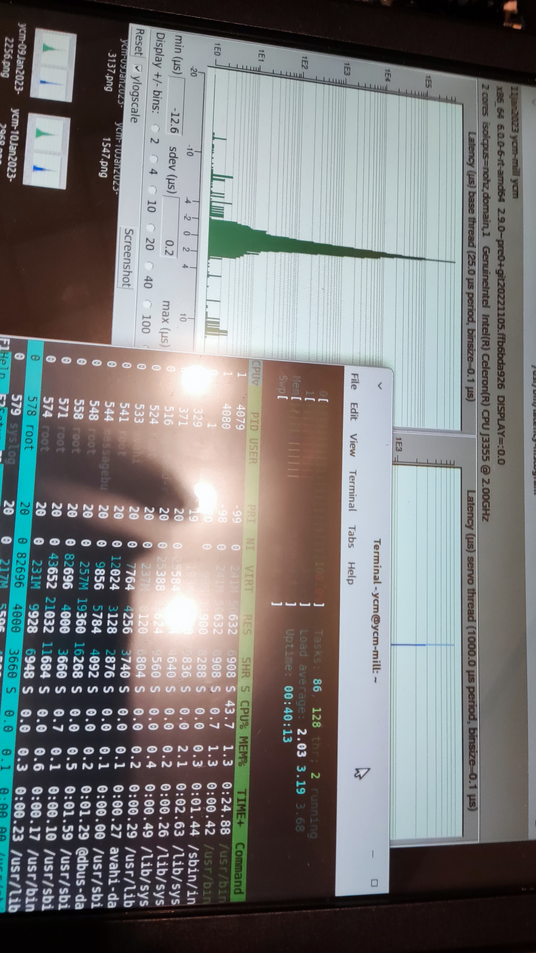

No no. All here is ok. I am tuning for parport driver. And yes - i was able to see different shapes / wrong results.
So - because i cant run it with noservo parameter i just moved servo to 0 core.
If run with nobase - it is always consistent in shape ant similar in delay.

Nope still two processes at core which we optimise to one.

Soo. Only test one process on single core.

And it have stable result now. After restart. Around 7k. You should not test it with both threads. All optimization is done for single core only.Looking good, thank you.
Could anybody explain - are there any difference between servo and base thread on testing ? If servo is run at same period as base ?
