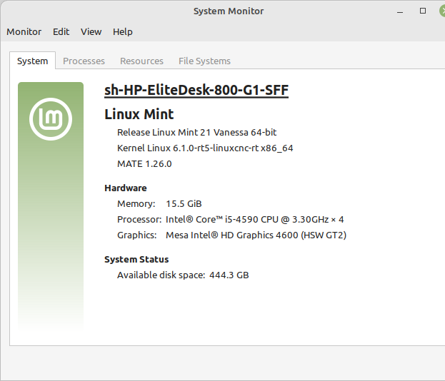

21 Dec 2022 04:09 #259994
by scotth
Replied by scotth on topic Installing LinuxCNC 2.9 or Master on Linux Mint 21
The following user(s) said Thank You: tommylight, bkt

21 Dec 2022 11:42 #260003
Replied by tommylight on topic Installing LinuxCNC 2.9 or Master on Linux Mint 21
Nice, thank you.
Those have Intel ethernet, so no issues with those.
Got a used laptop yesterday with a Realtek ethernet, it drops the link at random, despite latency being quite good.

23 Dec 2022 21:27 #260170
by scotth
It has been 4 days now. I haven't been able to get a failure yet. The new kernel is far more stable. I'm with you, though, I think a few weeks should tell the story.
