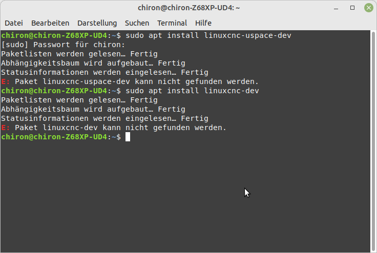

- ChironFZ16
- Posts: 58
- Thank you received: 12

- mgm
- Posts: 210
- Thank you received: 13
21 Jul 2022 19:55 #247985
by mgm
Replied by mgm on topic Installing LinuxCNC 2.9 or Master on Linux Mint 21
Maybe that helps
linuxcnc.org/docs/html/hal/comp.html

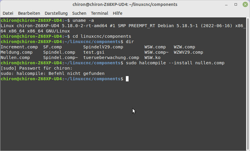

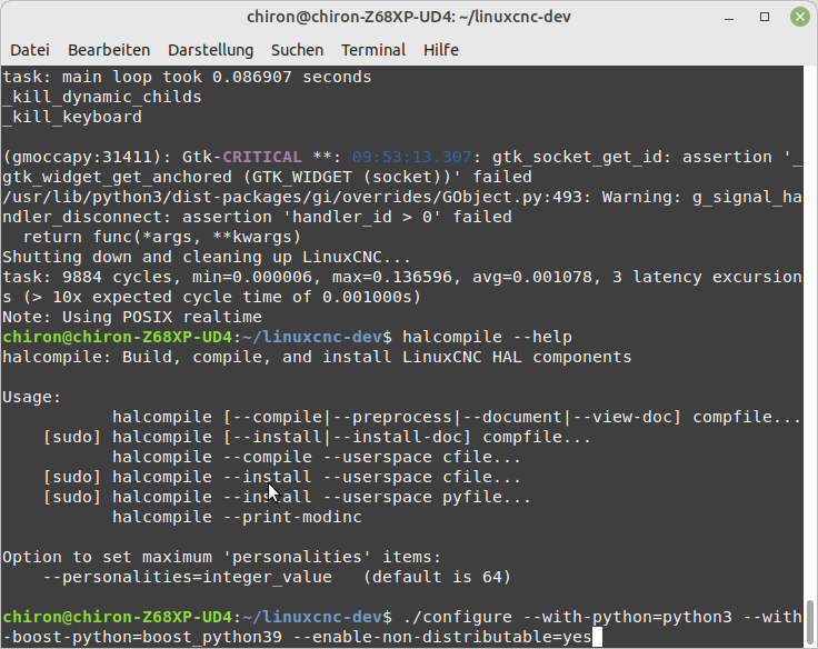

- ChironFZ16
- Posts: 58
22 Jul 2022 06:24 #248007
by ChironFZ16
Replied by ChironFZ16 on topic Installing LinuxCNC 2.9 or Master on Linux Mint 21
- ChironFZ16
- Posts: 58
22 Jul 2022 08:01 - 22 Jul 2022 08:01 #248010
by ChironFZ16
Last edit: 22 Jul 2022 08:01 by ChironFZ16.
