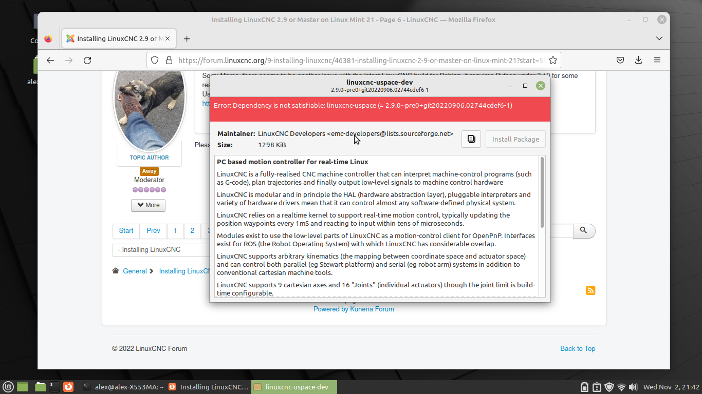

Sorry Marco, there seems to be another issue with the latest LinuxCNC build for Debian, it requires Python under 3.10 for some reason.
Use the previous version for now:
http.us.debian.org/debian/pool/main/l/li...744cdef6-1_amd64.deb
development version:
Last edit: 02 Nov 2022 22:15 by tommylight. Reason: added link
- MarcoGaspar
- Posts: 90
02 Nov 2022 21:44 #255803
by MarcoGaspar
Replied by MarcoGaspar on topic Installing LinuxCNC 2.9 or Master on Linux Mint 21
Hello,
That dind't worked... attached photos

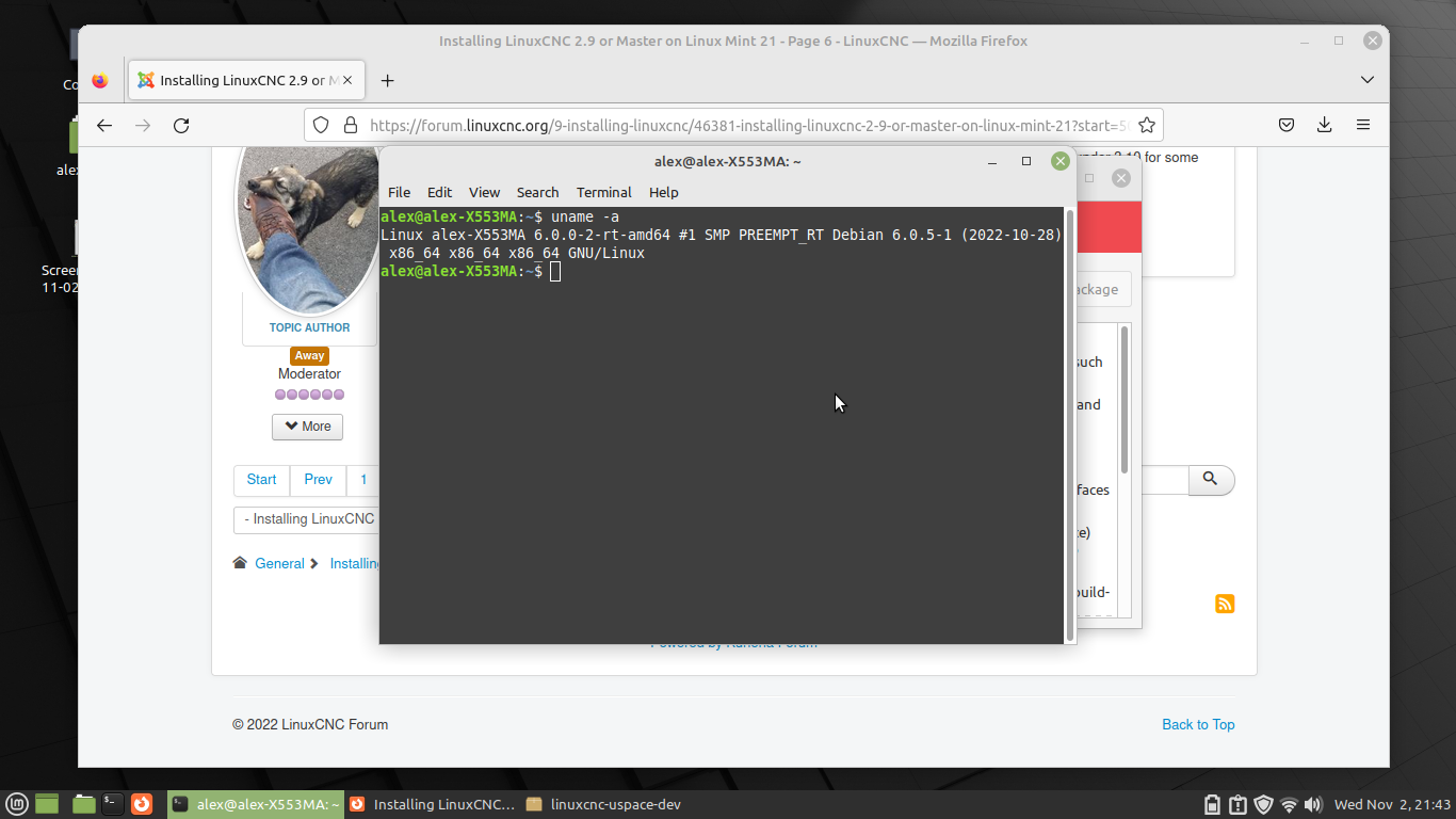

07 Nov 2022 20:01 #256160
by MarcoGaspar
Install worked...
But when trying to run linuxcnc it give error:
(I have the same config files running on other computer with linux mint 20.1 with 4.9.0-13-rt kernel)
Error report created by /usr/lib/tcltk/linuxcnc/show_errors.tcl:
Print file information:

Debug file information:
Note: Using POSIX realtime
initialize: module '/home/alex/linuxcnc/configs/MJG_CNC/python/toplevel.py' init failed:
File "/home/alex/linuxcnc/configs/MJG_CNC/python/toplevel.py", line 1, in <module>
import remap
File "/home/alex/linuxcnc/configs/MJG_CNC/./python/remap.py", line 1, in <module>
from stdglue import *
ImportError: bad magic number in 'stdglue': b'\x03\xf3\r\n'
Interp ctor: can't instantiate Python plugin
import remap
Python plugin configure() failed, status = -11
Python plugin required for prolog=, but not available: 108:REMAP = M6 modalgroup=6 prolog=change_prolog ngc=rack_change epilog=change_epilog
Python plugin required for epilog=, but not available: 108:REMAP = M6 modalgroup=6 prolog=change_prolog ngc=rack_change epilog=change_epilog
hm2/hm2_7i76e.0: error finishing read! iter=970

07 Nov 2022 22:27 #256168
This means that even if you manage to fix the remap issue, this will not work for controlling a machine.
There is a whole topic regarding the kernel issue here, if you do not mind giving us some info about the PC used and what type of network card it uses, also some tips to try and see if it improves things:
forum.linuxcnc.org/27-driver-boards/4691...error-finishing-read
Thank you.
Replied by tommylight on topic Installing LinuxCNC 2.9 or Master on Linux Mint 21
All those are errors related to remap/toolchange you have in one of your hal files, so not for this topic, much better to start a new topic if you intend to fix it, but, before you try that:initialize: module '/home/alex/linuxcnc/configs/MJG_CNC/python/toplevel.py' init failed:
import remap
import remap
This is the issue we are having with new RT kernels not playing nicely with the network cards and dropping connection to Mesa board.hm2/hm2_7i76e.0: error finishing read! iter=970
Thank you.
The following user(s) said Thank You: MarcoGaspar
