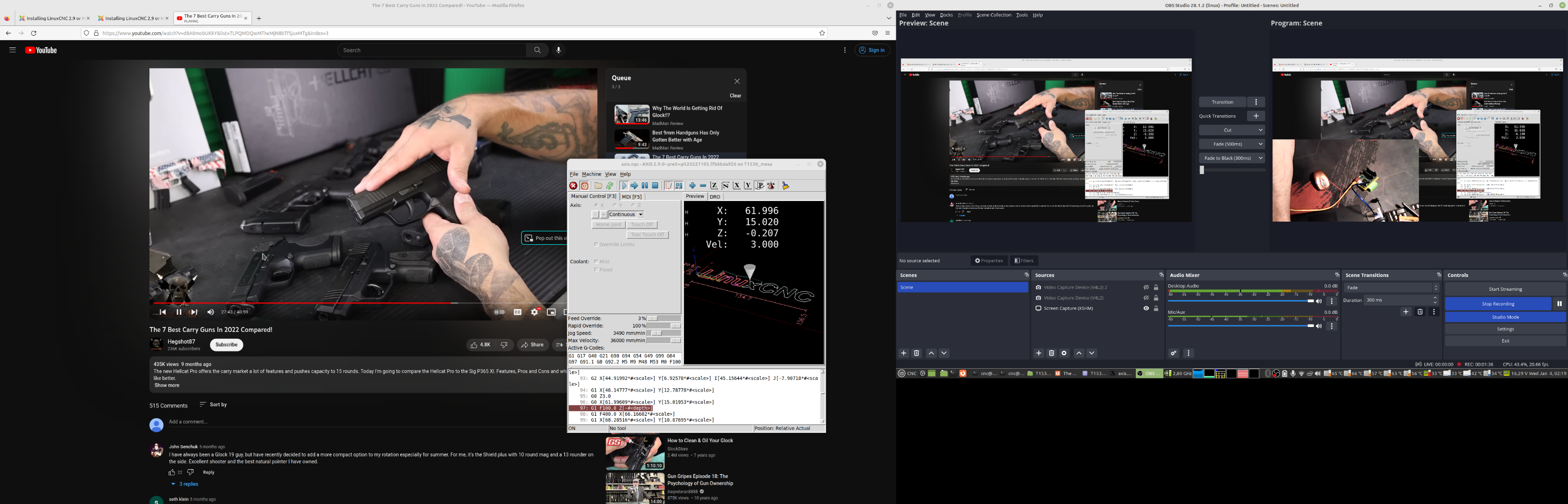

Last few days i have been testing a Lenovo IdeaPad Y700 with Linux Mint 21, RT kernel 6.0.0-6, that has a realtek network card, it just did a bit over 4 hours without dropping the link to Mesa 7i92.
Sure enough running youtube or OBS Studio with screengrab and two cameras will drop the link immediately.
If i get a chance i will install the drivers as per Rod's tutorial and do some more testing.

Been running for over an hour with no issues so far, using Rod's premade kernel, while watching youtube and recording with OBS Studio at 2560X1440 resolution.
Heads up, this is a laptop, so the processor has to be set in the "performance" mode by the CPU governor, otherwise there are latency errors, but the link remains OK.
