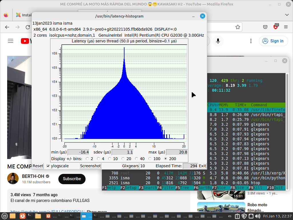

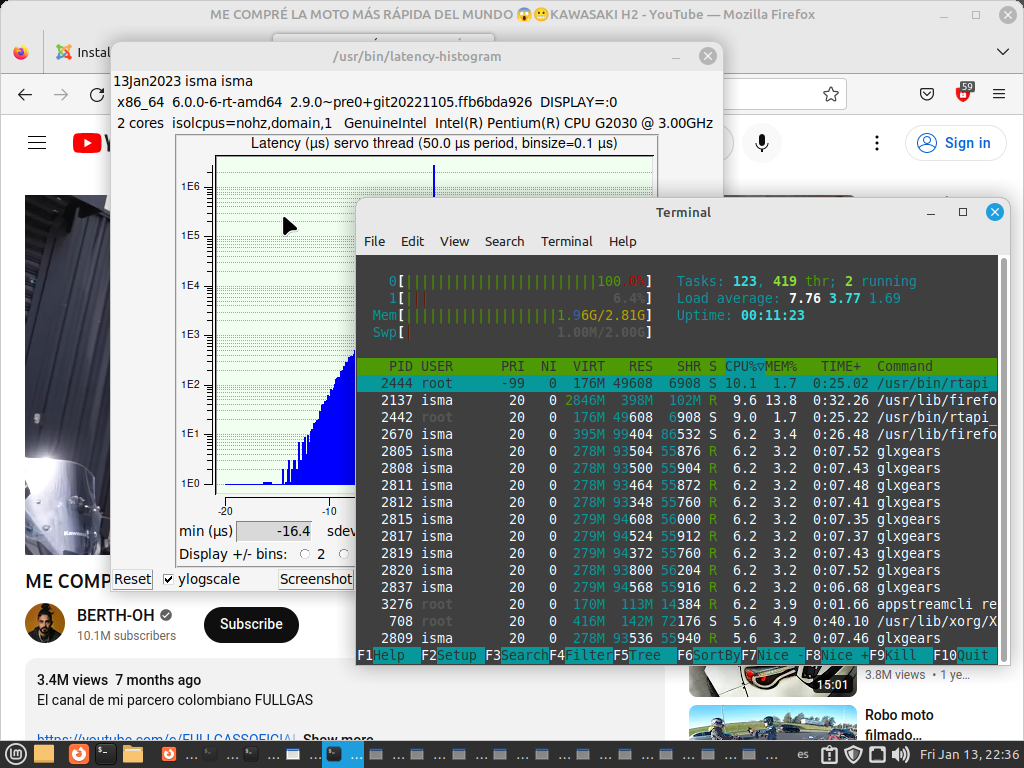

- Ismacr63
- Posts: 174
- Thank you received: 11
13 Jan 2023 13:25 #261821
by Ismacr63
Motheboard gygabyte ga h61m s2pv
Ram 4gb (shared with dedicated graphics)
The other information you can see in the screenshot.
The same thing happens to me with the debian booster with the RT kernel.
In booster with RTAI I have a latency of 10-15k at full
Replied by Ismacr63 on topic Installing LinuxCNC 2.9 or Master on Linux Mint 21
PC:Both. Especially grub parameters. And some screnshots from htop and watch cat /proc/interrups while making tests.

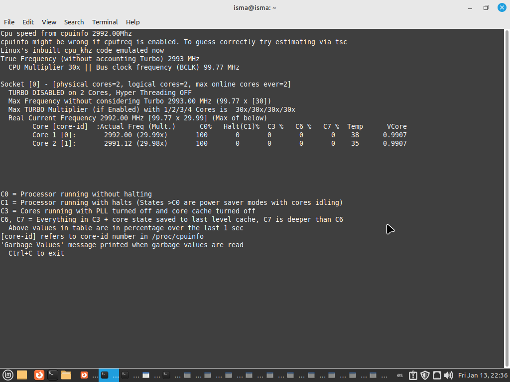

13 Jan 2023 14:03 #261826
by Stanislavz
Replied by Stanislavz on topic Installing LinuxCNC 2.9 or Master on Linux Mint 21
Ok. Change grub line to : nomodeset isolcpus=nohz,domain,1 apparmor=0
Install i7z and run it also. Run it first to note cpu frequency and voltage.
Use command latency-histogram --nobase --servo 50000
In htop - add cpu column and sort by it desc

- Ismacr63
- Posts: 174

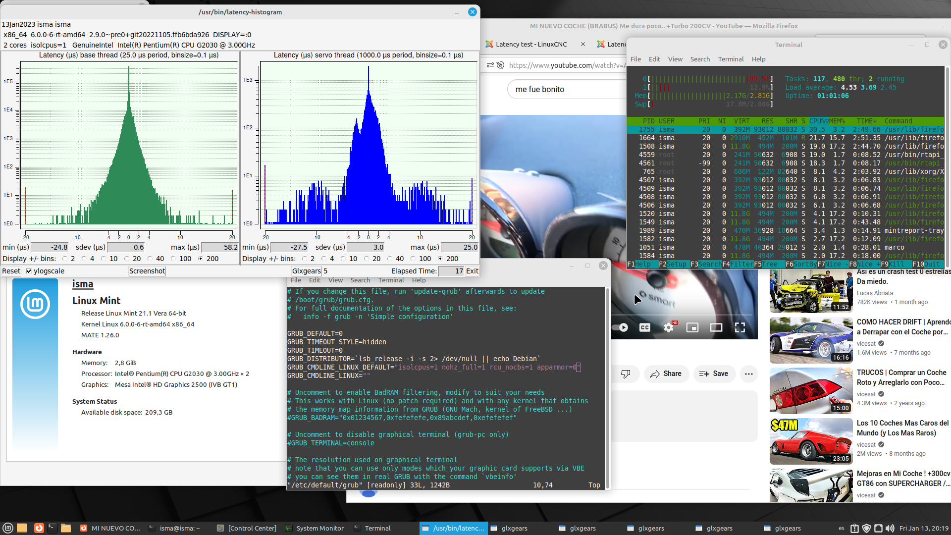

13 Jan 2023 15:41 #261833
by Ismacr63
The screen resolution has changed after changing grub and I can't change it.
I leave you here the captures.Ok. Change grub line to : nomodeset isolcpus=nohz,domain,1 apparmor=0
- Stanislavz
- Posts: 66
- Thank you received: 18
13 Jan 2023 16:05 #261834
by Stanislavz
Resolution is changed due to nomodeset command. You may try without it.
From graph - much of the noise have gone. Try to run also just latancy-histogram as usual.
And 10 glxgears is too much. 2 + youtube is ok. Pc have to loaded comfortably till 100, and with varying load. This would like to have 7 more time of cpu power to use.
