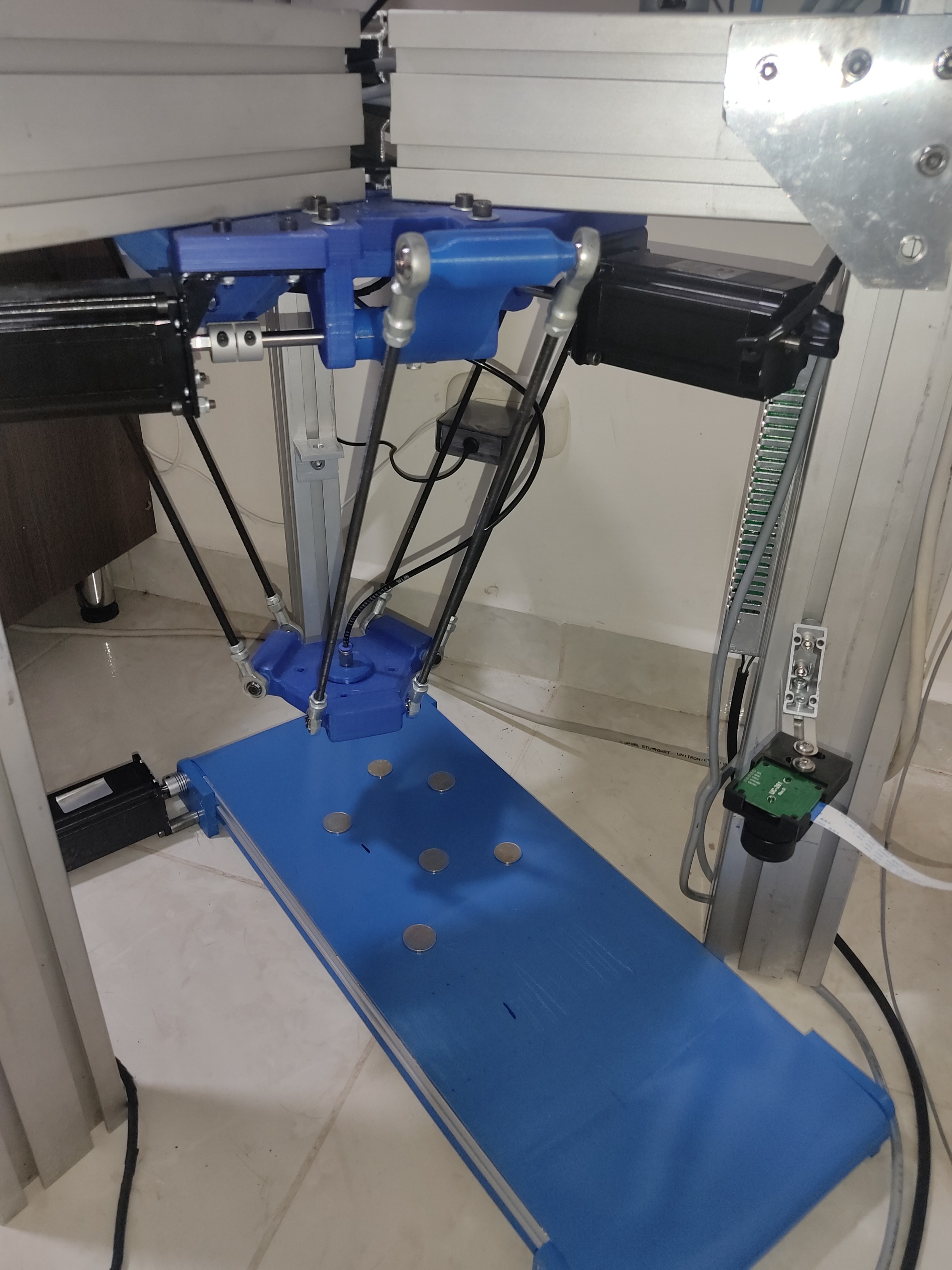

I have a rpi + picamera with opencv 4.5 to position and orientation measurement, the PC with LCNC control 4 stepper motor through paralell Port and every pulse output is a 20khz, now the set of position need be send to PC but I don't know how to do it.
Could You told me how stream position from rpi to PC using whatever comunication method.
The latency on LCNC on rpi increase when a use opencv to image processing and don't let me get 20khz, for this a use PC to control three robot axis and one axis to conveyor and after put adicional axis for a rotation gripper.

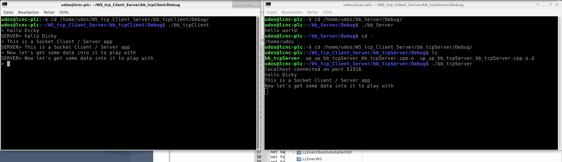

I was thinked to use ethercat to sending parts position from rpi to PC controller but as both are setup master ethercat i can not comunicate it.
Now i don't goint to use ethercat i goint to use tcp port of rpi and tcp port of PC with a client/server socket to send position of parts like udo sugested, but I don't know use a socket, could You help me with it, i great you.

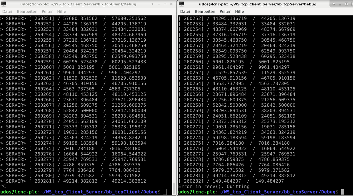

I did some basics today. So this is where you can start.
This is client /server socket setup. I will test tomorrow with some data.
Best Regards udo
Best Regards udo

Well , that is what it looks now.

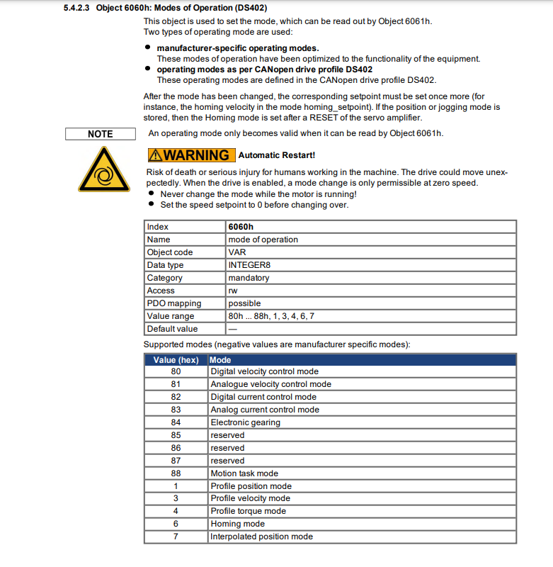

hello guys,
Is here any possible way to run these next drivers -
Kollmorgen S300/S700
Danaher S300/S700
Telemecanique(Schneider electric) LXM 15, etc..
Kollmorgen S400/S600
Danaher S400/S600
Beckhoff AX2000, AX2003, etc...
Telemecanique(Schneider electric) MHDA, etc..
under ethercat please? I found NO possibility to turn it on to CSP mode. There is just supported next modes :
0x6060 register and values
hex name
80 Digital velocity control mode
81 Analogue velocity control mode
82 Digital current control mode
83 Analog current control mode
84 Electronic gearing
85 reserved
86 reserved
87 reserved
88 Motion task mode
1 Profile position mode
3 Profile velocity mode
4 Profile torque mode
Homing mode
7 Interpolated position mode
thanks Slav

Hello,
you can use any of these drives.
the simplest and fastest way would be to use them in Velocity control mode with the position pid implemented in linuxcnc.
with a little bit of research, interpolated position mode should behave similar to csp mode.

Hi foxington: Please have a look here in particular chapter 8.5 Cyclic sync pos mode.
CiA directive goes for all communication protocols. Also for ether-CAT's.
www.ethernet-powerlink.org/fileadmin/use...EPSG_V_0_0_2__1_.pdf
