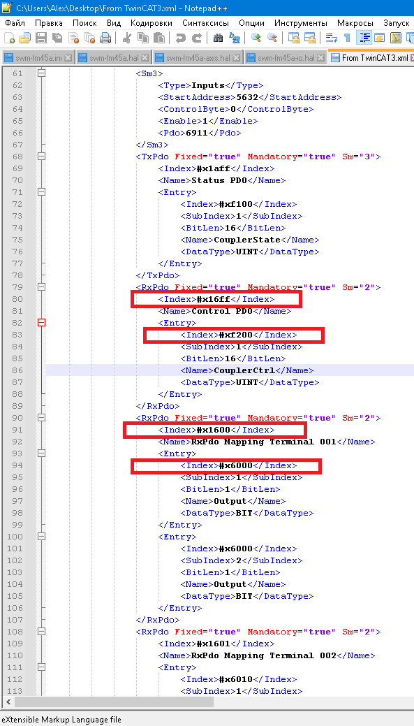

typos,
you need to add an / at your pdo entry lines.
<pdoEntry idx="6000" subIdx="1" bitlen="1" halType="bit">
should be:
<pdoEntry idx="6000" subIdx="1" bitlen="1" halType="bit" />
should be:

17 Oct 2021 15:52 #223395
by ASKoskov
Replied by ASKoskov on topic Ethercat HAL driver
Thank you fixed it, the error remained refers to line 20.

Replied by db1981 on topic Ethercat HAL driver
hal pin names are missing.
<pdoEntry idx="6000" subIdx="1" bitlen="1" halType="bit"/>
<pdoEntry idx="6000" subIdx="1" bitlen="1" halPin="inputxx" halType="bit"/>

Replied by rollfree on topic Ethercat HAL driver
If you are not interested in the content, then it should not even have a halType.
For example:
<pdoEntry idx="6000" subIdx="1" bitlen="1"/>
For example:

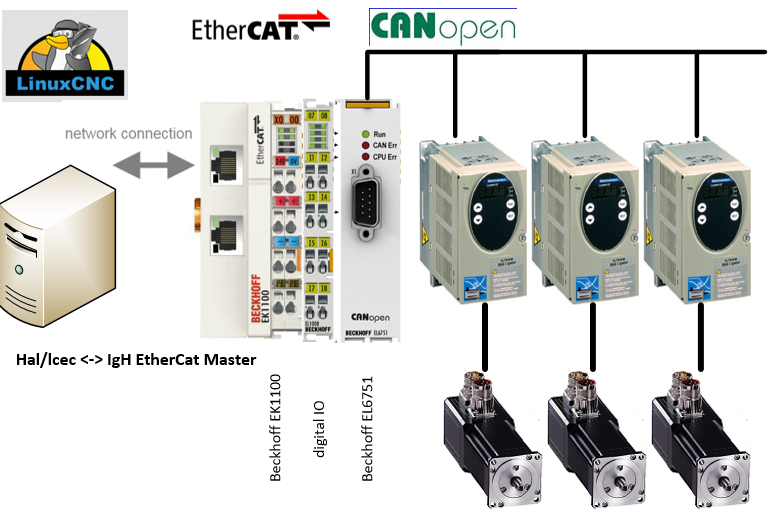

by Sviper
can you share your Twincat Projekt for the config of the EL6751 and drives?
Replied by Sviper on topic Ethercat HAL driver
Hello cgc,Hello,
here the files for a 3 axis system
Frank

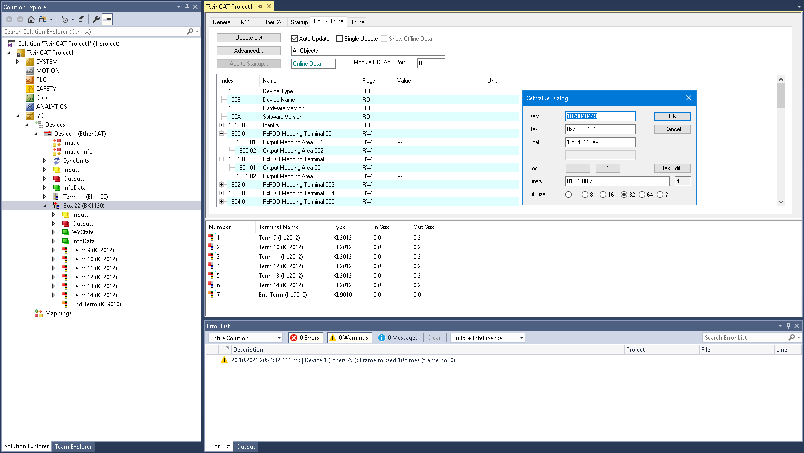

- ASKoskov
- Posts: 4
20 Oct 2021 16:04 #223681
by ASKoskov
Now Linuxcnc is running, but the module does not respond when the signal changes. Where did I go wrong? In hal meter lcec.0.BK1120.Out_220_01, the value changes.
Hello,
what do you mean with "In hal meter lcec.0.BK1120.Out_220_01, the value changes" ?
Does the slave reach ethercat op state?
